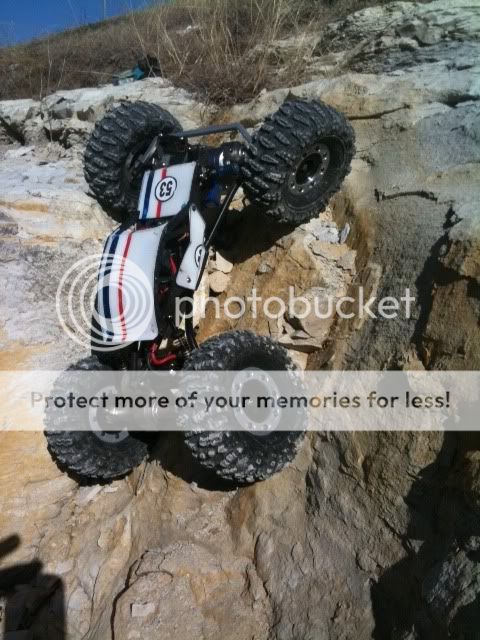

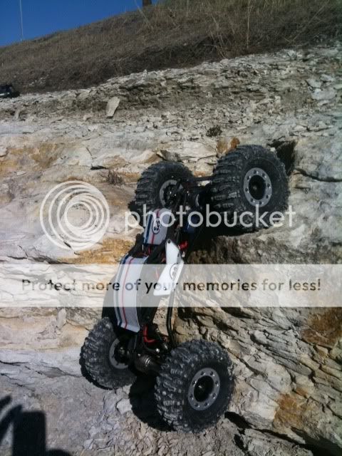

Got some action shots. Sort of. I popped a rear lockout screw loose so I went back to where I was and put my truck where it was.

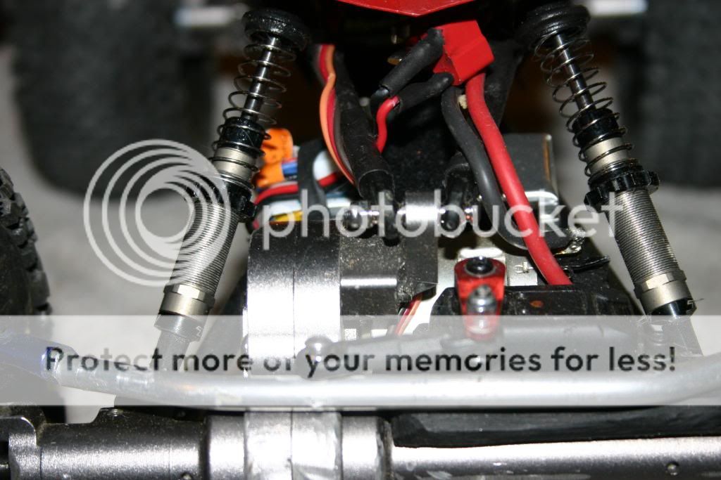

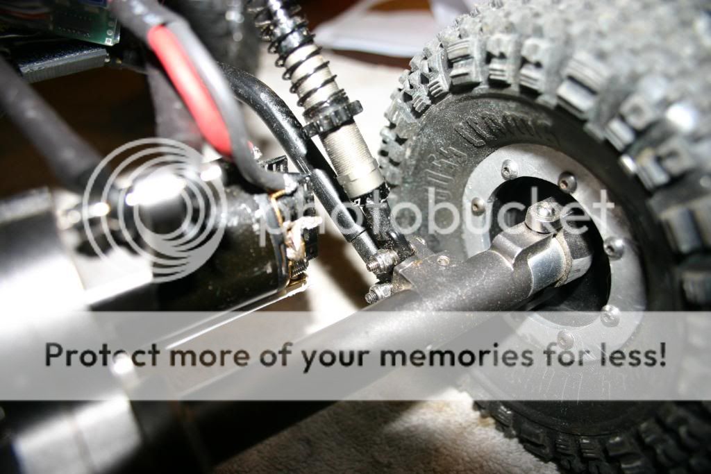

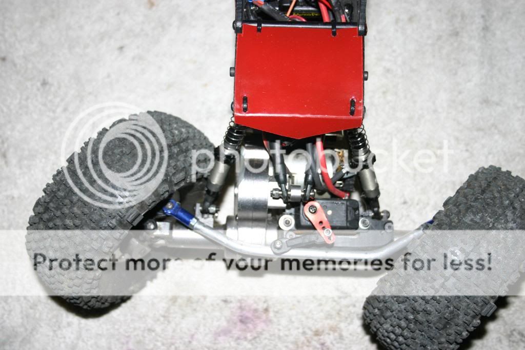

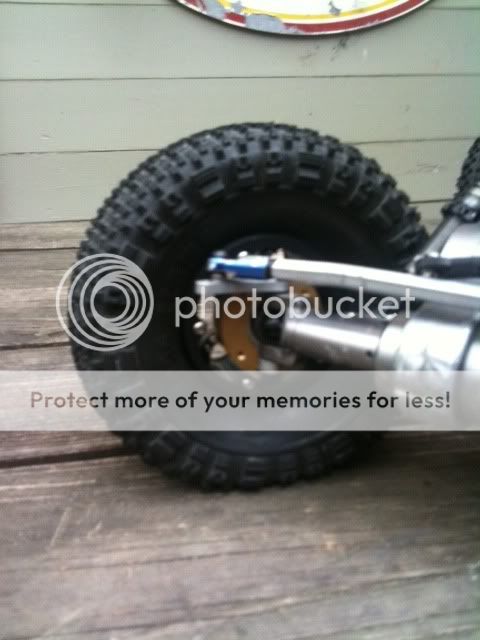

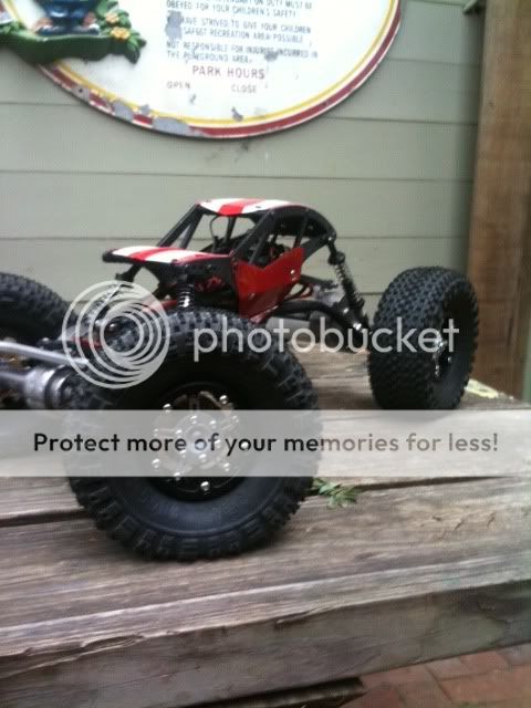

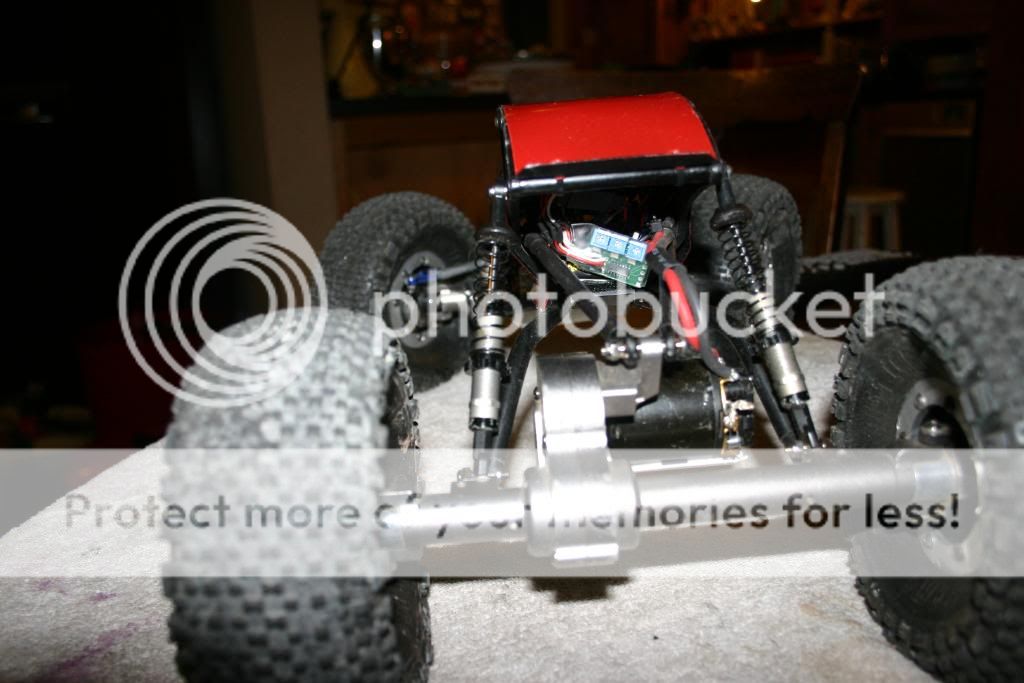

So I have done some work on the rig. Actually a lot of work. I put on 300's. I switched to two mamba micros and a Wantasummit adapter. I did some work on the shocks and location and finally did some tweeking on the front end of the rig. I am missing a local comp torrow so why not post some pics right!
More knuckle weight mods.
Steering throw.
Front angles.
Farther back.
Rear shot.
Shock cap mod. I purchased these shocks for this rig recently but they were binding up. I noticed it looked like it was the cap not fastening well so I did some work.
The last thing I did was create a plate for my for my battery behind my tranny out of delrin sheet. I did not take pics though.
