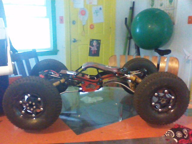

Question on wheel base though. I've got mine sitting on 315mm now, centre of axle shaft to centre of axle shaft. But it still looks really short to me. Compared to all the photos and vids i've been looking at and watching. But according to the CANZ rules i've been adhering to the max is 317mm. Is it just my eyesight, funky camera angles and what not, or is there something i'm missing here? Just i have seen a number of rigs that would appear to have the wheels a lot further apart.
You got me looking at mine!!! And I must thank you because I know realize one of my front lower links was shorter than the other. I'm sitting right at 317mm but I run a smaller diameter tire. here's a pic
