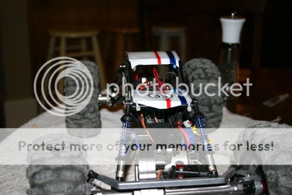

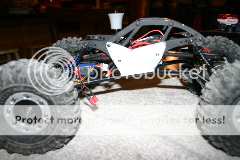

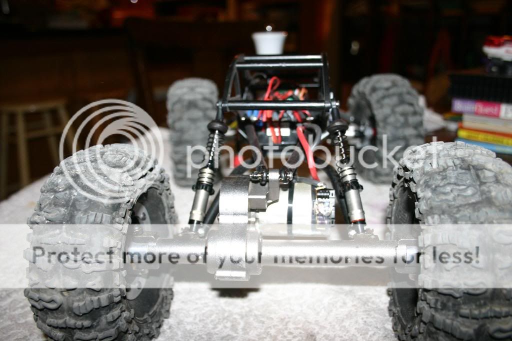

I purchased a lot of this from a great member here on the forum and went to work getting into the MOA game. Tips and tuning coments desired, no wanted, no needed.
Info first
BJv3 Chassis
Home made delrin lowers
Traxxas pushrod uppers
Berg v1 axles
Brood motors 35t
Sidewinder
Punk Dig
CC BEC
Spektrum RC in shrinkwrap
Eretex Wheels
Proline powerstroke SCX10 shocks
Sedona/Rovers CI DD foams
Savox servo 86'd on the axle.
Please let me know what you all think of my build so far. What do I need to do to tweek and tune it?
Looks like a great start"thumbsup" With those Br00d motors i would get a hard 3rd gear and some 300's. "thumbsup"

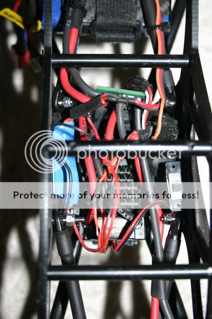

3. Wantasummit's two esc adapter
4. Two Mamba Micros (?) if they will work on an moa.

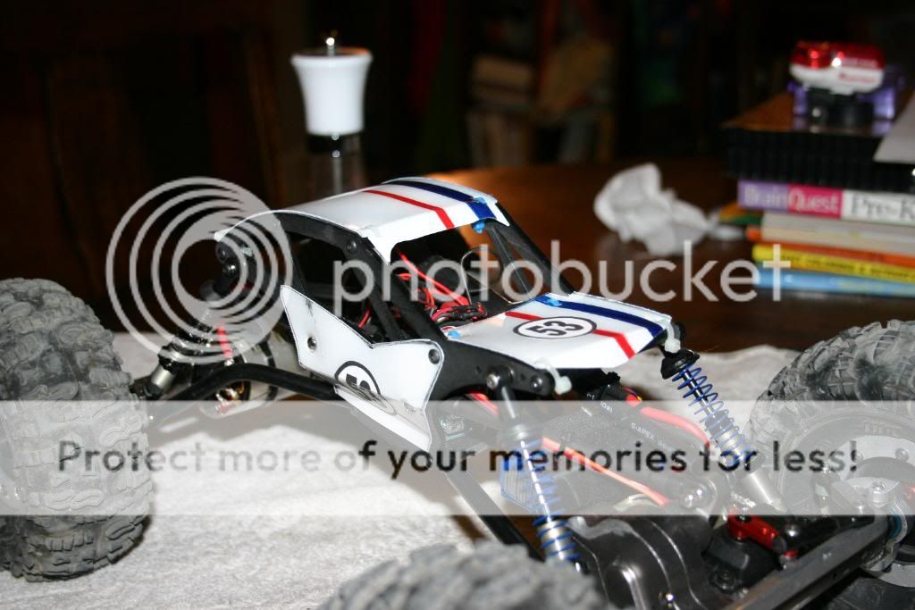

lookin sweet ... the herby color scheme is rockin ....
ive been running mamba micros on my bjv3 xr-10 without problems for 4-5 months now .... they barely get warm even
Strawb. That is awesome info. I have been wondering if this was going to be an issue. Also the Herbie theme is really more to impress my kids. I certainly liked the movie but my 4 year old and 6 year old watch it all the time. It was either go with a Lightnin McQueen or Herbie and I simply liked the herbie idea.
It appears to me that the BJv3 is really almost a plug and play style of chassis with the berg axles. Coming from a stock ax10 to a fb ax10 I am used to having to do massive mods to get performance out of it. I was looking for ways to enhance performance from my rig and came to a couple of conclusions. The rig starts from a more advanced starting point thus mods are "built in" if you will. The only improvement setup wise I can see is playing with the upper link placement, and inboarding the shocks up front (which as of now is next to impossible due to the axle. Any thoughts on what I am missing. My upper link mounts by the way are mounted at the screw holes holding on my side plates.
looks good rick i run a juice as well without the cab an i run a lil diff set up 2 holes in on the rear shocks an3 in in the front the uper links in the rear or above the bend in the chasis an below the bend in the front an im really happy with this setup im going to try an space out my links an the axles to see how it works for i see alot of guys doing this

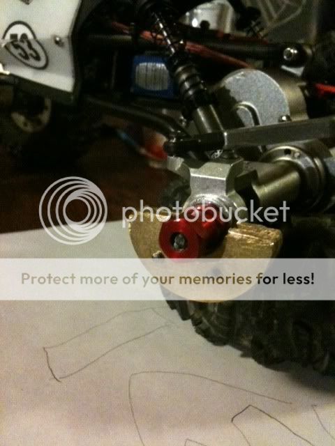

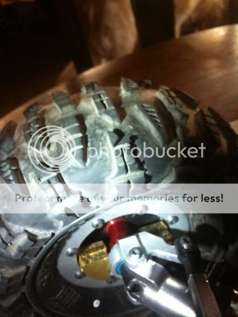

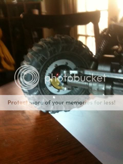

Alright. This is what the night held for me last night. Did a knuckle weight mod that was surprisingly really simple and helped me take about 2 oz out of each front wheel. I was surprised at how much that turned out to be. I think with a harder metal I would have worked harder but gotten more out of each wheel. These pics are mounted and the clearance tight but it works.
Correct me if I am wrong in my thinking here but to remove wheel weight will increase wheel speed, and by dropping the weight to the lowest point of the axle should require less weight overall to accomplish the same goal right???

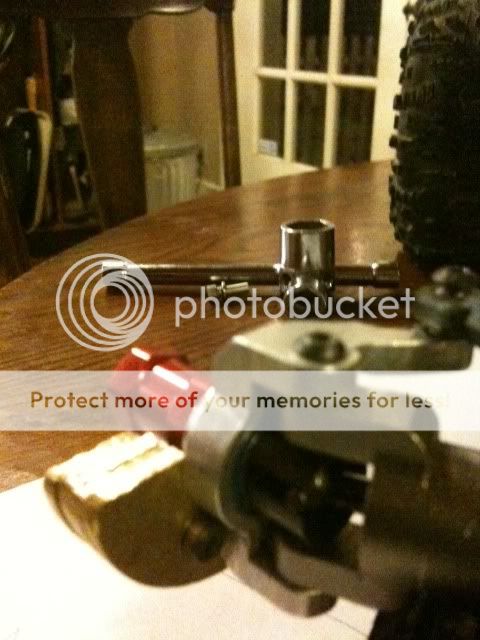

They are brass. I took the knuckle off and tapped a 3 mill hole in the lower side of the knuckle. I then took the inside plate and recessed a hole to put the 3 mill through. After that I took the outside holes and drilled them for a 3 mill to slide not thread through. I then took the 4th and final (at this time) plate and tapped the holes for both the "holding" screws. My wheel setup really was good for this to begin with. I am running an eritex wheel with a recessed backside. I am also running the wideners from Junfac. I had plenty of room to work inside here. The washers are brass washers that I had to pick up from a specialty store. I purchased a drill press from Harbour a while ago and none of this would lay out near as well without that.

Here is what I did. For description sake lets call plate one the plate closest to and mounted to the knuckle and plate 4 the outermost plate. Plate one has three holes drilled. I held them both together under my drill press and mocked them up to the same spot. With them now alligned I took plate one off and recessed a spot for a recessed 3 mill screw to go into. I then took all 4 plates off and clamped them down together and drilled the outside holes in them. After that I took plates 1-3 and enlarged the holes to make them just so big as to allow a 3 mill screw to slide through. I then took plate 4 and tapped the outside holes to be able to thread the 3 mill screws through to hold the entire assembly together. After this i mounted plate one by itself with the recessed screw into the knuckle. I then inserted the outside 3 mill screws and slid plates 2 and 3 into place. Then I tightened plate 4 in place and everything was clamped into place. I did take my dremal to the assembly to make certain my brass plates/washers would not hit anything on the inside next to the axle and on the outer rim surface as well. Hope this helps.
