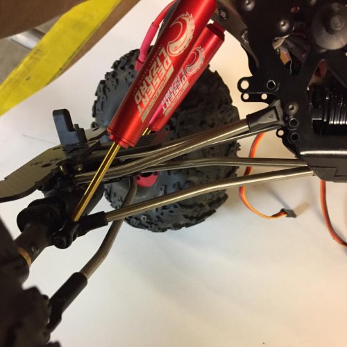

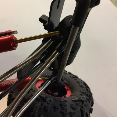

Got my tie rods from vanquish this morning . Boy are they nice, I am keeping it simple I went with 105mm top and 120mm bottom . The only reason I went with this lengths is that it’s the closest I could get to the factory length , basically they are a few mm longer but equal . And then I’m only doing a single high clearance bend in the lowers that’s it .

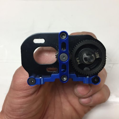

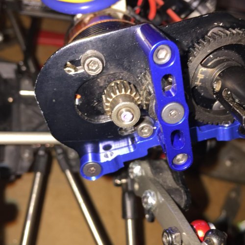

I figured out where I’ve been having my problem with the length of the lower links and I know several others have done the same thing. The little link brackets that go on the skid plate can be reversed easily we’ll in doing so , it will lengthen your lower links by the length of the bracket. I put my rods in and my drive shaft wouldn’t even touch the output on the trany. Easy fix after I racked my brains for about 30 min lol. The only reason I figured it out was the pinion angle was pointing damn near at the ground! So just something for ya’ll to check or realize when doing track rods.
The first picture is the right way
The second picture is the wrong way but you can use it this way if you make your own rods. How do I know, I did it lol.
The the other two pics are my new rods installed on the back . Man I think they look Awsome and we’re the same price as stainless.

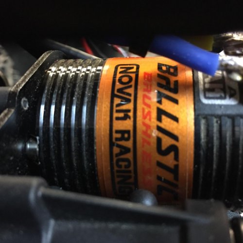

Servo installed , goat3 esc installed , ballistic 18.5 turn motor installed, krazed builds battery servo relocator installed , vanquish products 120 mm lower and 105 upper titanium links installed. All that’s left to do is shorten some wires get them routed and install the receiver . I’m finally at the home stretch of where I want it to be . Other than tuning the esc, the pinions and remaking my steering arms ,I’m ready to rock n roll. Ide say another week maybe two

I didn’t take pics yet but I had to put a small bend in my front upper links. I didn’t like the pinion angle so I put about a 15deg bend down just behind the krazed plate. It got my pinion looking better and looks pretty cool to boot. I’ll take a couple pics later

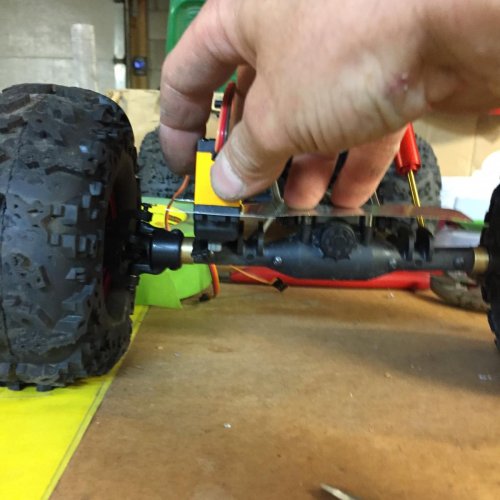

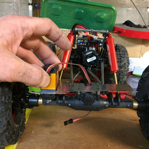

So I’ve been looking at this servo and battery and I come to realize that I don’t like how the servo lays on its side, so I think ima try this. Let me know what you think!. I ordered 1/8” aluminum plate to try it.

Interesting...

There probably isn’t going to be any major benefit to doing it but I really don’t like how the servo takes up the whole plate. About the only thing it would benefit would be the alignment of the servo arm and the knuckles. So it’s purly for me type of thing lol. I guess I like being different in some ways. We will see I guess in a few days when the plate shows up
it does look like it would give you more space for your battery and any additional weights if you can get it mounted / set up.
One drawback I see is your servo shaft and horn are going to be pretty exposed to rocks. JMO ;-)
Ernie
That’s what I was thinking . With it on its side I have to get batteries that fit, with it this way I could use any mini battery.
Ernie
I thought that too ,but when it’s on it’s side it is the first thing sticking out the front. With it on its end it looks like the plate would be. Really I don’t like the servo on the axle I think it’s stupid ,but until the design rack and pinion we are screwed.

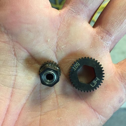

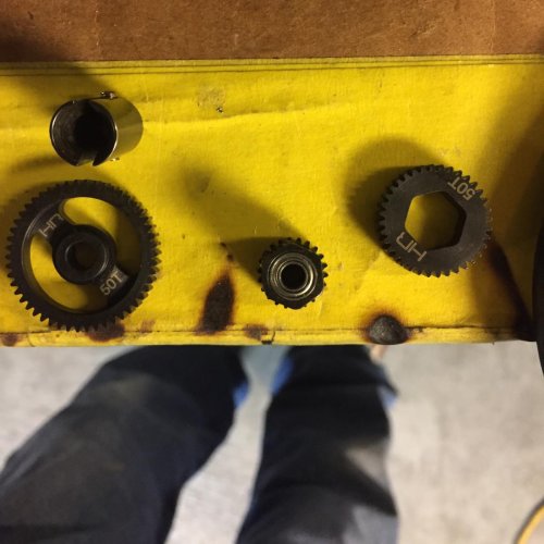

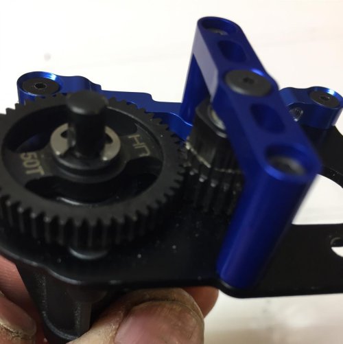

Everything showed up this morning. I got the HR trany gears,yes dentonmac the center gear just presses together . So I pulled the big gear off the top of the little gear for the mod . I got a 18 tooth TLR hardened aluminum pinion and installed that to start off,( I got a 16t tlr coming.). I got the HR aluminum front trany mount and the HR trany gear brace and got them installed. I got 2 sets of TRX-4 ss turnbuckles and track rods for spare parts . Last but not least I got my 6061-T6511 1/8”x 4”x8” extruded plate. As you will see I got the rig down and back up . Now it is time to make my front plate . I’m going to try a couple different ways to see what works best for my liking. I’ll keep you posted on how things go. Oh I almost forgot (well I did forget but remembered when I was looking through my pics) I had to slot the motor mount screw holes to accommodate the smaller pinion. It’s an easy fix, I just chucked a 3mm bit in my drill and used it like a mill bit and pressed it against the side to be lengthened and shaved off a couple thousandths . Its not perfect but it worked for me!

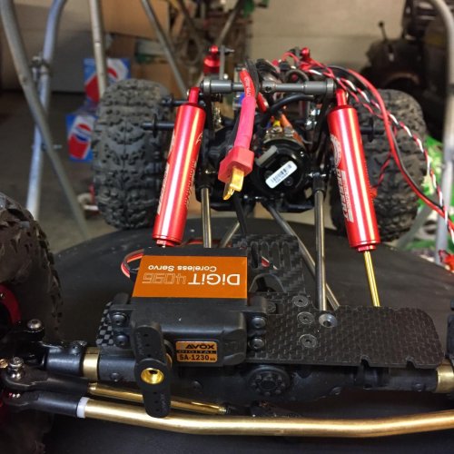

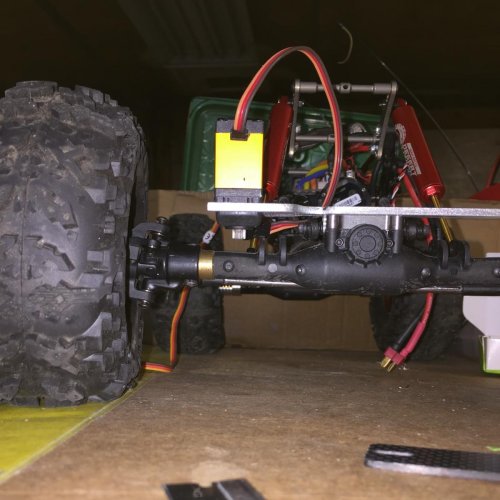

Well I got the plate roughed in and mounted . Now what do you guys think?

It seems like it’s pretty stiff. It don’t have a bunch of flex to it. And as far as I can tell so far i don’t have any clearance problems. I mean it is r and d the hard way lol. I really seems like it’s going to help the steering angle too, it’s pretty close to parallel with the pitman arm on the knuckle/knuckles . And it really opened up room for bigger batteries, more weight and looks better I think? Let me know you opinions or you thoughts on pros and cons PLEASE !! Oh I’m also ordering carbon fiber to make it out of too.
Keep it up. It’s awesome seeing what your doing. Nothing like some homemade engineering
I finished it up last night , my phone was dead so I’ll get you pics later today.
Looking good, the servo shaft is set up a little higher now than when you showed your mock up. Hope it works great for you! "thumbsup"
