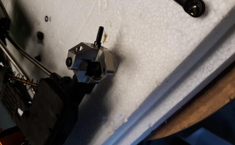

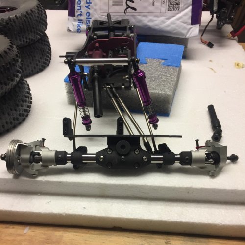

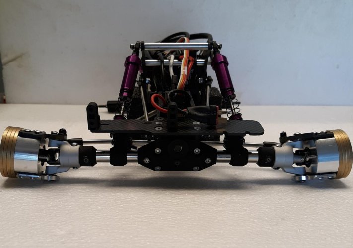

Got a few things in the mail yesterday . Got my axle housing from Anthony, I’m for sure getting the rear axle housing too bud this thing is sick , I like it. Then got a bunch of mics. stuff for the comp crawler trany gears and outputs and stuff. Here’s a pic of the housing mocked up. Have a great independents day all

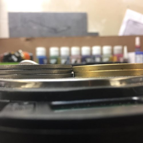

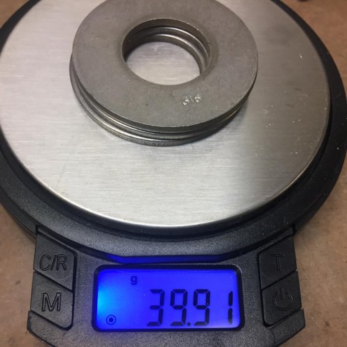

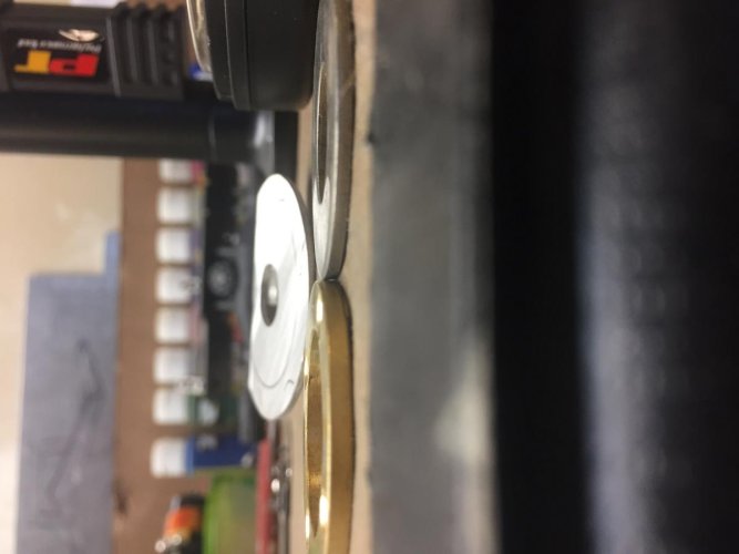

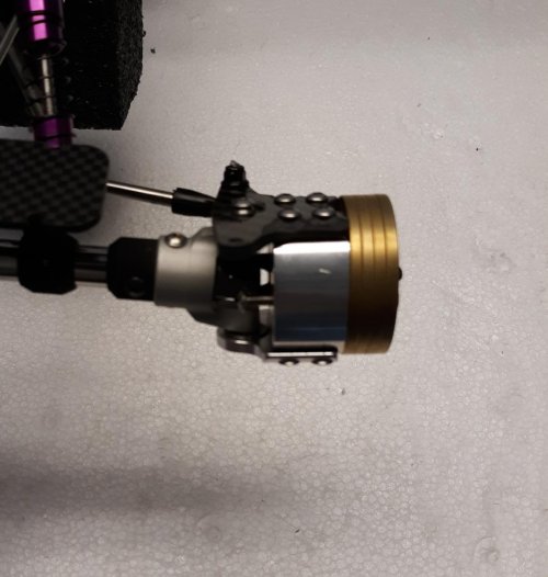

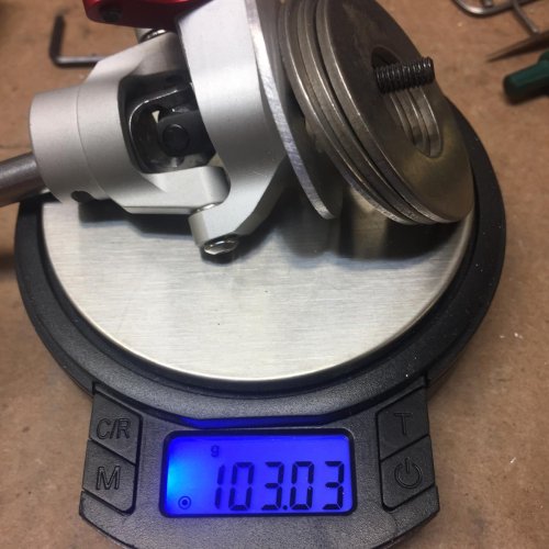

Ok dummy question but I bought some brass rings from Dlux and started to make hangers for the vp knuckles . Well I was looking through my ss washers for a big one to start the design , then I found a washer that was about the same diameter as my brass rings but they were heavier then the brass ones so I scaled them and yes they are. Also they are thinner . So my thinking is drill and use the ss ones instead of buying a bunch of the brass ones . What do you think?, my thought is that I would be able to put more weight in less space then the brass ones ? Right? And I would only need the three holes instead of four even better

That’s what I thought , that and they are just hardware store ss washers so to add more it’s a simple stop at Lowe’s or homdepot to get more.
I scaled 3 because 3 is the same thinckness as 2 of the brass few pix to post. Just need to drill holes in everything lol.

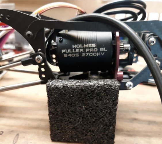

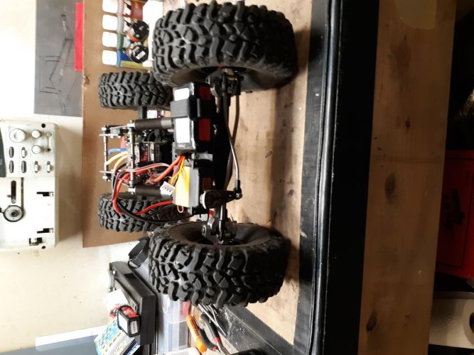

Thanx I ordered my motor and speed control a set of Dlux knuckles and a few other things this weekend. She is getting really close, down to a few things left to do like, servo rx/tx and get some nylon bolts for body mounts . Think that’s all . Close really close!

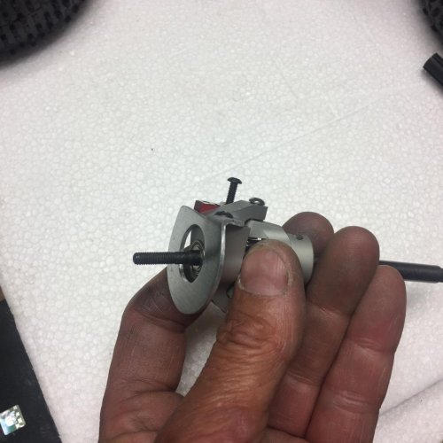

I bought the stainless steel chubs and knuckles from super shaftys for the comp crawler . Man those things took some work to make them fit. Im not saying they are shit but they definitely arnt a bolt on item . I probably got an hour or so in each side. But they do look good !
I had the same issue. I got the stainless right when they came out and figured maybe the set I got was just an early set that wasn’t perfect. I had to file and get them to fit, not bind and retap the set screw hole. For the price I wasn’t happy but the weight was worth the effort.
Ya with the pins in the chubs hit the knuckles .then once i got them to fit the spacing was off once they were installed. I had to file the stops off the axle at the spool . Oh and had to re size the pin holes. , was a pain in the ass but yea they are heavy. Im going to make some titanium King Pins for mine today i think. . Who knows lol its sunday. I may just lay around and lick my nutz! Lol
