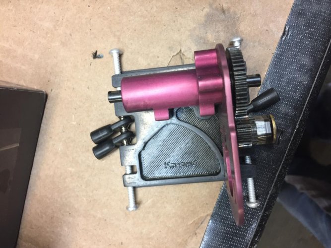

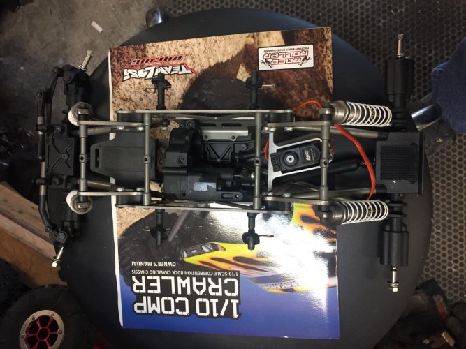

Added Acer ceramic bearings to the trany and started the assembly. I still have a few parts to get anodized but it’s a start

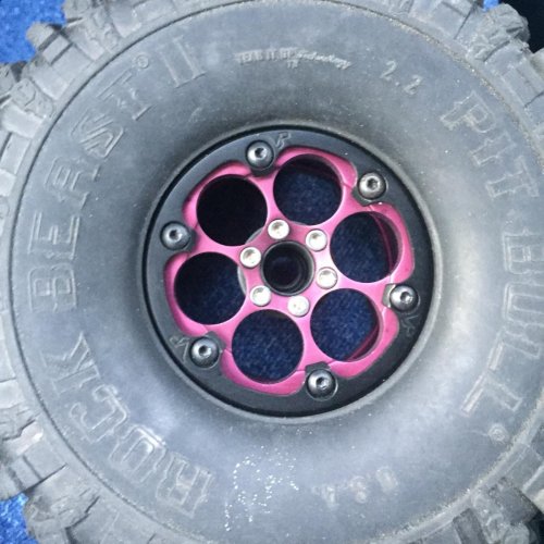

Got the wheels all together need to buy some more black screws but lookin good

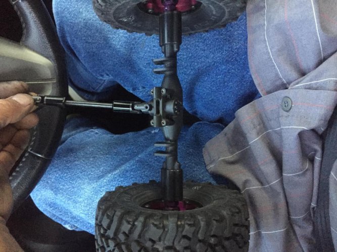

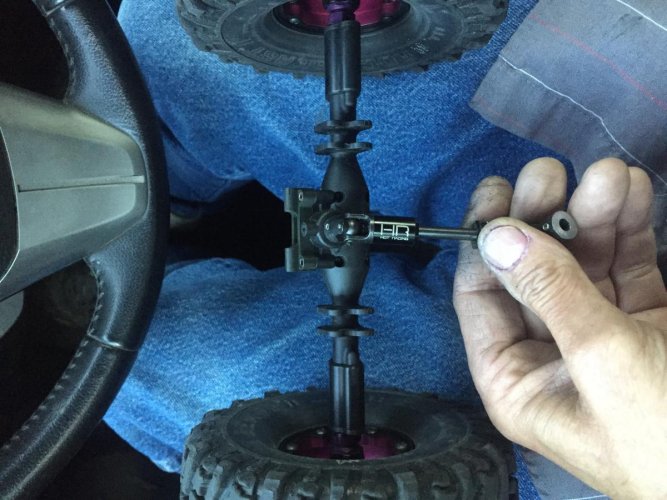

New toy showed up yesterday!! This thing is brandy friggin new . It was built and sat on a shelf . There isn’t any scratches on the bottom so I’m Keeping it mostly stock other than simple stuff like links wheels tires. I’ve already swapped one axle with my unstuck to have them both with a overdriven front . Also swapped my titanium links off my night crawler and swapped the center shafts and put the hot racing ones on this one. Probably one of the bigger upgrades is gonna be the krazed builds axle plate , got to have that .That’s about it for now . Oh how I love to tinker with these things. As for the unstuck it’s kindof on hold for a bit until I get a couple things from eBay and my Dlux /Dravetech shocks and I had Erik make me a set of his 7mm shafts into a set of losi/axial xr hybrid shafts so now I’ won’t ever have to worry about breaking the ss spacers off the axial shaft. Thank you Erik sorry again if I confused you .

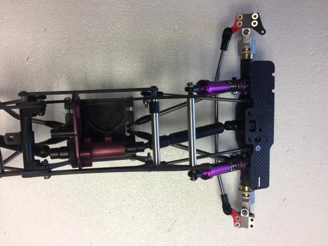

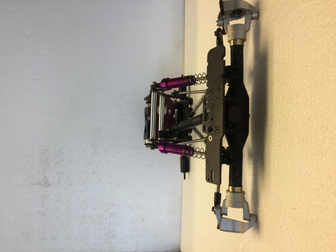

Working on assembly last couple days now . I got everything in the mail this morning. New VP chubs silver New VP knuckles silver. LNC motor plate,trany shaft set and TLR shock oil kit 25-45 wt. and my Dravetech shocks from Dlux. I have it pretty much built minus electronics all( going with HH brushless stubby) I think and a torquemaster not 100% on that yet I may get a puller pro 500 . Just haven’t decided yet. And I need to assemble the shocks lol. Little bad news on them I was getting stuff ready to build them and got sidetracked, had to run for a new die 6-32 . When I got back I’m missing one of the light springs. I tore the place apart looking and could not find it. So I think I’m going to run my small springs on the inside of them. I’m not waiting for another spring to build these. Oh and the rear uppers are closer to 113 not 125 like rob said in his thread. No biggie really . Just had to get a new tap. That’s about all for now . Have a good weekend all.

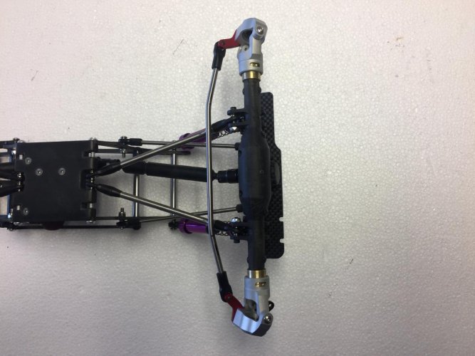

With the help of something Rob from Krazed said I finally figured out how to tap my ti. links . That being said I had to as said b4 I had to shorten my rear upper links looks like I’ll have to do the front as well just a few mm . And I had to make a new steering shaft my old vanquish rod was too short now with the new chubs and knuckles. So I measured it out using my old one and made a new one out of 2.5mm ti rod and for threads I used a 10-24 die. Works pretty good. So here’s a few shots
Do I recognize those axles Razz? "thumbsup"
Ernie
Ernie
Yes sir Ernie it’s the same kit that I got from you last year. Dlux is building me some custom shafts as I’m typing this. I should have this a roller by the end of the week or the weekend. I see now the I have the rear springs on the front. And I need to buy another set from Dlux or run pink ones from EBay . Because I lost one of the soft springs . Really sux because I’ve been trying to be neat and tidy while building this and my ccr. I have no idea where it went . Oh well.

Thank you. Yea I try not to throw stuff away until I’m done with whatever Im working on. Bet that that don’t happen again lol! Only issue with it right now is at full travel on the rear it binds the center shaft yolk. Easy fix but sux taking shocks apart . I shortened the top link ends on them and put a 1/4 fuel line stopper inside looks like I’ll need to add a 1/16 or 1/8 to the fuel line .no problems on the front yet. But I still need parts. I bought the VP knuckles and I don’t like them . So I’m buying Dlux this week . That and he still hasn’t sent me the shafts yet. Then its electronics time. "thumbsup"
