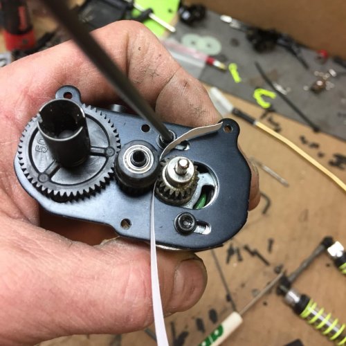

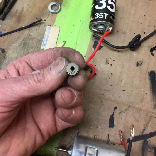

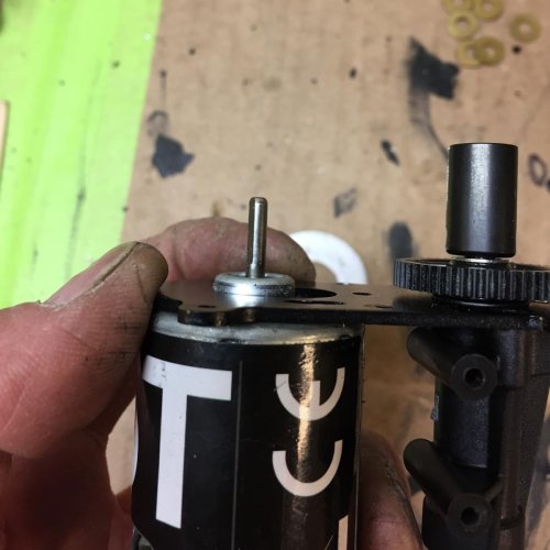

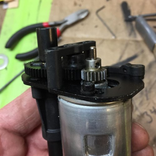

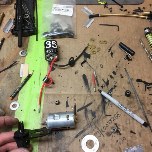

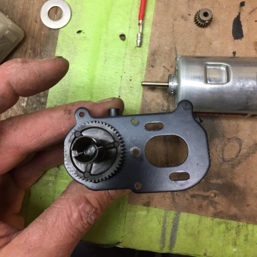

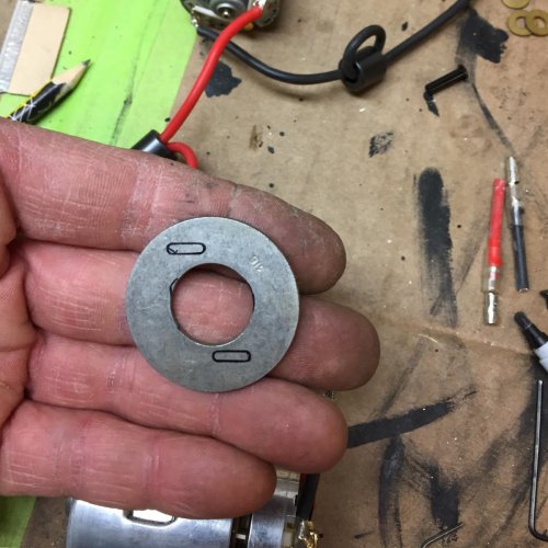

Ok so I’ll call this chapter 2 , after doing some reading and some asking I decided to do the LNC trany mod. The mod is easy except for one small detail that is probably not thought of,. So here we go , I got home from work tonight and wanted to rip into this and get it done ASAP like an hour or so. Well not gonna happen. The problem being I still have the stock brushed motor and the only other motor that I have is also brushed which isn’t a bad thing ,right ? Right! I get the trany assembly out tear it down and hack hack hack grind file file, goes the center gear. “Sweet “ I think this is going to be fast and I’ll be back on the ground in no time flat. So I start assembling the trany( I put ceramic bearing in the output shaft) all goes together great until I put the motor in and what the *^#% the top of the can hits the center gear, so now until I can afford to upgrade my motor and esc I have to build a shim to keep the top of the motor from hitting my center gear . Just my luck I can’t ever have anything go easy for me ! Pictures to follow coming soon

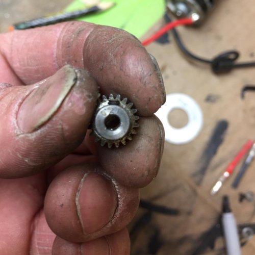

Stock is 20t pinion and I have an old losi 21 . I may use the 21 if I don’t go nuts first, just trying to get more wheel speed with the junk I have.

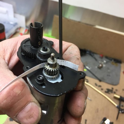

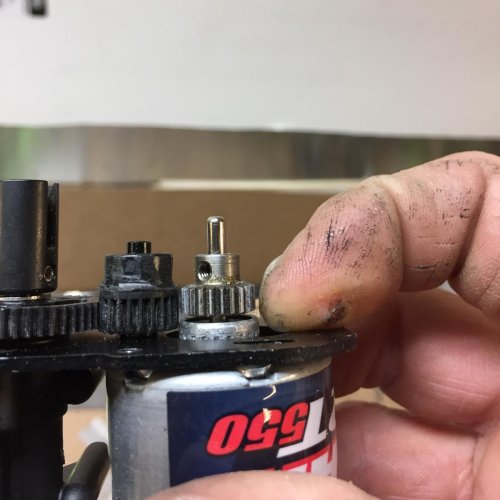

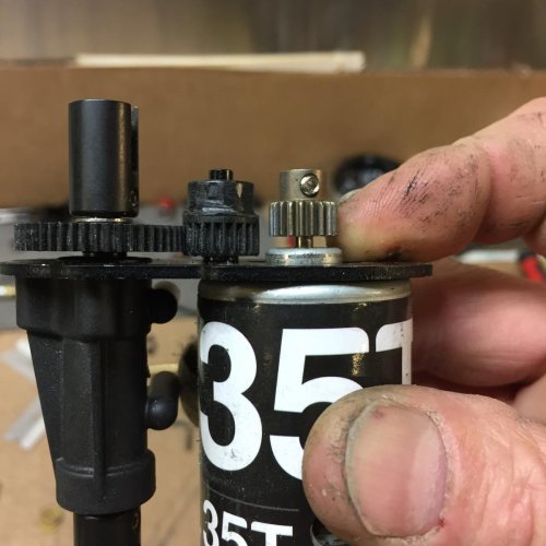

One thing I remember from back in the day is when setting your pinion use a piece of paper like this if if just marks the paper too loose ,if it accordions it it’s , good, if it shreds it too tight

Ok here it is a 30 min job into a 3 hour job!

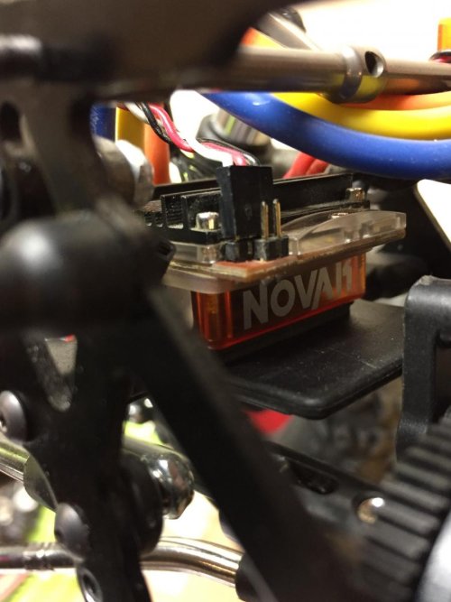

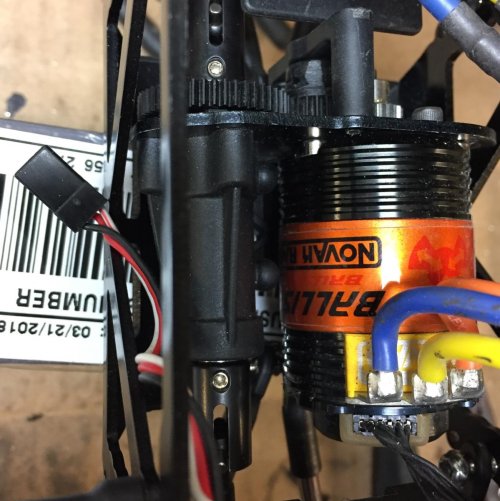

Have you every bought something and forgot you bought it well I just did. I forgot that I bought a Novak setup so here’s a couple pics
Well it’s a club spec esc so I’ll put that in my xx-t and get /find a goat esc

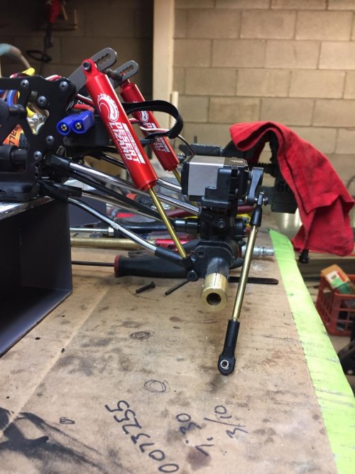

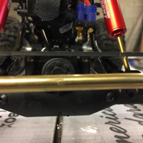

The shocks are Yeah Racing 120 mm desert lizard internal springs, they can be set up as droop or sprung and they are oil filled they were 19$ on eBay for 2. I set them up with a 10 mm med rate droop spring and a soft rate long spring on top. So basically I used the droop spring like a limiter ,they are 5 mm longer than my stock losi one and look a shit load cooler I think. And I also dropped them down to the lower link hole and mounted to the outside like the shock mod. My hope is that it don’t give more flex than it had set up this way and to look cool. The motor and esc I got from the classifieds it’s a sensored 17.5 Novak ballistic and the esc is Novak 2 and 3 s I believe, I can’t remember now , heck I forgot that I even bought the stuff till I got the mail this morning. Lol. And that trany mod wow what a difference if you have a lnc look into that . It is well worth the time.
Let me know what you think.

Ok I started the instal of the Krazed builds axle plate. I don’t like how he suggests to file the hump off the top of the worm gear part of the housing . If it was better plastic or aluminum I may have done it but this plastic sux. So I took one of my aftermarket 3 hole link mounts and filed it flat. It kind of acts as a truss for the axle and it supports the plate just fine. Second thing I’m doing is making new track rods to factory spec well just the bottoms I have the uppers . But ive got to wait for my order of 5mm 4mm 3mmand 2.5 mm titanium rod to get here from China so probably not going to be done till the end of next week. I am going to use the chubs and knuckles off my buddies wraith I really really really don’t like the generic ones I’ve bought . Both sets suck way too much slop the angles aren’t right either. So I’m saving for vp xr10 or wraith set. And I will be setting it up with a behind the axle steering rod . With the servo on the side on this plate should take up a lot of the sloppy feel in my steering as well . I need to get a goat esc yet but it works with the one I’ve got in it it just don’t have reverse. That’s about it for now oh I’m going to buy some 22t pinions and have my buddy machine them to accept the bearings out of the center gear on my trany . I may try doing it myself idk yet no big deal really just drill it to the outside dia. of the bearing then make a spacer to fit between the two bearings. Like I said we’ll see

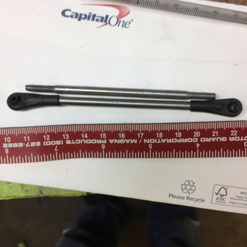

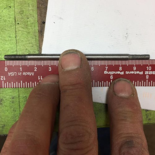

Two more orders : VP Titanium 3/16 105 and 120 mm track rods ,

got me a goat3 set up . I msg the guy on eBay and got it on an offer . Got 16 ss track rods coming for my stock pile as well.
