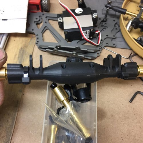

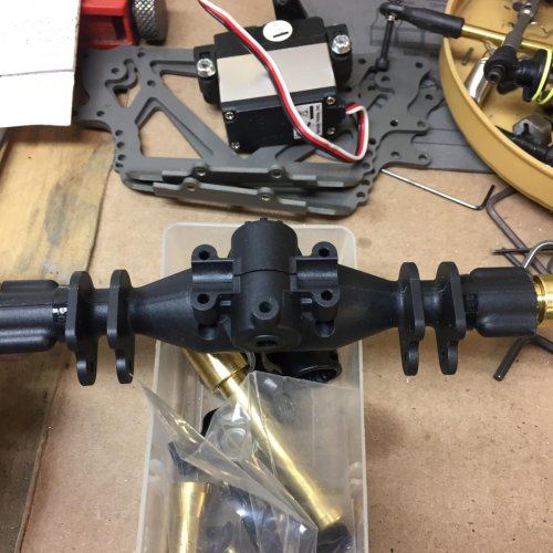

Thank you Ernie for the losi axle mod the stuff looks amazing! I can’t wait to get it done and run it now .
On the housing I drilled it most of the way on my drill press then I sanded it to fit with 80 grt. Sand paper. I still need to drill and tap the trumpets in and I’m going to use some Fusor 143 adhesive for plastic 1.1 bumper covers. I think that will strengthen any weakness I may have caused from drilling and sanding .
The Unis I need to get some safety silv 56 solder but I have them fitted and ready. Then I’m going to make a closure for the end instead of the zip tie .
I’m not the neatest or cleanest fabricator but i think it looks good.

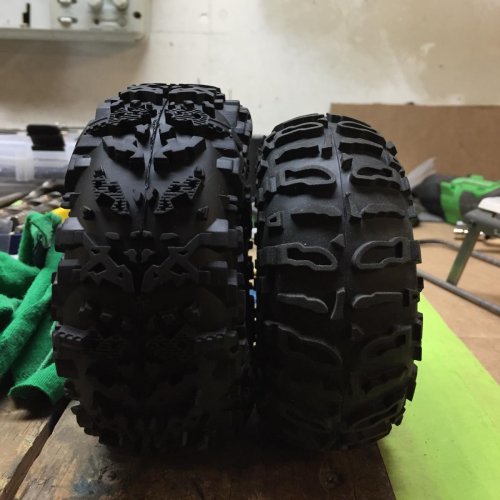

I also bought some taller tires and just been stocking up on parts mostly. Spare axles and such. And my buddy grabbed a hustler chassis for me to build him for a crawler so he can keep his wraith a bouncer and I’m going to copy the chassis and downsize it a little and make myself one to tinker with . That’s about it I think

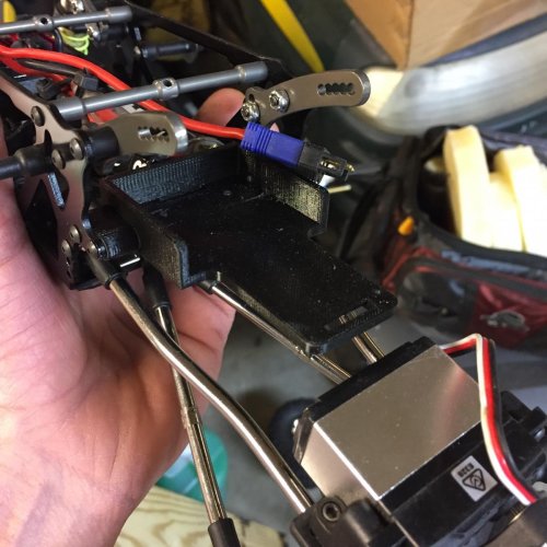

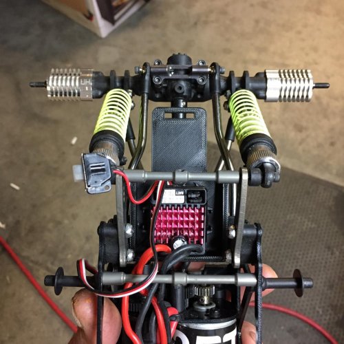

Well I finally put some power to it tonight, not the right pack so I didn’t take any pics, that and I need to remake my servo arm it’s too short but that being said it is a completely different machine ! This thing is Awsome now I can not wait till it’s done done. Thank you everyone. The axle mod is sick thank you Ernie
Well I took it out and ran a pack through it, may have been a little hasty but it was a good shake down. That being said i found out the goods and bad’s . When people tell you to loctite stuff it isn’t for said person to just let out breath! Loctite !!!! So ok stuff came loose , screws fell out but all in all it was a killer shake down! This thing damn near claims walls now . The articulation is crazy and immediate, I mean like it well I’ll show ya.

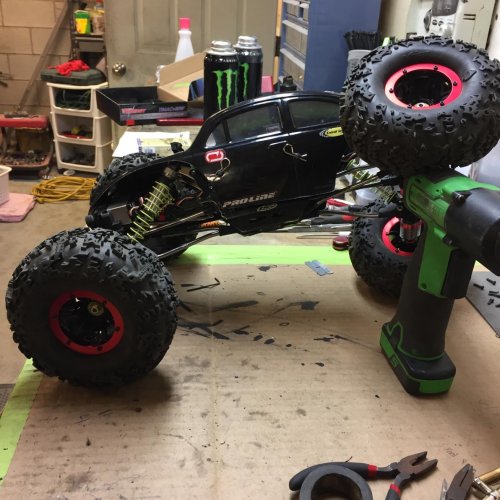

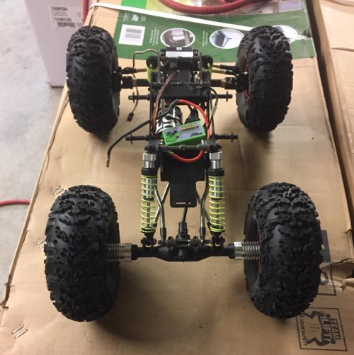

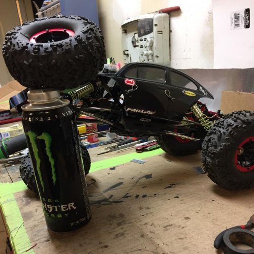

Well I know pics don’t impress “you” but it all works like it’s supposed to. It’s not all floppy like some of the Wraith mods I’ve seen on YouTube. It actually works and the steering is insane. The only downfall is that my servo sux but I have a savoxthat was in my C.E.N. Nitro buggy I just need to get a new horn . That and I need to remake both steering arm again . I don’t like the 1/4 inch it’s too cumbersome. So I’ll make them out of 3/16 titanium. It’s pretty cheap on eBay.
So all in all I don’t think I did too bad for my first build , I know it’s early and I’ve only put one pack through it but it seems really ... solid lol as long as it’s locktited. Ha oh well let me know what you think good and bad I want to know your thoughts cause after all this is my first!
Looking good Tod! That is some mean flexing. I'm sure that you will learn as you put in some rock time that that much articulation can get you into trouble some times. It allows your tires to drop into some holes that could bind up your running gear. When you have time go back into the losi thread and you can read more about it. JMO all in all your doing a great job, and love the bug body!
Keep up the good work!"thumbsup"
Ernie
Ernie
I understand that that’s what I was meaning about being floppy. It don’t “ drop down” all the flex is up and not greater than 45 deg. So I’m hoping it will be good. I think the biggest improvement to the flex is the width of the axlesto be honest, I’m sure the track rods have some to do with it but not all. Ya I’m sure once I get some time in I’ll know better but I’ve been trying to follow the guidelines as in length width flex angles and such and have stayed in them pretty well so far. One thing that will change that is I put wideners on the front to becaus my losi hex’s wouldn’t fit the pin on the xr10 shafts so I need some axial hexes for the front . And if it don’t work out I guess it’s back to the drawing boards lol, or get on building my mini hustler lol
And I’m not saying it won’t bind I’m sure it will. All I’m trying to say is from what I’ve seen the only bind I got into so far is the cheap servo letting the steering turn too far when it all started to loosen. So I guess I’m just trying to say that I’m not arguing with it I’m more hoping you’re wrong lol. :lmao:
