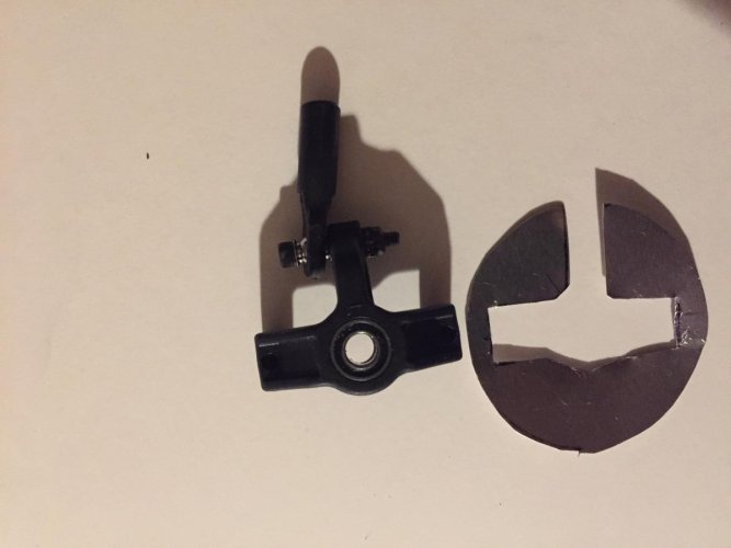

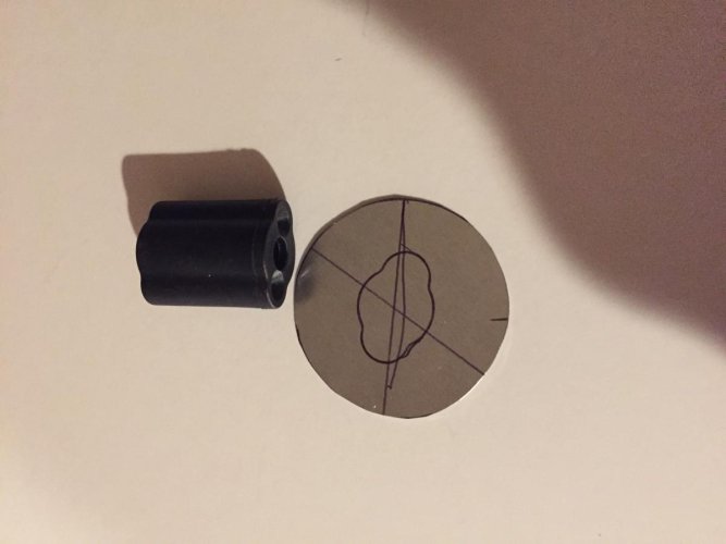

And right now I’m making templates to make my axle weights until I get me upgraded axle stuff next week from Ernie . Thank you for hanging in for me bud

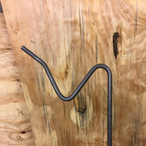

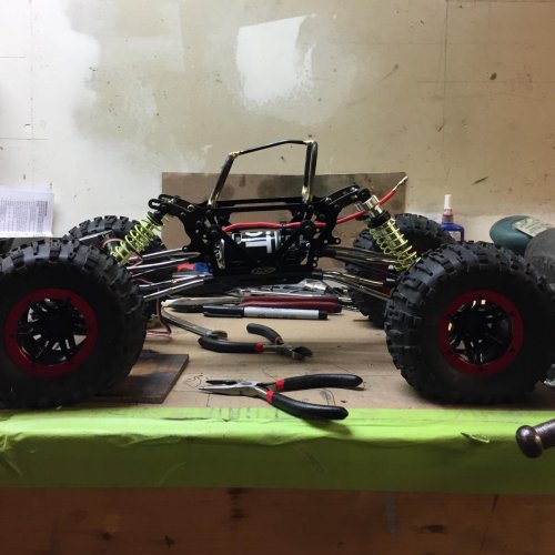

With my upper trailing rods when I had the straight rod in there it hit the spring really hard so I put it in my bender put about 20 deg zigzag bend in it .now it just touches the spring slightly. I’ll take some pics of that once I get it up and running.
Quick note : I changed the steering link from straight to bent just for the looks, it fit fine nothing touched . I thought it would look better bent ? Oh and I forgot to mention that I found the stock LCC track rods from two different places on eBay . I got the uppers but got ripped off on the lowers. That is why I made my own if anyone is looking for stock uppers I’ll send them to you just pay the shipping.

That will change when you get your XR Steering upgrade. ;-)
Ernie

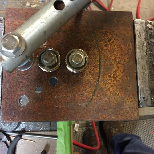

Did some fine tuning on my rod bender not sure I’m done messing with it but ya never know. She isn’t putty but she sure does bend rod that’s 1/4 cold rolled steel.

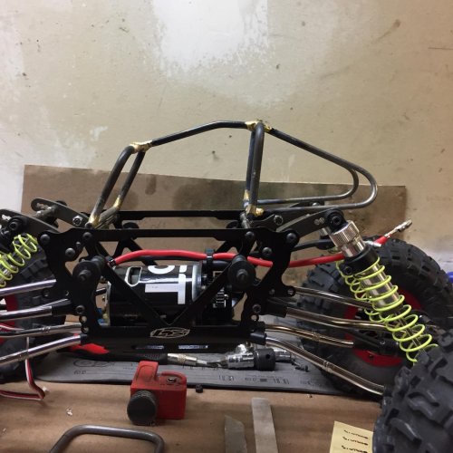

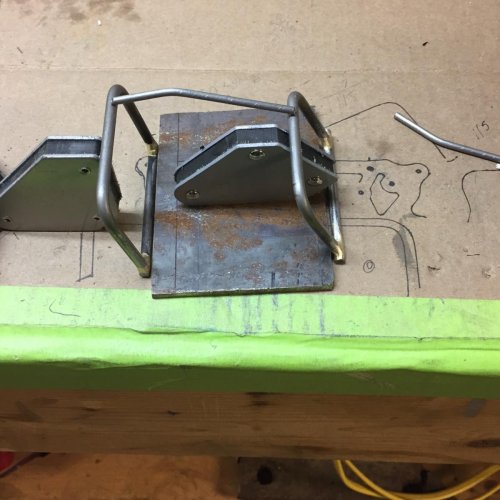

Got the front hoop made for my D.M.G chassis copy made

So I’m trying to copy D.M.G. Cage but don’t want it to be exact so I think this is good for now, still need to do the ends but the woman upstairs thinks differently... to be continued.... well edit had a few minutes while she was cooking and got the back mostly done
Let me know you opinions please!

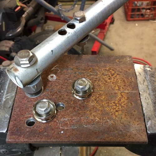

Well the tubing bender I made works ok but after using it a couple times . I found that I need to re fab it. I’ve made a change already but it just needs rethought out . And now with one chassis made I kinda know what I need till the this is my change.i moved the stopper guide to the center because while it worked on long beds it didn’t fair too well on close together bends Like making the hood bar for my cage it wouldn’t do it at all .

Here is one I use, same concept as yours. I've built 4 or 5 of these, should be pretty easy for you with your skills.
Front and back.
If you're duplicating bends just mark them on the surface with a sharpie.
Old jack handle, I actually have a spare one of these.
Parts to put it together.
Hope that gives you some fix ideas!!! Happy building. "thumbsup"
Ernie
I like that big board for marking on. Once I get mine to where I’m done messing with it I was going to put a magnetic tape measure on it to duplicate stuff . But yes that’s basically what I’m going to end up with simple but effective! "thumbsup"
