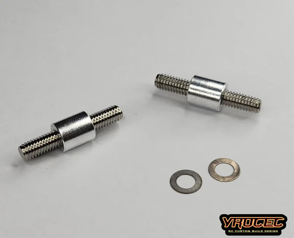

FYI, yrucec DOT com has connecting links to use with VP Metal Rod Ends to make up metal Steering links for the Hydro Ram.
They're pretty cheap at 11.90 a pair. I also picked up a Jeep looking front grille and a set of the Rear Shock Mounts/fins while I was there. Had to get 2 pair of the links as I'll be 4WS on this build.
Unfortunately, shipping costs more than the links and YRUREC doesn't offer a distributor in the US. I really have no interest in their other products.

I like the idea of using this type of link and almost ordered some a week or so ago, except the price of these plus the Vanquish rod-ends was a bit steep. What would be great would be if we could find another product that would serve the same purpose, or maybe someone will release a less expensive version.
Some folks have been using the shorter linkage from the VFD twin shift linkage kit. It is available from Vanquish, but they are $9.99 each and you need two. IRC00073
