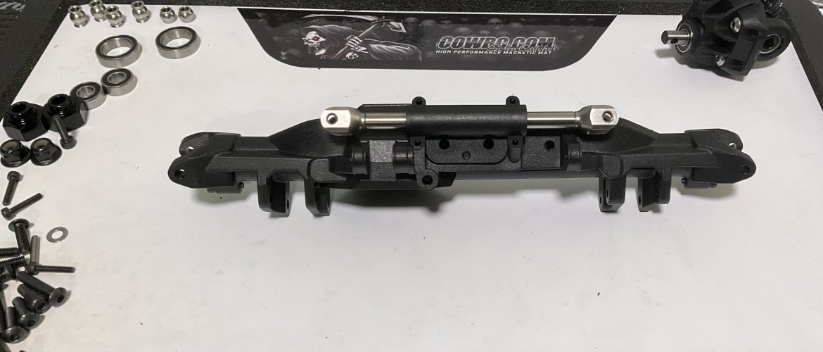

Ram for the hydro steering assembled. Not the most exciting picture. The parts went together well. There’s friction in the slip fit for the rod, but that’s probably necessary to avoid slop in the steering. Will be interesting to see if it loosens up over time or if that becomes an issue. Having some kind of keyed reference for the two ends would be helpful. In the current setup, they’re free to rotate while screwing the parts together. I eye-balled the relative alignment. There’s not a great reference once the rod is installed into the ram as required before attaching the ends – without this you could install one end and hold the rod / second end flat against a surface while screwing the second one in place.
Ok, probably way too much in the weeds on that one …
I should have squared up the picture. Feels like I'm falling off the edge of the world.

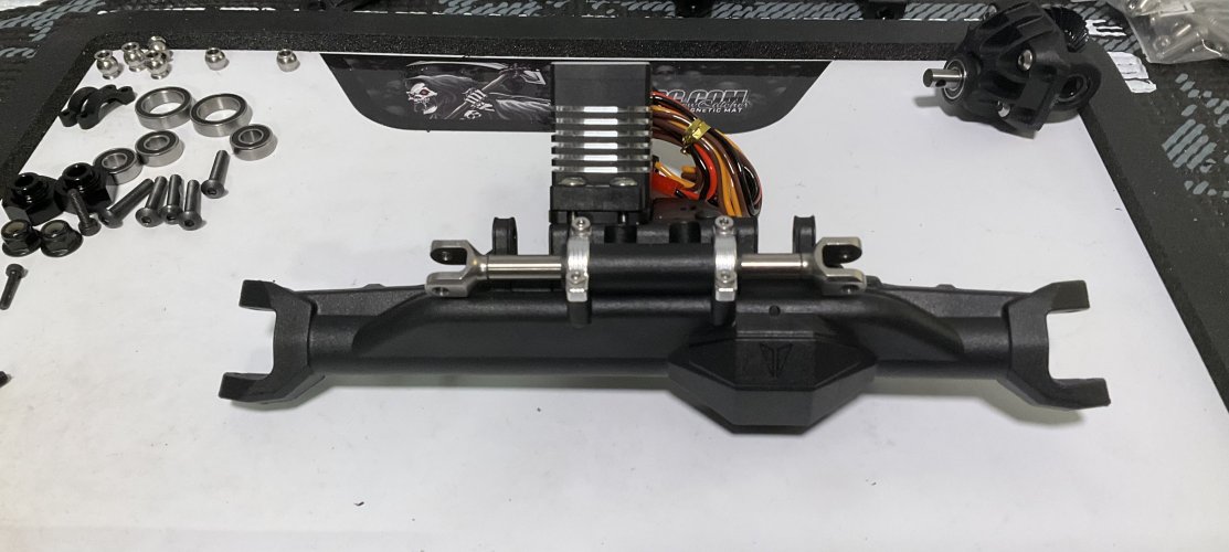

With the ram placed onto the front axle. The interlocking mounts for the ram and the servo mount are pretty sweet. The fitment is notably good in that everything holds together prior to installing the screws.
Servo before unboxing. It’s a pretty one for sure
With the servo installed on the axle. The manual calls for using 16 mm M3’s to mount the servo. These ended up poking out the bottom on one end, so I replaced them with 12 mm screws. There’s still plenty of thread engagement and the ends are flush on the backside with under side of the servo mount. Have any of you used the brass servo mounts? Seems like a great way to add weight to the axle, although it’s cantilevered – are weights on the steering axles better or does it not matter?

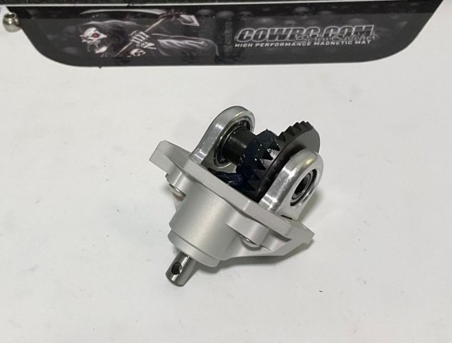

Received the aluminum front member! Here it is in the package. Seemed worthy of a full un-boxing

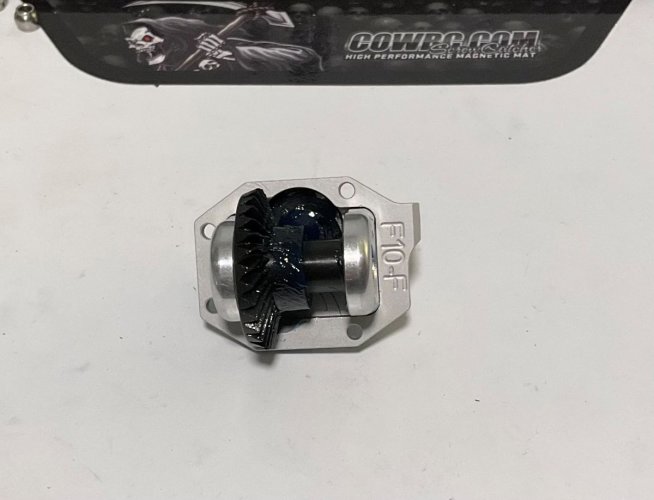

With the gears installed. My only regret in all this is that I greased the gears before (originally) for test fitting in the axle. Made the transfer a little messy. Beautiful assembly in the end. The machined Vanquish parts are very well done. The gears are buttery smooth. May need to get the aluminum rear member now that I’ve seen how this one went together.
Installed on the axle. Fit together perfectly. Fantastic tolerances. Super satisfying to assemble.

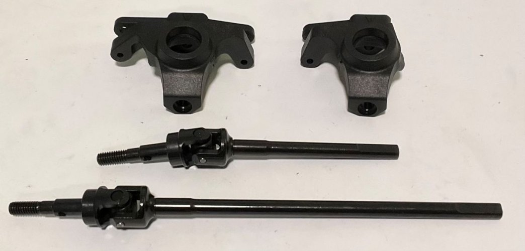

Next up are the knuckles and universals. I may look into metal knuckles if these are available, although the plastic looks like it will last. Silver knuckles could look sweet with the black/silver theme that’s emerging for this rig.

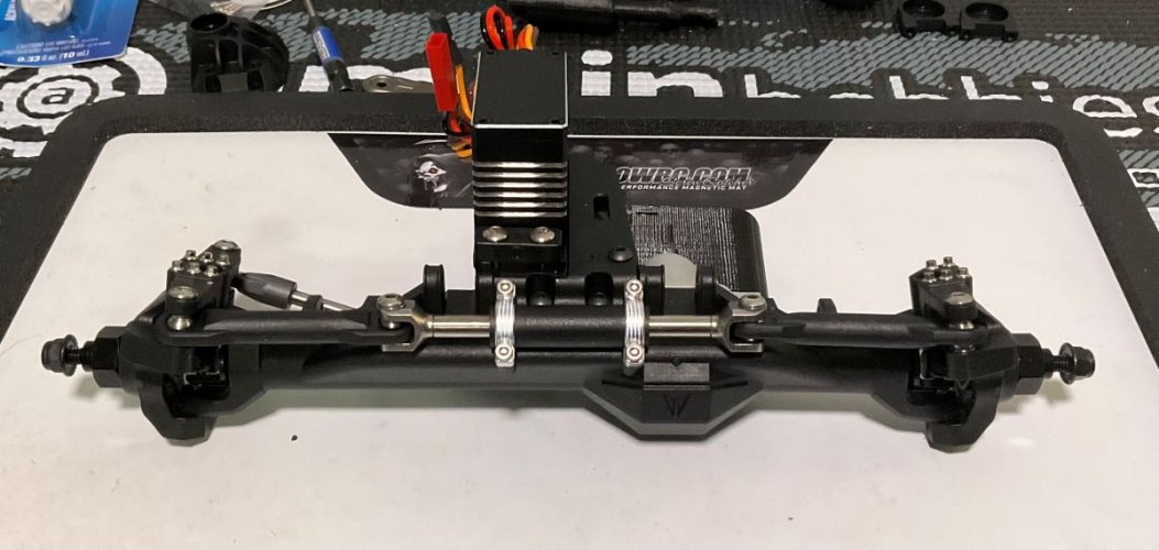

And the front axle is done! Well, all except for attaching the drag link to the servo. Just need to center the servo to get that part done. I think I have enough electronics on hand to do this and separately power the servo.

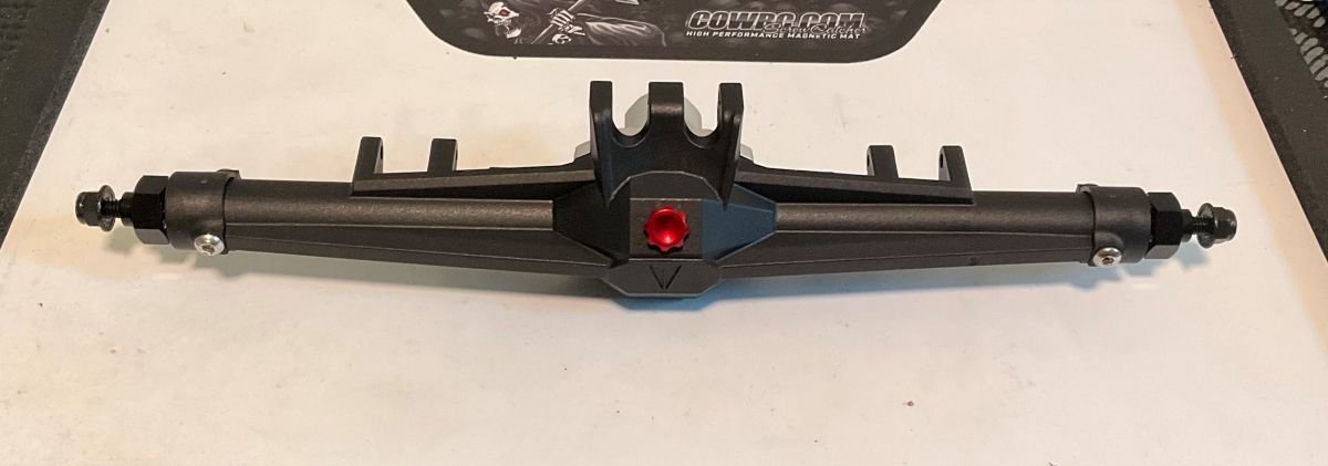

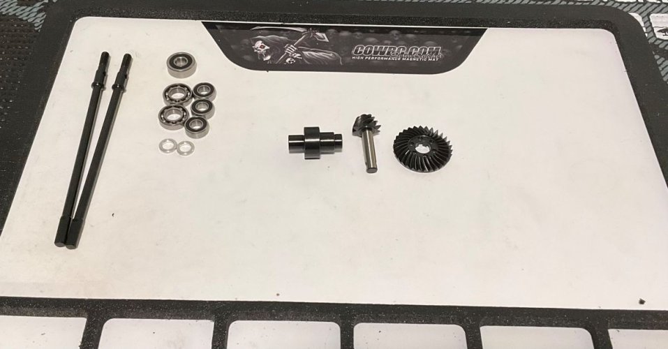

Next up is bag B. In my defense I was waiting for the aluminum 3rd member to arrive before starting this one. The fit for the gears was so nice on the front that I decided the aluminum part was a good idea for the rear also. Makes me want to take a look at my Phoenix again. Ignore the fact that the package is cut open already. I did that a while ago in my confusion over having a rear third member in Bag A.
And the honorary unboxing for the aluminum 3rd member. The Vanquish aluminum parts are always nicely done. The Ziploc-like packaging is a nice touch. Down side is it adds to the collection plastic bags and the temptation to use them instead of better methods for organizing leftovers.
Arranging the gears. I’ve never figured out a good way to hold them during assembly that avoids mashing the sharp-ish teeth into my hands and fingers. Maybe a reason to get some shop rags or similar, lol
Assembled 3rd member. The parts go together fantastically well with what seems like perfect gear mesh. All butter smooth with no noticeable slop. Satisfying for sure.
And the finished product. I liked the stainless screws for the lock outs in the moment, but may change them back to the stock black after looking at the pictures. The red cap is a nice touch. The included installation tool is great, as others have pointed out.

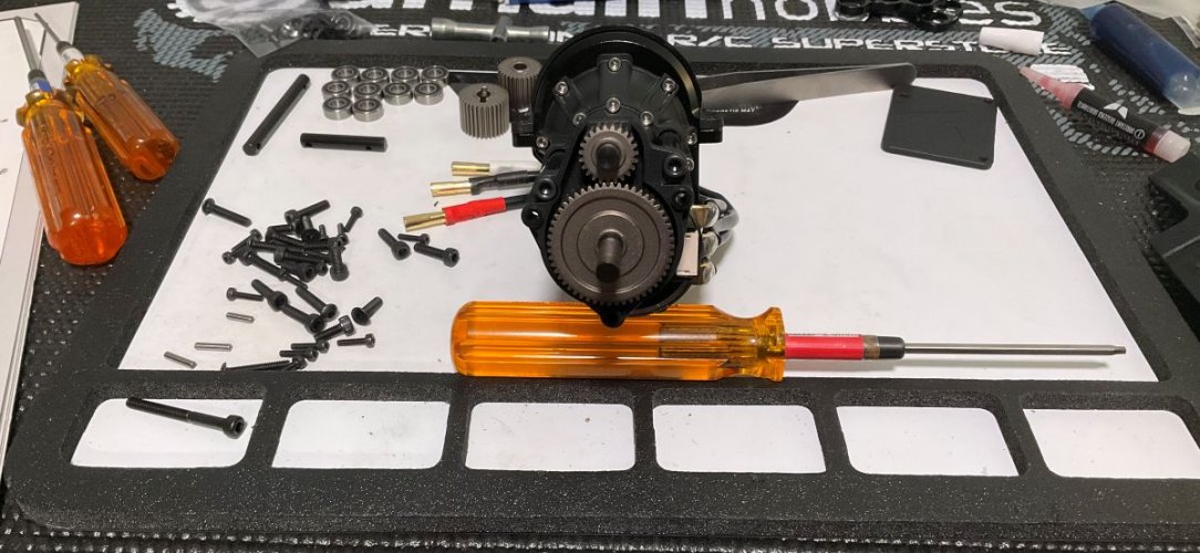

Time for Bag D and the transmission. There’s a lot stuffed into this bag as you can see from the photo. I’ll start with the transmission itself and may wait for the later steps where it’s mounted to the skid plate. I haven’t built a VFD transmission before, although I built the twin version for my Phoenix. Both were satisfying to assemble. The parts fit together with no issues and the gear mesh is great without fiddling of any kind. The machined motor mount, posts, and related parts are fantastic. So now that we’re past all that, onward to the build!

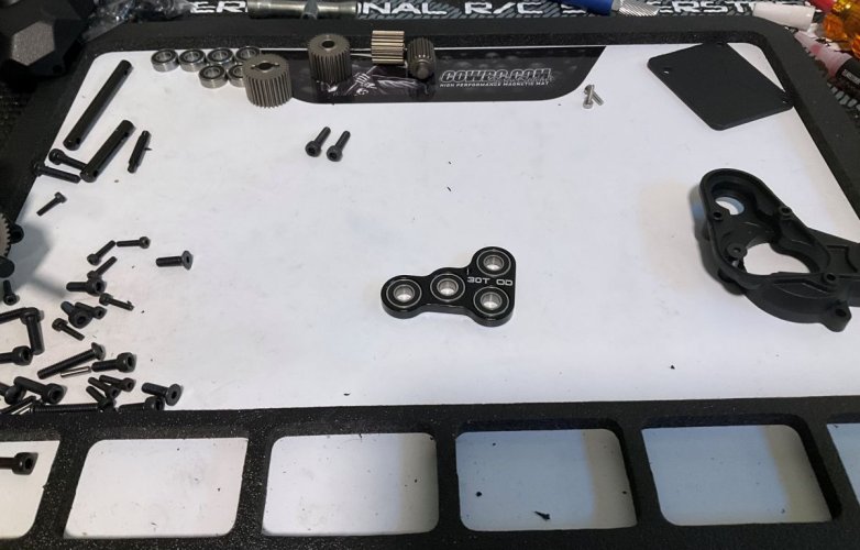

Starting with the motor plate and posts. I do (oddly) enjoy arranging the parts on the build mat. The mat I’m using is from CowRC. I’d recommend getting one of these or similar. I built kits for years with just a pit mat. It’s much easier when the screws stick to the build surface and are easy to see versus searching on the black pit mat I use otherwise.

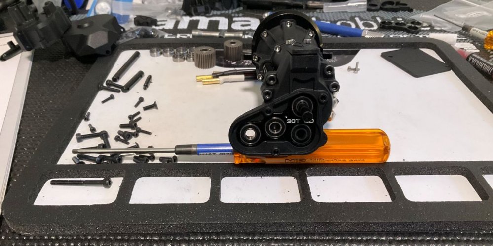

Motor mounted along with the posts, the slipper eliminator, and the spur gear. The only tricky bit at this stage is holding the posts in the desired orientation while tightening the screws. Shock pliers work well. I wanted the Vanquish logo clocked horizontally. This obviously isn’t necessary. It only shows on one side once the bell housings are installed. The slipper eliminator is a nice part. I don’t remember this on the Phoenix, but have probably just forgotten as that was 2+ years and several mental lifetimes ago.
Bell housings, rear housing, and transmission gears installed. I used stainless fasteners for the housing as an add to the black / silver theme for the build. The transmission housing keys in nicely.
I will point out that it’s much easier to install the bearings into the aluminum plates first rather than once they’re installed into the transfer case. This may be obvious to others. I, however, tried installing the plates first and then the bearings. This did not work at all. Assembly was easy once I loaded up the plates first. Another mistake I made was forgetting to install the pin that runs between the two bearing plates – not a big deal, but I had to take the transfer case apart at the end to put it in.
First bearing plate installed. I really should clean up my build area before taking photos, or at least organize the screws. Truer to life this way, lol

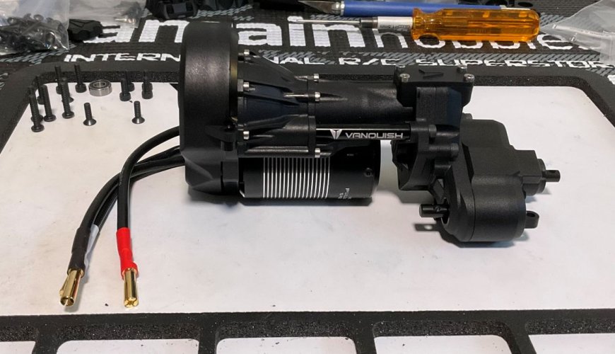

And with the transfer case gears installed. I double-checked the gear placement several times. I’m not sure if it’s possible to install the gears so that the overdrive is backwards. But then I also didn’t want to discover I’d done this at the end of the build. The gears are engraved with their tooth count, which makes checking them in-situ easy. The gears look sweet in place. The mesh is awesome.
And the transmission is done! I like others I'm somewhat bummed the gear cover doesn’t come with the shifters. Seems like a small add to the kit. I’m not sure yet if I’ll pick up the shifter version as it’s packaged with other parts I'm unlikely to use. Might wait to see what I end up doing with the interior and if the cover shows once all that is in place.
