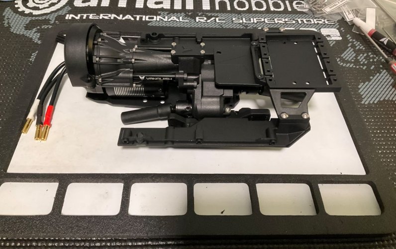

Next up is mounting the transmission to the skid plate. No issues here. The transmission settles into place without any fasteners. Definitely some thought put into how the various parts go together.
And with the skids installed. The plastics are great. The parts go together nicely. I had to stare at the manual for a while to get the orientation right and find the fastener holes. No bid deal if you’ve assembled kits before.
And finally the electronics tray. It was nice to see how the parts interlock to make the overall assembly fairly stiff despite using plastic materials. It’s a clever design approach that also makes the assembly very satisfying. You don’t get to see these things on RTRs. Happy I was able to get an Optic kit instead.

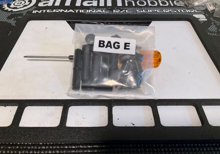

Bag E with the driveshafts is next. Nicely packaged to start
And with the parts organized on the build mat. I did take some time in this case to organize the parts. Makes for nice photos and also simplifies the build process with less hunting in the pile.

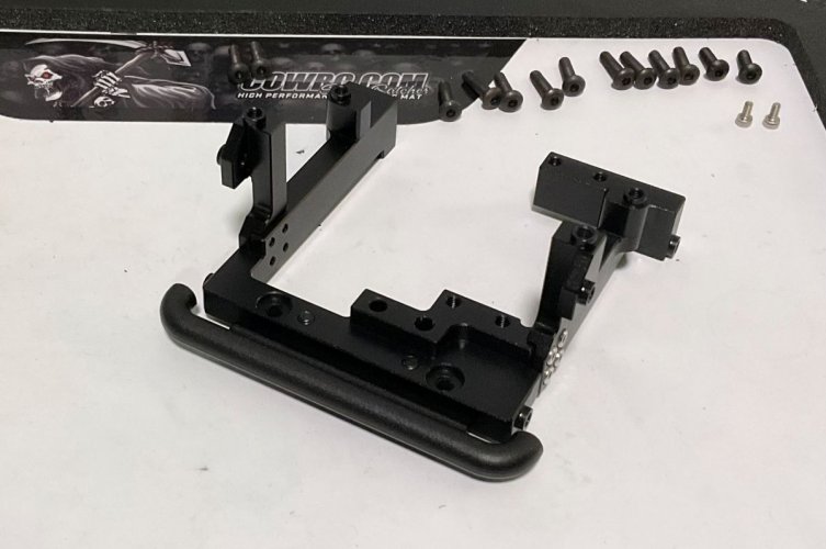

Next is the aluminum front mount, starting with the individual parts. The machining is very nice. The two “ears” slot on perfectly and are each held in place with four screws. The exploded screws on the left are from Bag G. They’re not relevant to this piece at all. Hanging around anyway to maintain relevance for subsequent steps.
Here’s the aluminum front mount with the bumper installed. The black screws in the upper right are for attaching the cage. The stainless screws are spares. Nice to see these included. Super satisfying to assemble parts that go together well.

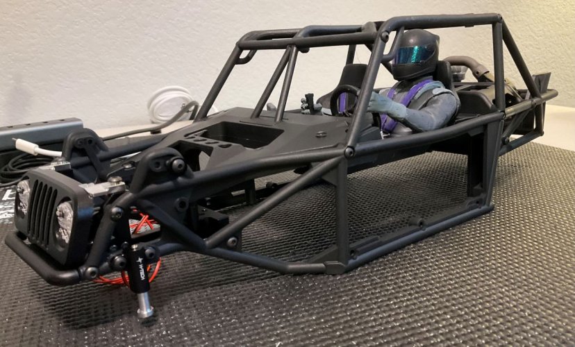

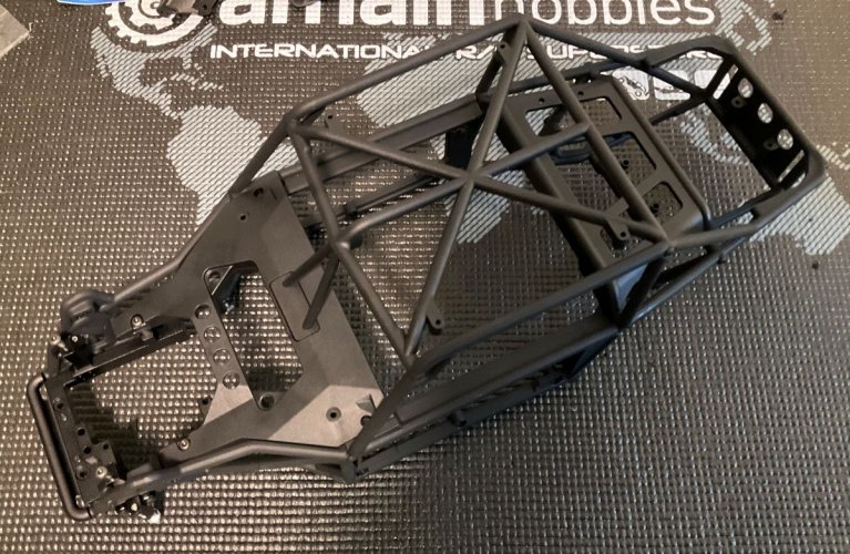

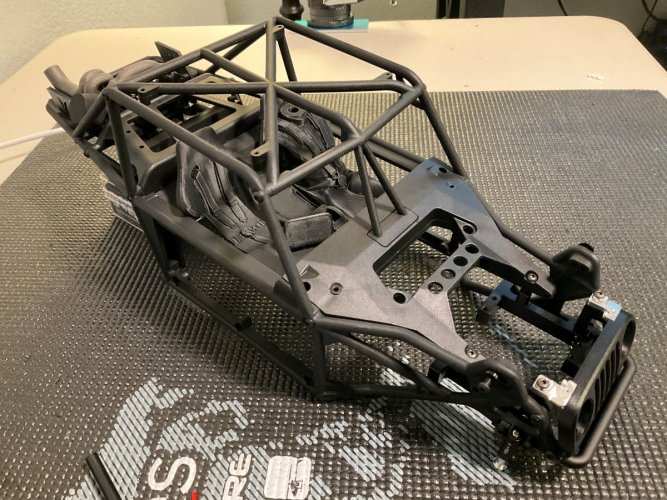

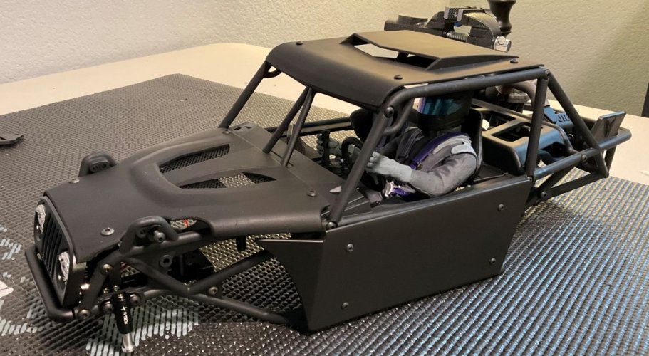

Next is the assembled cage. I’m skipping a few intermediate pictures / steps. But if you’ve assembled a cage before, these are all familiar. The end product is very solid, with obvious attention to detail given how the parts lock together. I have another plan for the power tank so it’s not installed yet. I’m 3D printing some racing fins. No issues with the fins included in the kit, just wanted black instead of gray
Here's a close up of the front assembly. Nice to see this coming together and getting closer to a roller.

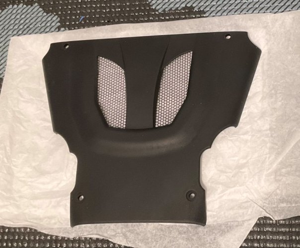

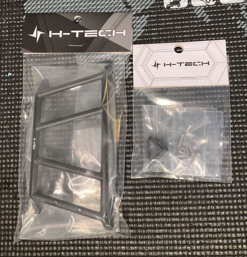

Quick update to install the front grill. This piece is from H-Tech also – ending up with a lot of their parts on this build.
This first picture is the grill prior to assembly. Same great packaging and instructions as the other H-Tech parts I’ve picked up so far. Silver for the mounting brackets is interesting. I was expecting black for all of the parts, but ended up liking the mixture once the grill was assembled.
Here it is installed on the truck. The blue highlights are an artifact of the photo. Maybe a reflection off something nearby.
Another view of the installed grill. The parts went together well. I ended up using longer screws up through the bumper, maybe 10 or 12 mm instead of the 6 mm listed in the instructions. It’s all very solid and looks great once installed.

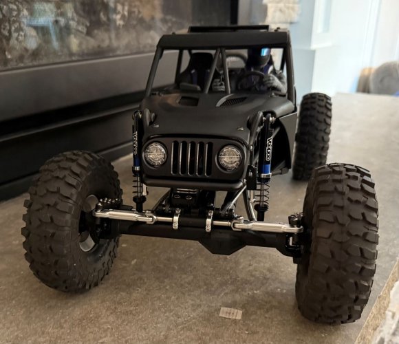

I saw the posts where others said 2.2 wheels and tires looked “cartoonish” and out-of-scale. But it’s hard to appreciate how true that is until you see it in person. Oh my, what large tires you have! I’m a big fan of huge and aggressive tires, but this is like completely out of scale. I probably should have guessed since the 2.2 Rock Beasts are a full inch larger OD than recommended. On the bright side, the LockedUp wheels look sweet and I do have other 2.2 scale rigs that could use a set of wheels and tires.

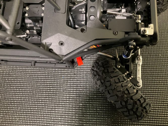

In case you’re wondering, the 2.2 Rock Beast do clear the front at full steer. I was pretty surprised to see this. Actually made me consider keeping them on the truck. But then look at the previous photo …

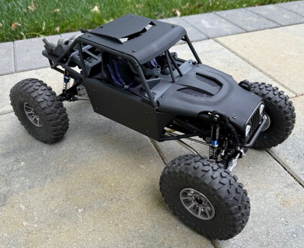

I have a set of 1.9 Rock Beasts on Scale Shop Stockerz wheels. You’ll recognize these if you’ve looked at my Phoenix build thread. The wheels are beautiful. Lucky to have a set. Here’s the Rock Beasts + Stockerz on the tuck. The noticeable lean is due to the mega tires on the other side. Certainly better, but a little undersized at 4.45” versus the recommended 4.75”.
As you might guess, the more suitably sized tires also work fine at full steering lock. The angle in this photo is less ideal. The tire clears the link just fine.

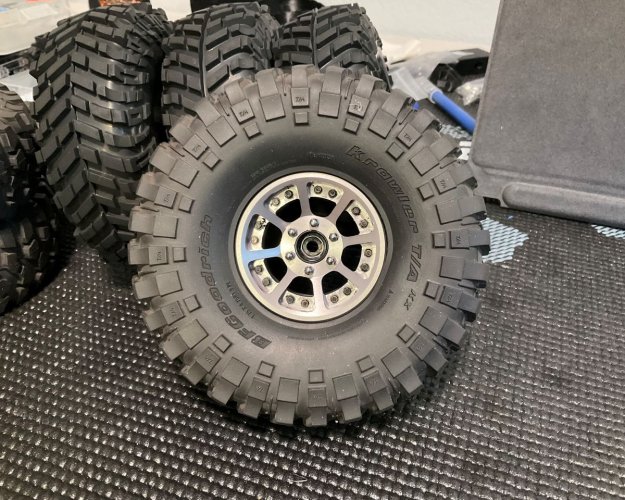

I have one more option which is moving the set of Proline BF Goodrick Krawler T/A KX tires off the Vanquish Method 105s on my Phoenix and onto the Stockerz. Moving the tires + wheels complete is another option, but that would be to fast and easy and the Stockerz are a better match to where I want to go with the Optic. I’ll bring this switch up to the next post once I’ve remounted the tires, only something like 28 screws per Stockerz to do this, lol
Take care until next time!

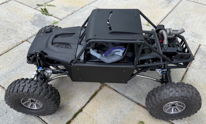

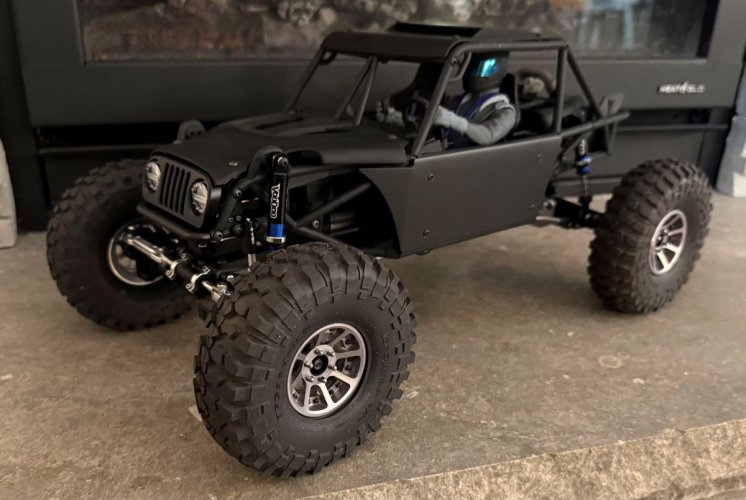

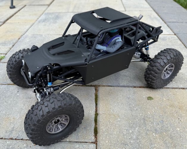

After a few short hours of turning screws, behold the Proline BF Goodrich T/A KX tires on the Stockerz. Turns out the suggested tire diameter of 4.75” is a great match to the truck. Planning to stick with this setup for now. The screw turning is hardly over, though. I only had enough scale hex bolts for one wheel (the front one in this photo). I ordered enough for the rest of the wheels. It looks sweet and seems more fitting to deploy these wheels with all the trims.

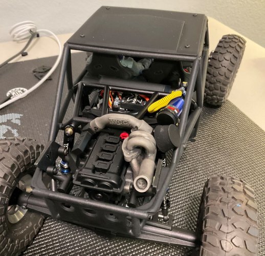

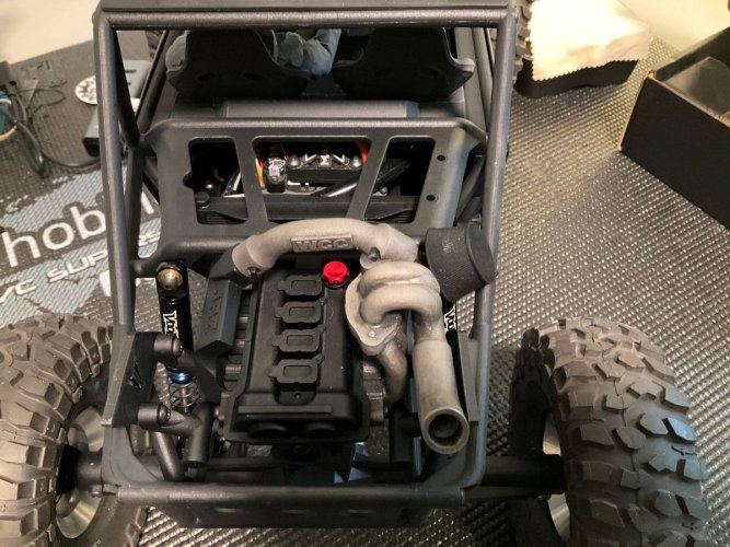

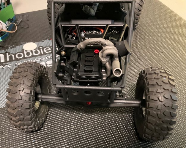

I also took an idea from RC Girl and added a scale engine to the back. The 3D model is available here: Vanquish Optic Modular Rear Engine. RC Girl’s video is available here. My version is very similar to the one she put together: exhaust and a few other parts in metal. The rest in resin, all from JLC3DP. The prices are great, the website is easy to use, and the print quality is very nice, especially compared to what I’m able to do at home. Plus no home capacity for metal parts. Or maybe that’s wrong, but lacking in confidence for printing in metal for sure. I did try printing the plastic bits at home first and wasn’t happy with how they turned out. The resin versions look fantastic with essentially no print lines at all.
I used Abteilung 502 Starship Filth as suggested to tarnish the metal parts. Pretty excited with how it turned out. I’m going to order a rush wash to weather it some more. Here it is on the bench
And installed in the cage, which is separated from the chassis so I can install the electronics.

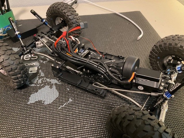

I did make a few bits of progress at least. Installed the ESC and routed the wires from the motor. The stock wires on the motor were unfortunately too short, so took longer than it would have otherwise. That doesn’t explain the lack of posting, but apparently bringing it up anyway. I’m pretty happy with how the wires turned out in the end. I made right angles at the ESC bullets. The wires themselves are sort of just long enough. If I had a do-over I might make them another 1/8” longer to have more slack, but this is home made after all.
Probably hard to tell what's going on with the wires everywhere. Promise I'll clean them up

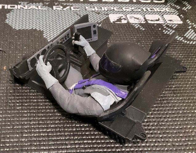

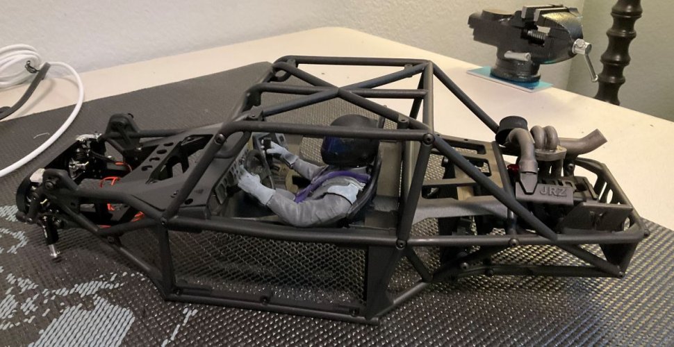

I also started printing the Knight Customs Optic single interior detail set. There’s an impressive level of detail in the print. I haven’t tried Knight Customs previously. Happy I’m doing that for this build. I’m using Bamboo labs PLA matte and printing the parts tipped 45 degrees on the print bed as suggested elsewhere to minimize layer lines. The baseplate turned out reasonably well. I have some Tamiya acrylics on the way to give that a try also. Hoping I don’t mess it up
Quick fit inside the cage
