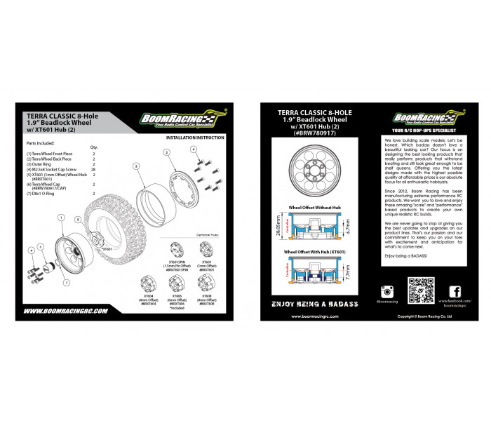

Wheels are the Boom Racing 1.9 deep dish wheels for a retro flair.

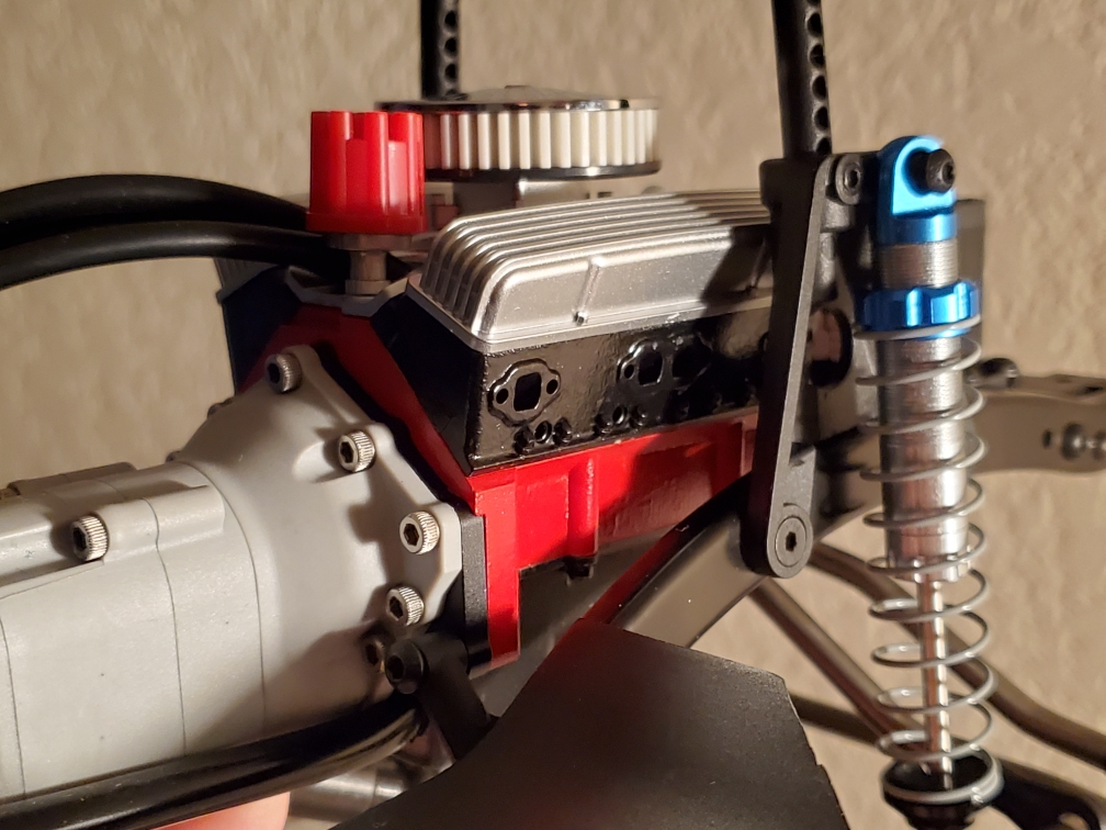

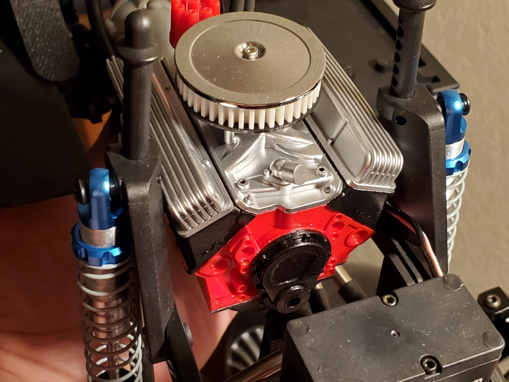

Thank you! How could you not like a kit that comes with a Chevy small-block? :mrgreen:
The small block is one of the reasons why I like it so much!:)
I hoping to pick one of these up after the first of the year. I think it will make a great Class 1 rig.
I forgot to mention, I really like those Boom Racing wheels. Can't wait to see them mounted up!
Awesome man! I'll be starting my build soon too. I happen to have a RC4WD Chevy Blazer body that I got during their "Stranger Things" promotion that I think I might put on this. I think it'll be perfect. I can't wait to see how yours goes. Those Boom Racing wheels have been in my wishlist for the longest times, I'd be interested to see what you think of them.
I like the engine...decided to paint mine. My colors might not be "accurate", but I like it.
~ More peace, love, laughter & kindness would make the world a MUCH better place
