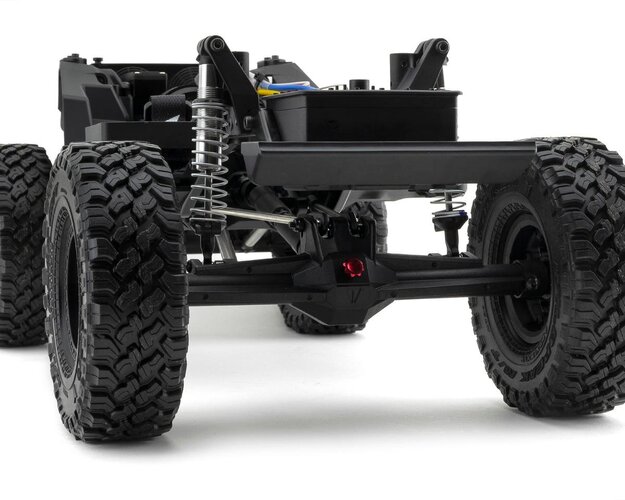

I have a question for the resident experts on this forum. I took something apart without really paying attention to orientation. Shame on me. The photo shows the right rear shocks. The offset lower ball has the shock sitting inboard which makes it mostly vertical. Did your Fordyce come like this or did yours come with the rear lower shocks offset to the outside? The photo I took beforehand seems to show the shock offset to the outside, but then that would not match the front and it would also angle the shocks outward at the bottom. How was yours assembled - front and rear?
I put my shocks to have the spacer on the inside. Looks like thats how they do it from the factory in the pics I see.

Which pics are you referring to? In the photos on the Vanquish product page, it appears the rear shocks are angled, but I haven't seen any photos verifying this.
I do the same. Spacer side in so the bottom of the shocks are further out. I don't know if it would be noticeable, but it should be more stable that way.
Search Fordyce on AMain. It is visible in one of their pics.
I guess you are talking about this photo. Definitely appears to show the spacer on the inside especially on the left rear. Thanks for the info. Flipping this ball may allow the shock to move away from the shock tower just enough for the preload collar to clear. I will have to check.

That rant just gave me the thought to check the Vanquish website. From the VS4-10 Builders Kit - Straight Axle photos, I found this picture that also confirms the shocks are spaced out towards the end of the axle.
