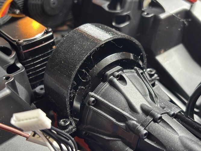

Last night I got the ESC stuck down. Then I realized that my wire spaghetti was likely to get chewed up by the spur gear since I am using Harley’s LS swap instead of the spur cover.
Over to my laptop I go, fired up Fusion 360 and designed a top-half spur gear cover. It immediately went onto my 3D printer.
As you can see, my estimate of the center of the circle is a bit off. No big deal. I will design Revision 2 next time I’m home. I wanted to add a wire management tab to the top of this cover and forgot, so another revision was going to come anyway.
