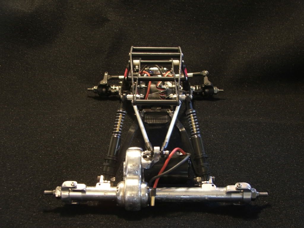

Got the truck together just a little bit ago and got two packs through it!
I lost a total of 3oz from switching to the new chassis and my new upper links.
My truck weighs in at 5lbs 12oz right now. That is with 14oz front wheels and 7oz rears. If I switched to my rover setup, I would easily be at 5lbs 2oz! After I get my rear tubes turned down with the Axial plastic lockouts, I should be under 5lbs easily. Not sure I would ever go that light, but it might be worth a try! I have to soften up my rover foams as they are way too stiff to work to their fullest potential. I have CI double deuces up front with a firm tuning disc on the outside of the tire to help with support since the rovers are clapped, in the rear I'm running Panther F400's. Maybe just switching to CI Double Deuces all the way around without any additional support would work well.
I'll have pics up in a little bit!!
Ok, On to the pics."thumbsup"
Body or bodiless???? 8) Got me thinkin now.:twisted: Damn this Thing is sexy!
Bodiless it is!:mrgreen:
The new Upper links are a LOT lighter than I figured the would be! 1oz for all 4 with rod ends!!
that looks awesome. hmm got me thinking bout widening it out now...
I'm sure that Don would make a wide skid for the XR version as well. You have to cut down your cab spacers to get it down to 3" again, but its pretty easy.
