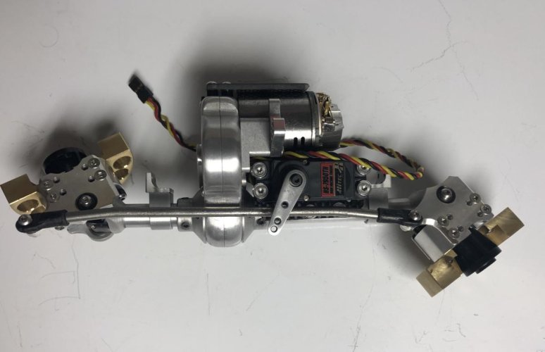

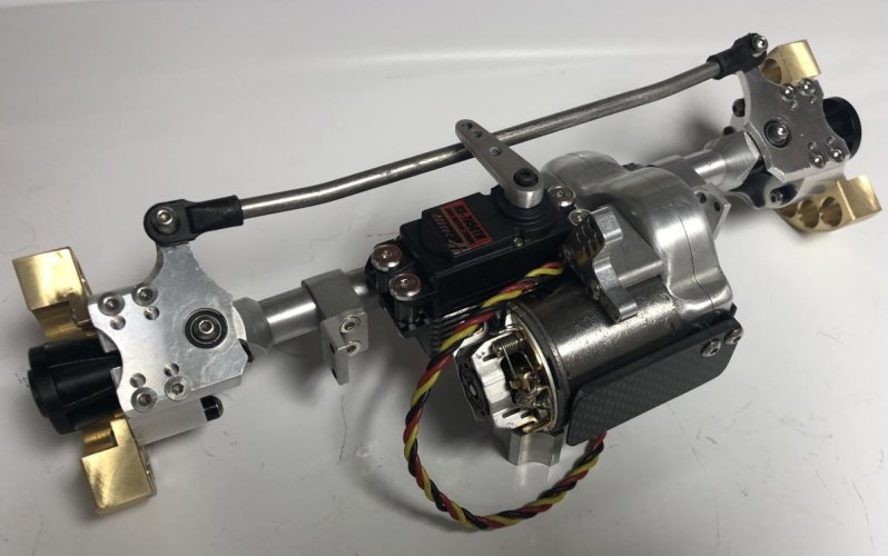

To add some tech for people who may not know. If you look closely you can see I flipped the knuckles upside down from how Dlux says to put them together so I have more clearance for the loaded dice weight at the bottom. I just learned this trick recently, and while it only works on non 8 deg, it allows for the button head screws to be at the bottom, which fit into the loaded dice weight better
I still really dig the older style Berg cases cleaned up and shaved down....I’ve got an old set I’ve been eyeballin again and a set of RCBros tubes your probably missing too....it’s good to see you backI didn’t get much done today, but did finish up the front axle. I started by making a servo mount out of 3mm carbon. It is held to the axle with 3 screws and red loctite.
Then I fired up the dremel again and made a battery tray for behind the motor. It will it will use a piece of inner tube for a strap aswell as get covered in velcro.
I also added steering stops to the axles using a 3mm spacer and button head screw which can be seen in the previous pictures. I figured out that a straight xr10 tie rod is an almost perfect fit with the Dlux knuckles and his proper ackerman arms. I put a slight bend at both ends to bring the tie rod closer to the gearbox and called it good.

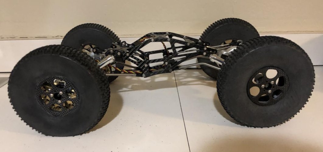

Had some time today to work on it today. Since it’s pretty much impossible to find vanquish ti links anymore I kinda guessed on some lower link length measurements and sent the info to hardcore rc over on facebook. I ended up having to put a bit more bend in the links then I wanted, especially the rears, but I think it should be fine for my dad. The extra clearance might actually help him while he is learning how to pick his lines. I made the uppers myself using 1/8 ti, a hand drill, and a 6
I’m not entirely happy with how the rear axle is sitting. I will probably play with the lower link mounts on the axle to get it to sit more to my liking.
Incase anyone was wondering about the weight, it is currently sitting at 3.8ish pounds. Only things missing are 2 speed controllers, rx, bec, and battery. I still have steel hardware everywhere but the chassis aswell as a couple of other places to cut weight if I wanted. The loaded dice are still empty, so that’s up to 8 ounces of tungsten that I could potentially add to the knuckles aswell.
