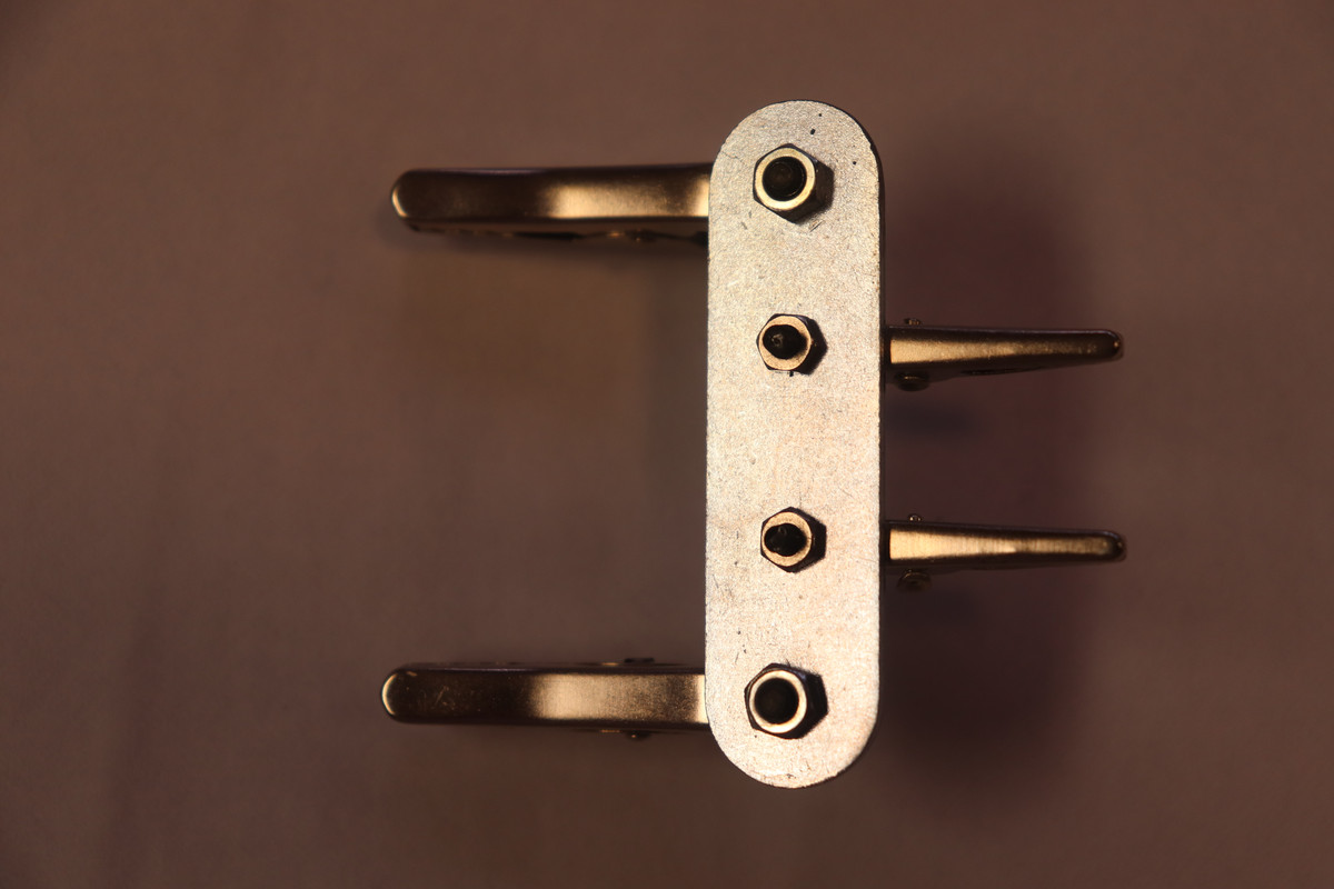

Maybe not a solution if wanting to just buy something and be done with it. Adjustability and a heavy base are also a plus with these other devices but this one works surprisingly well and cost me all of $3 for a pkg of asst alligator clips. I like that it's compact and simple. One side is equipped with small alligator clips spaced closer together and on the other side are larger clips spaced further apart. Clips are attached with socket heads and standard nuts.

DIY for the win!
lol It works! Like jato was saying... those little thumb screws are just annoying on the "classic" helping hands device. I hardly ever use mine anymore... Too many adjustment points and something is always too lose or too tight to be able to use it effectively/ efficiently. The one I made lacks a weighted base but for most soldering jobs I find that I don't need really need that weight as long as I can secure the two wires/ ends parallel with each other. And having things already tinned/ loaded with solder helps to free up my other hand. Once in place I can use my free hand to adjust the position of the wires if need be. I posted ( then deleted) earlier in this thread that I sometimes use 3M tape to hold things in place on my work surface but that's only sufficient on smaller gauge wiring until the tape heats up and comes lose.

forgot to post a pic.
full
