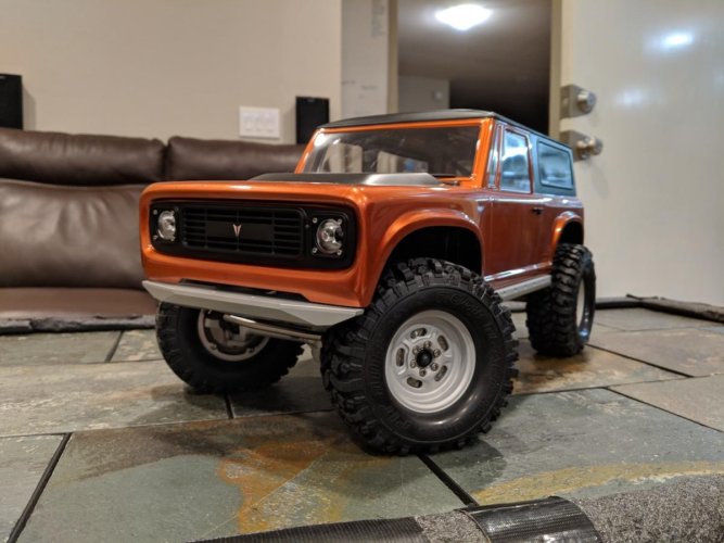

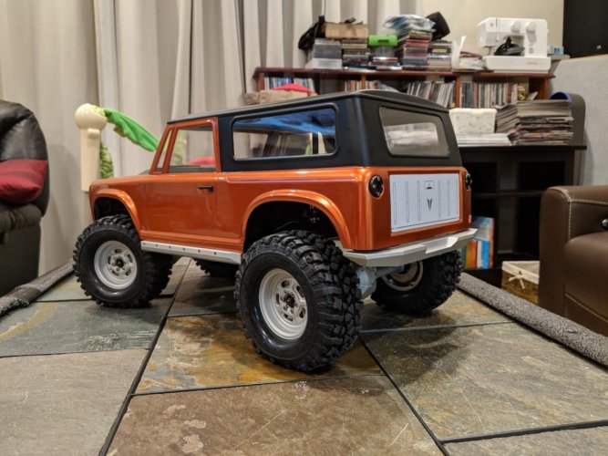

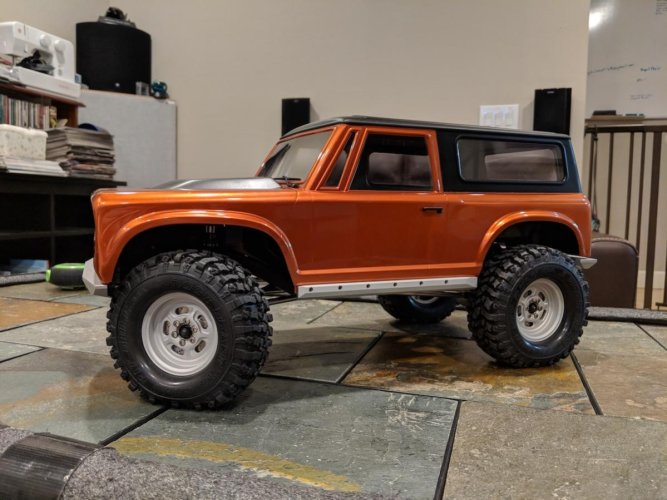

Still no interior; waiting on my Shapeways order, but the body, wheels, and tires have all come together. Worked out pretty much as intended, if you ignore my crappy paint job. (Matt, if you're still reading, avert your eyes).

Vanquish SHR i think.
They're one of my all-time favorite wheels, I was really stoked to see rohrej use them!
Vanquish SHR Vintage wheels... so nice "thumbsup"
Those wheels really beautiful. What brand are there?
What they said. Vanquish Vintage SHR. I think the styling is a perfect match for this truck. They are a 2.2 wheel, so the tires and foams had to be stretched on.

Nice job! I really like the color. I think it turned out really good.

That looks perfect! Great wheel selection! I, too, love those wheels, but never had a rig to use them on. I really wish VP would offer these in 1.9. They look better on scale rigs than they do typical 2.2 rigs like the Bomber, Wraith, etc.
Are those 1.9 Rock Beast XL tires that you're using?
Yes they are. With CI 1.9 foams.

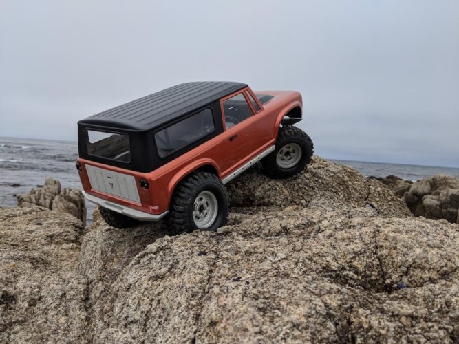

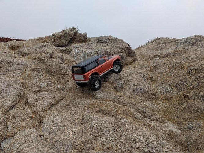

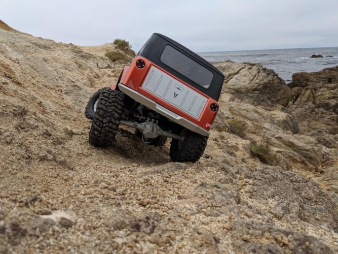

Put the first scratches on it today! Was hoping to get some picks of this copper paint in the sun, but no such luck.
