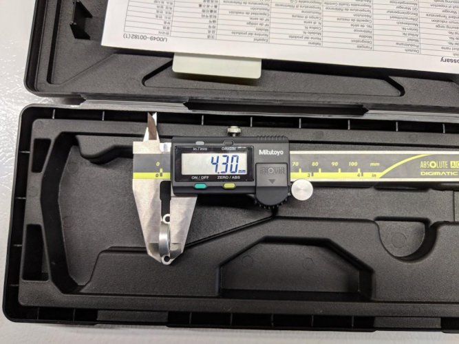

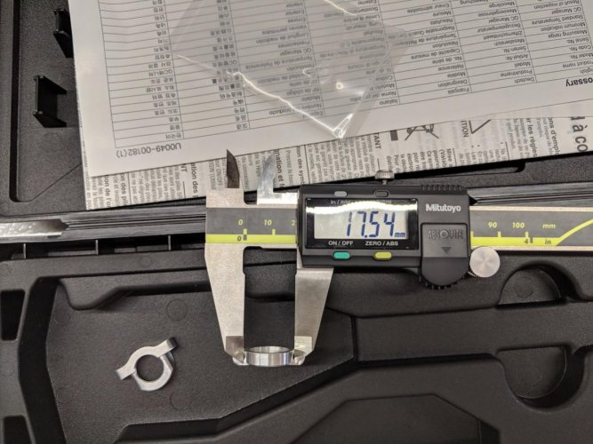

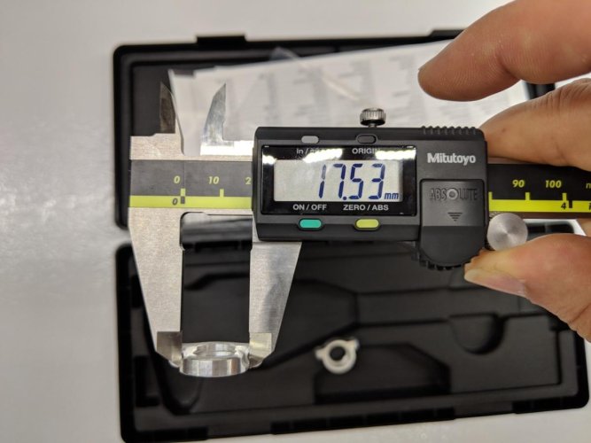

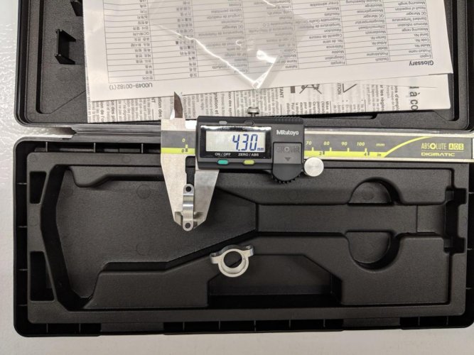

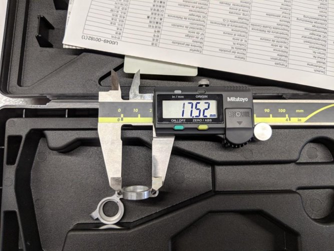

rohrej- it would be interesting to see. Would you measure that retainer at room temp then toss it in the freezer and remeasure it. I'm just curious to see how much if any those changes might effect dimensions.
Took some more measurements at 72° F.
Freezing now...
There is no measurable (by my micrometer) difference in the bearing retainer size dropping it ~70 degrees F. Before and after pics attached.
With a linear expansion coefficient of 22x10^-6 m/m*C, this is not surprising. Unless you're assembling this kit on the surface of the sun, thermal expansion probably won't be an issue. (If you are assembling this on the surface of the sun, I'm amazed your Internet is working.)
hey thats a bitchin' set of calipers you got there.
