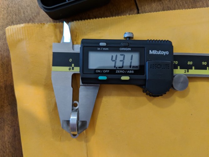

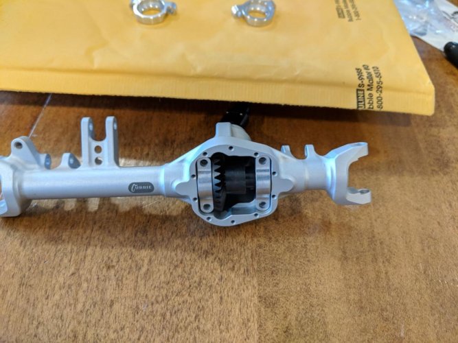

New bearing retainers
The short version is, the front assembly fits perfectly with the new bearing retainers!
Kudos to VP support for resolving this in 1 business day! Clearly my proximity to Sacramento didn't hurt, but still.
It drops into the front housing quite freely, while the rear assembly was a tight fit in the rear housing, so the rear retainers must be a bit out of spec as well (not worrying about that since it's all buttoned up now).
Notably, given the earlier discussion of bearing fit in the retainers, the bearings are a very tight fit in these. I was able to press one in by hand using the spool, but had to resort to a bench vise to get the other bearing into the retainer (at that point i was committed to making it fit one way or another!).
Out of curiosity I did mic the new and old retainers. The ones that came in the kit are a few 100ths of a millimeter thicker than the new ones they sent me.
Now off to get this built!

I'm also curious to know if anyone else has this issue. Just to make sure it's clear; I did not have to mail anything to Vanquish to get my issue resolved.
Maybe retake some calipers to all the bearing carriers & the housing.

If your measurements are correct (you are using a good brand of calipers) then VP's tolerances are insane. If that's the case these have to be machined on high end CNC machines or the issues are going to continually pop up. Even if the anodizing thickness is out of spec it'll cause issues with tolerances like these.
If more people understood this..... they might understand why there is always some slop in production models. And we would have less complaining about things.
This situation could be the exact opposite. A company being so precise that a change in season temperature in the shop could cause issues.
I would hazard a guess that this is a fluke.
rohrej- it would be interesting to see. Would you measure that retainer at room temp then toss it in the freezer and remeasure it. I'm just curious to see how much if any those changes might effect dimensions.
Took some more measurements at 72° F.
Freezing now...
