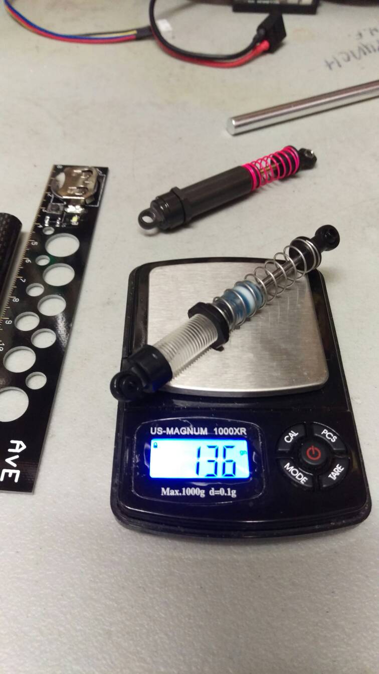

A whole new look!!!!!
And a little diet..lol

Thank you brother...I'm really liking the looks of these shocks..I need a little heavier er oil..but that and those krazedbuilds tuner pistons you sent should do the trick
Sent from my HTC One M9 using Tapatalk
My scx10 shock I run 50wt shock oil (Berg).
I really like those see thourgh shocks
Yes 50wt front and rear... not saying you'll like it. just what I've been running for a couple yrs. With my stock scx10 shocks after 10- 16 battery pks. I top off shock oil about 2- 3 drops per shock. Hopefully rcbros don't leak like mine.
I will post my findings...so far so good. But I'm having trouble getting all the air out...never had clear shocks before.lol
