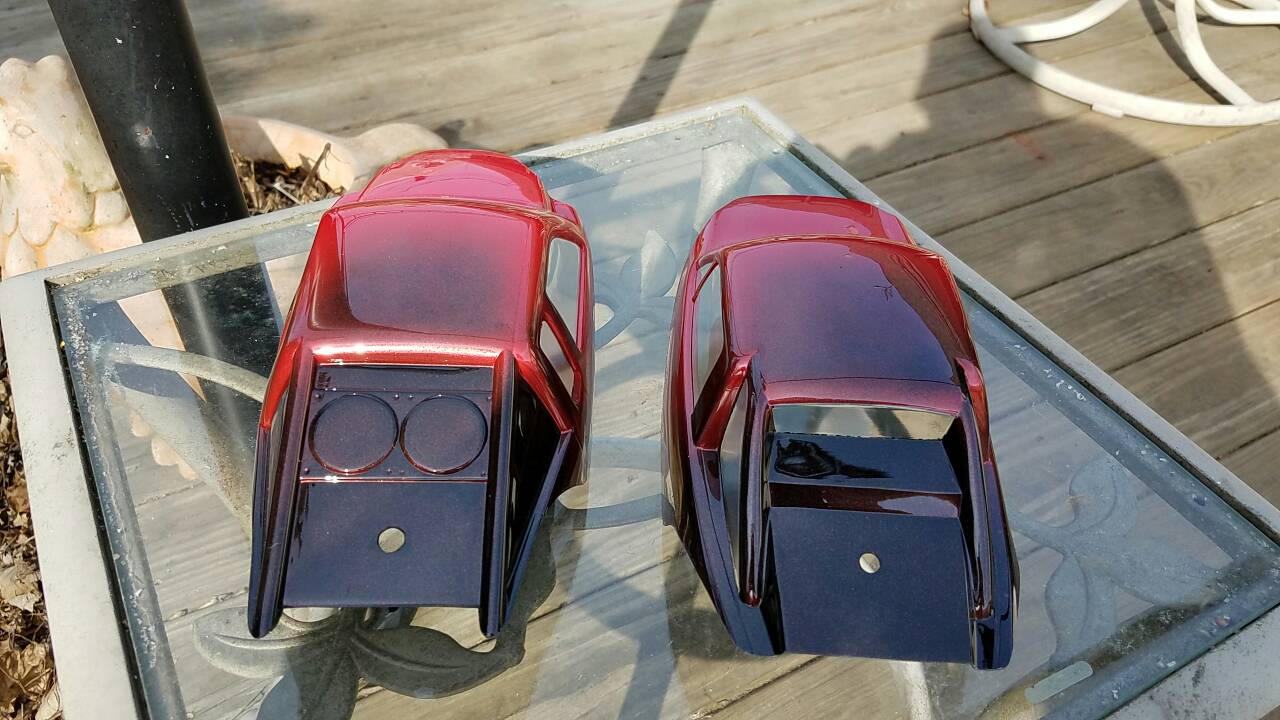

Finished both bodies. Unfortunately I can't test either on my back yard course. I took it down since we're moving in the beginning of April to PA.
Both bodies fit the same truck. I made a extra rear body post assy that's set up to work with the other body.

Thanks guys. The painting part I need to work on lol, I'm happy with my trimming work though.

Nice paint! Fade looks great, and the losi body looks super sharp. Whenever/if you have a spare moment, would you please provide me with an eye to eye measurement on your front and rear upper links? Ordering ti, want to make sure i get enough, and to have a starting point. I appreciate the help, and thank you!
