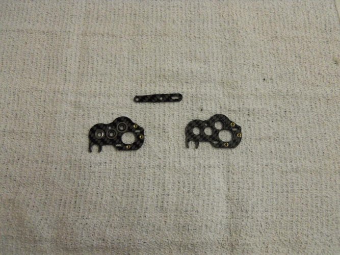

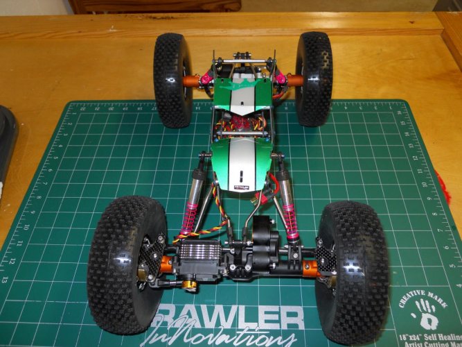

I crawled with the rig a little and decided to lighten the load a little bit. I am not looking to do a featherweight, would just like to get it right around 4 lbs. So I am looking to lose around 10 OZ. so here goes. I saw these motor plates on Purps thread and liked them instantly so I checked out Krazed Builds (Robbob) website and ordered these and the brace under the servo. These parts look even better in person and the fit and finish is excellent. Thanks Rob!!"thumbsup"

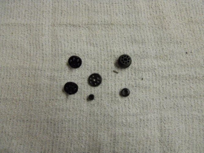

The next thing I decided to change were the gears. I went with RC4WD lightweight gears and added in Axial lightweight final gear for front and rear.

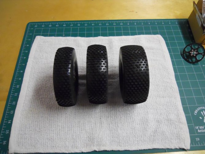

Just by the tire narrowing I saved almost 2 OZ. I cut and shut 4 narrow and 4 ultra narrow so I can try different combinations and pin trimming to see what works best. Also narrowed down wheels to .75. Included a pic of stock, narrow, and ultra narrow Voodoo for people who have never seen a side by side size comparison.

I know what many of you are going to say, You would save weight by getting rid of all the VP stuff, and I know that but I like that S#%@ so I am going to see how light I can get it with the VP stuff on it. I have a ton of stock XR parts and brass inserts so if I decide to change later I can. Just want to see how this works first.
Sold my HH Torquemaster Pro motors and had Holmes build me a set of Puller 400 motors. The weight difference by changing out the 2 motors is 162 grams. That is one massive savings right there!!:shock: The motors should be here by Tuesday so I will update pics next week. Also decided to change battery location to the front axle, not for weight reasons but it was a pain in the ass to change batteries between runs.
Happy you like them, Thank you for the support.
Rigs coming along good, hopefully get to go up against it someday.
Thanks man, it should be nice and tunable and it's nice to know I can change weight in either direction at that point.
Thanks Again, and I have the feeling you may see the rig in person this year. Now I just need to practice, A LOT!!!

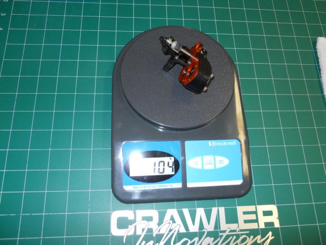

Transmission weight without light gears and carbon motor plate: 104 Grams

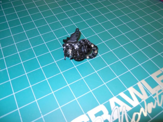

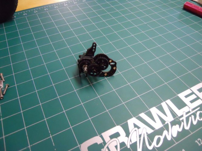

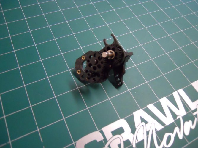

Tranny going together with new parts
