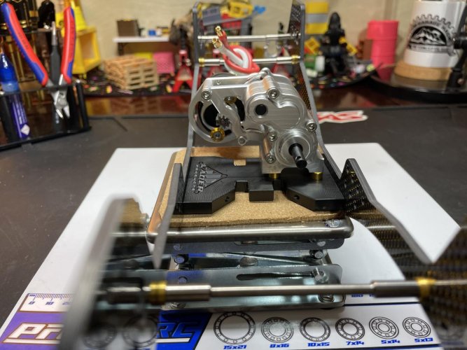

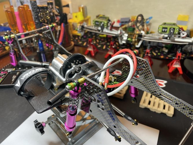

Worked on the Transmission and Motor mounting and finally was able to figure out the forward mount ON THE Trans but had to add 4mm spacers as suggested by TGH to give some clearance to the motor at least with the forward mount! Now the way I had it before without the forward extension it cleared and was lower but the motor is now way forward which is a plus for me but as soon as i get the axles mounted ill see what will and won't work but I hope I can keep the forward extension mount :)

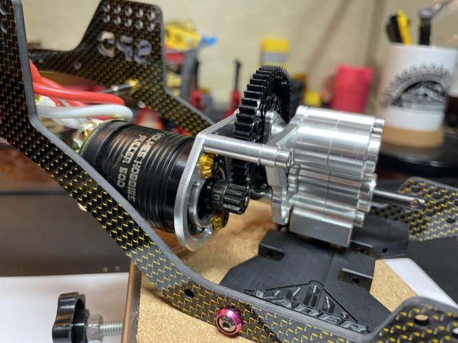

Finally go the 56t Spur gear in the mail and I got the spur installed in and had to add a sealed bearing to give enough space to have the spur match up with the pinion, but alas they are aligned perfect! Now the Supershafty Trans recommends a 9t pinion gear and 56t Spur gear and with my brushed motor the 9t was a little loose so I put a 10t pinion and it fits real nice snug and not too tight on the 56t!

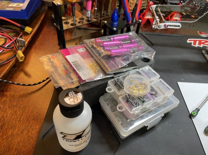

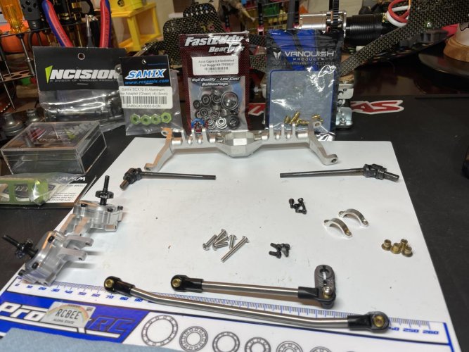

Working on the axles changing up the bearings and adding some SS screws and some Udder Budder Grease :). BUZZZZZZ.....

Got both steering axles cleaned up and put all new bearings & Udder Budder Grease & installed servos and servo cages!!!

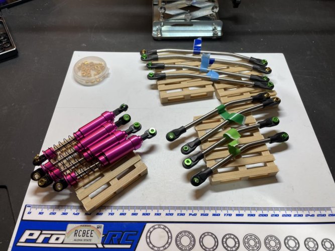

Links are done for the moment and hopefully this afternoon I can try to bolt everything up after getting the shocks setup :)

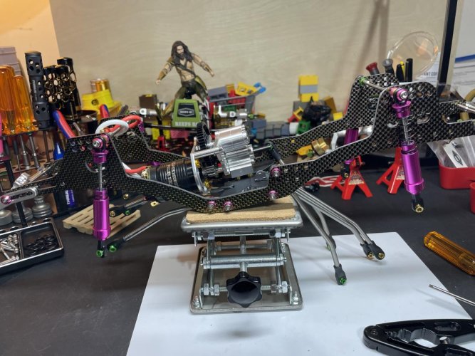

Shocks and Links are done & I moved the TPL Battery tray forward and think it will be pretty out of the way there after I secure it a little better & maybe I can get the chase set up :) BUZZZZZZ......

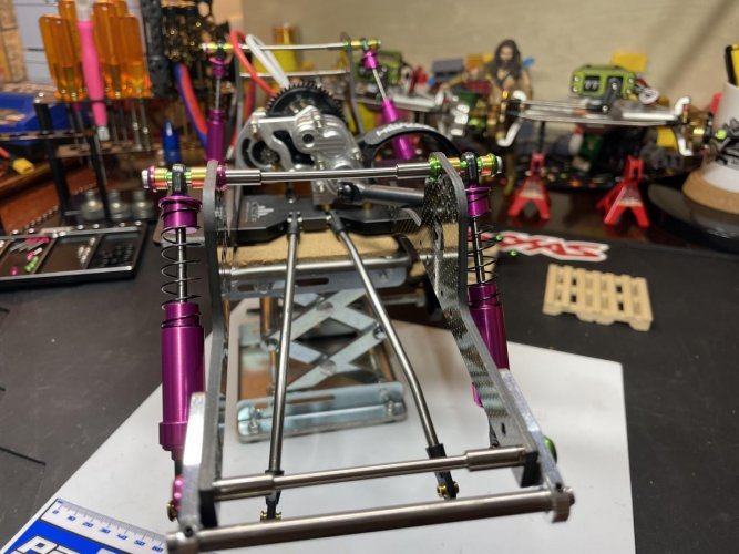

Got the Chassis going with the shocks and TGH sliders and the long links on the skid! Tomorrow install the axles and the last 4 links and start the electronics and Body next week :) BUZZZZZZZ........
