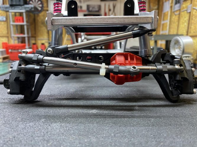

Well, I figured out the panhard link! It ends up I had the solution to my problem the whole time!:roll:
So, when I installed the front axle, it had the Bowhouse aluminum panhard bracket on it designed for the SCX10.3 panhard bar. With this setup on this chassis using the G-MD panhard bracket, the panhard link needs to be upfront of the axle instead of overtop of the axle. GSpeed makes an AR45 axle panhard mount that reinforces the weak stock panhard mount on the axle. I completely forgot that I had already purchased this mount for my other GSpeed build and I didn't use it.

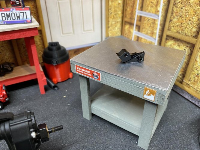

Here is the GSpeed mount that is needed to move the panhard link from the back of the axle to the front of the axle.
And here is a look at it with the panhard link mounted. It moves the link to the front of the axle so that there is zero interference with the axle when the suspension is fully compressed. So there is no need for a bent rod end like I thought I was going to need to clear the truss on top of the axle.
I did have to make a new panhard link. The link that was supplied with the Intheworks set was too long. I used a piece of stainless all thread and a piece of stainless tubing. The total length eye-to-eye of the panhard link is 95mm.
Here is a look at the panhard link with the shocks fully extended and fully compressed. I now get full compression without any interference from the axle or chassis rails.

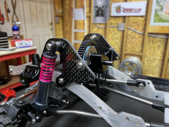

More parts and pieces have arrived. Last Wednesday the TGH FMM went back up for sale on their website so I jumped on it and picked one up. Also picked up the TGH CF FMM brackets for the V1-C1. Big thanks to @topherbuilds for the heads up that these were going on sale!"thumbsup"
Also picked up the Axial 56T spur and slipper pads needed to complete it.
Just look at these carbon fiber beauties mounted up! Man they look great!
Since I'm running the AR45's with the offset pumpkin, I had to mirror the FMM so that it would not interfere with the front driveshaft. Very easy to do. Just have to remove 3 screws in the FMM and reinsert the spur shaft in the opposite direction. By mirroring the FMM, you now have to drill new bottom mounting holes in the CF front shock towers. I went ahead and put an order in for the mirrored skid that TGH offers that comes with the drilling jigs needed to place the holes in the right location.

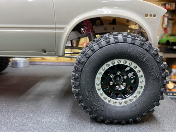

Since I'm super impatient, I threw on some wheels and tires to see how it would look with the body on. I noticed that the front axle is sitting to far forward in the front fender wheel arch. I'll have to measure the front links and see how much I need to adjust them to get them to line up with the body. The link set that I ordered was for the 11.4" wheelbase, but now I'm wondering if I ordered them for the wrong axle??? I'll have to go back and take a look at what I originally ordered.
Anyways, here's the pics with the body on.

Can you lengthen the upper links to clock the front axle and shorten your WB? or would the mess up your caster too bad? BTW looks badass"thumbsup"
Thanks cutlaSS!"thumbsup"
The axle is sitting dead nut where it should be, just to far forward. It would screw up the caster too much to do that. Once I figure out the length, I'll just cut more threads in the links and cut them to the length I need. Thanks for the tip though!"thumbsup"

I see. I'm not much of a tuner so that much positive caster is needed? I've been setting my trucks at or near zero, maybe I'll try adding some. Thanks
