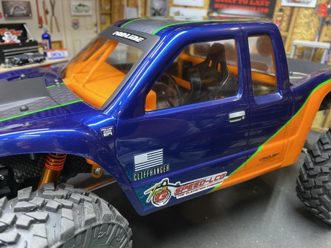

Looks damn good! The yoda sticker works perfect for a grille emblem
Thats awesome brian! U done a fantastic job. Wish i could get mine to come out that nice lol. Cant wait to see some action on the rocks
That may be the BEST comp-style paint job I've ever seen..."thumbsup"
The colors, masking, and decal choices are nigh perfect!
Paint is on point!! Great job Brian.

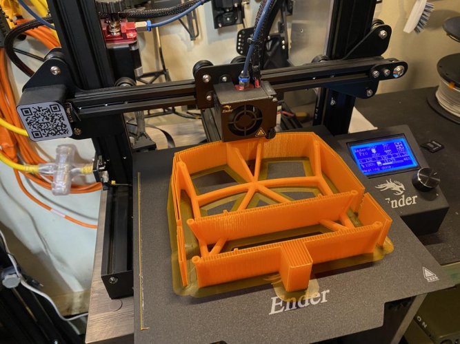

In the process of 3D printing a cage and interior for it. Downloaded the Harley Designs 3D files of the Cliffhanger cage and interior parts that Josh designed.
Still printing as I type, but here is a few sneak peaks.
I'll update more when I get the prints done."thumbsup"

That's pretty sweet.
Looks like your using cura slicer, can save time and filament setting your supports to "tree", allows the to get to some wicked places qhile only being attached to the build plate.
Sent from my SM-S906U using Tapatalk
Yeah I am using Cura. I didn't know that about the supports. I'm still a 3D print newb!:ror:
I'm all about saving time and filament! I'll give that a try on the seats I'm getting ready to print tonight. Thanks for the tip!!"thumbsup"

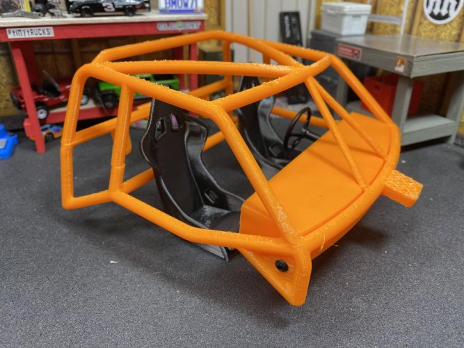

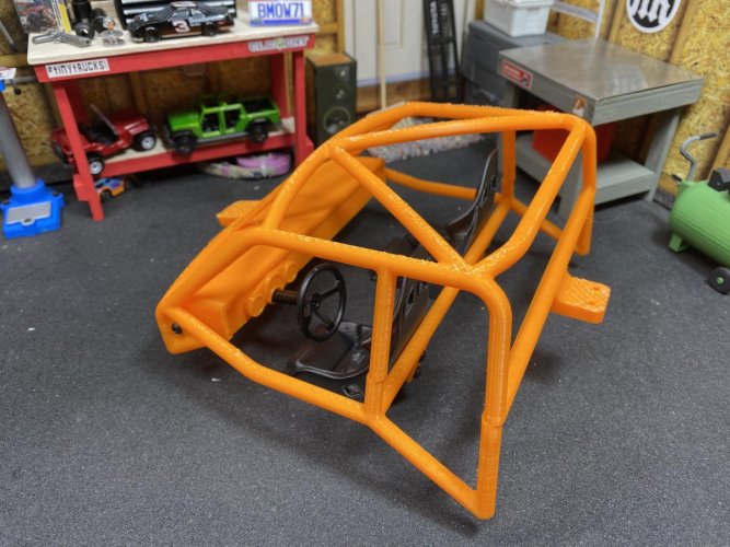

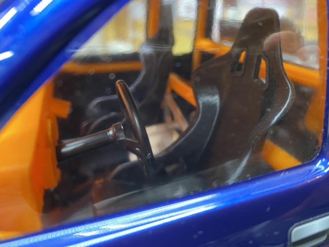

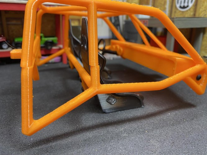

Got the cage, dash and seats printed. Switched to tree supports that @tigris99 recommended and WOW, big difference in print time and support cleanup! I used the tree supports on the seats and saved almost 2 hours in print time and cleanup was super easy!
Here's the pics so far. Still need to finish cleaning up the cage and dash and figure out if I want to paint the dash a different color. I switched to a different brand of PLA for the seats and am impressed at how well they turned out. The steering wheel is an Axial spare that I had. Probably modify it or replace it with something else once I fit a driver in there.
As you can tell in the pics, the cage is off a little halfway down. I screwed up and paused the print and when I restarted it, it looked to be off by about 1-2mm. Lesson learned!:x

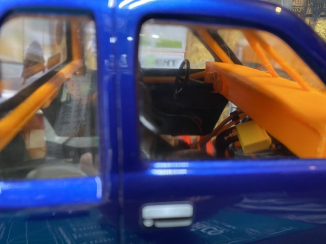

Drilled out the mounting holes in the body and installed with M2.5 screws.

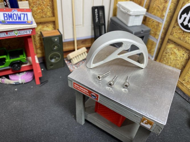

Had to remove the spur gear cover. The center bar that has the seat mounts was hitting the cover.
