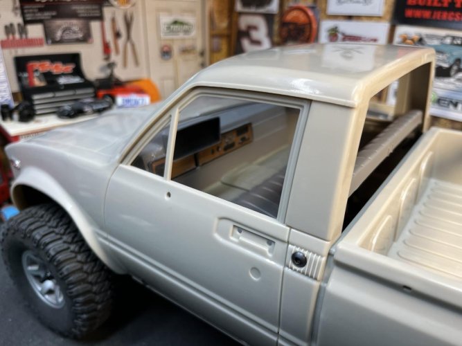

I decided to swap out the Tamiya Hilux body and Marlin bobbed bed for an RC4WD TF2 body kit. In order to haul the surfboards in the bed, it'll have to have a long bed. At the time I bought this body kit, Amain had a deal on this body kit that I couldn't pass up.
Instead of using the RC4WD square headlight grille, I'll be using the Tamiya round headlight grile. I like this grille and bumper better and will fit the look much better.

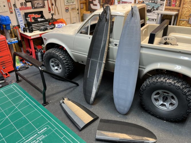

I 3D printed a surfboard rack that is bolted into the bed. I'll have more on that later.
A quick peek at the interior. I started painting and detailing it. Carpet and a seat cover is going in next.
And finally a look at the 3D printed surfboards that I will be using. The gray one is primed and sanded and still needs finished.

Before I decided to ditch the Tamiya Hilux cab, I paired it with the RC4WD TF2 long bed. I didn't like this cab because the door handles were molded in to the body and other little details. The TF2 cab allows for the the add on details that this body doesn't have.

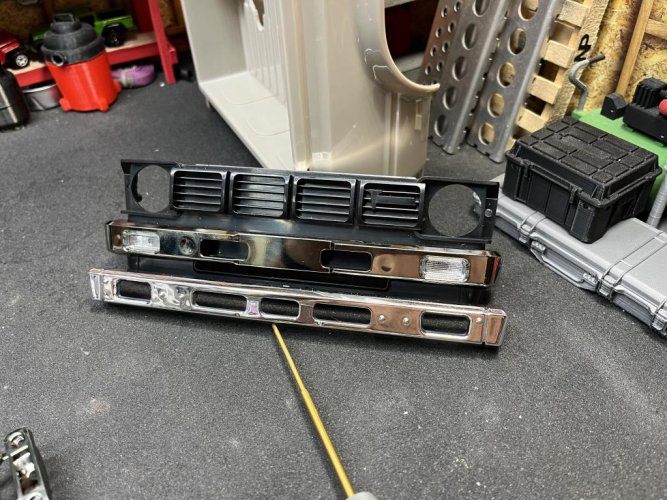

I picked up the Tamiya Bruiser parts tree for the bumpers. These bumpers look much better than the RC4WD bumpers that were supplied with the kit.
The second pic shows the difference of the front bumpers. The TF2 is on the bottom. It is a tad wider and doesn't have the front license plate cut out like I was wanting.

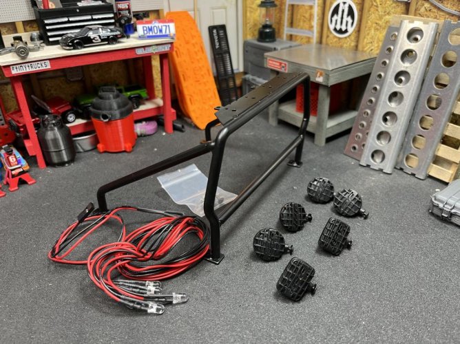

And I'll be adding a roll bar to the bed. Found this cheap, but nice one on the Amazon. Even comes with a light kit to add to the top to give this Hilux an '80's look.
Hey, Brian - you have a link for that rollbar?
Ummm... and maybe for those plastic wheels?
