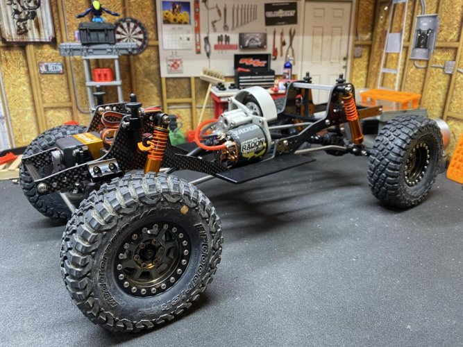

I got the G10 rails swapped out for the carbon fiber rails last night.

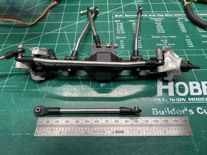

Also got the panhard link straightened out. Link length right at 100mm. Added a Jato rod end on one side. I cut about 6mm off of the Jato to get to 100mm total length.

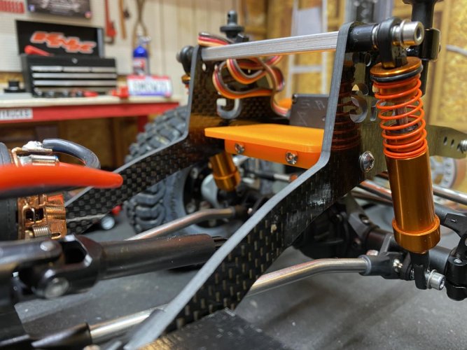

Pics of the beautiful shiny carbon fiber rails.8)

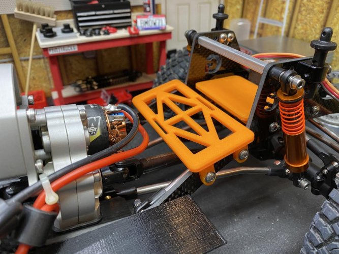

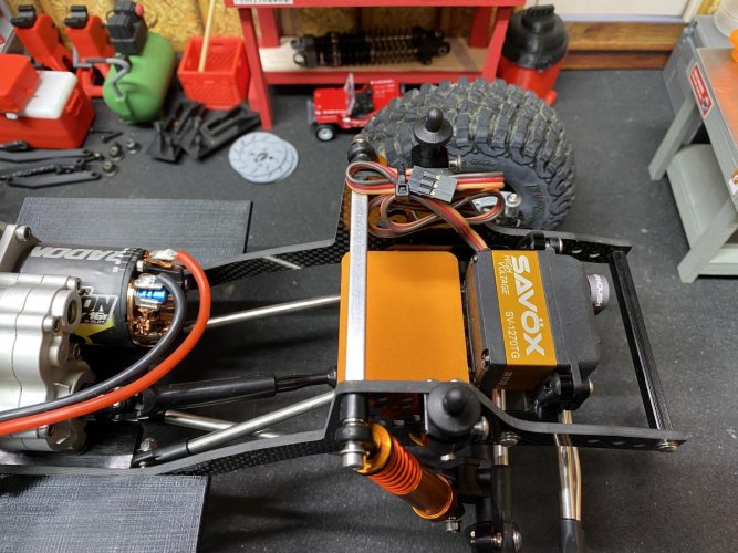

I was looking for a place to mount the ESC and reciever other than on the sliders. I headed over to Fushion 360 and whipped up this. I made it to mount to the laydown servo mount right behind the servo.
I drilled and taped a couple 3mm threads in the laydown servo mount to attach the electronics tray.

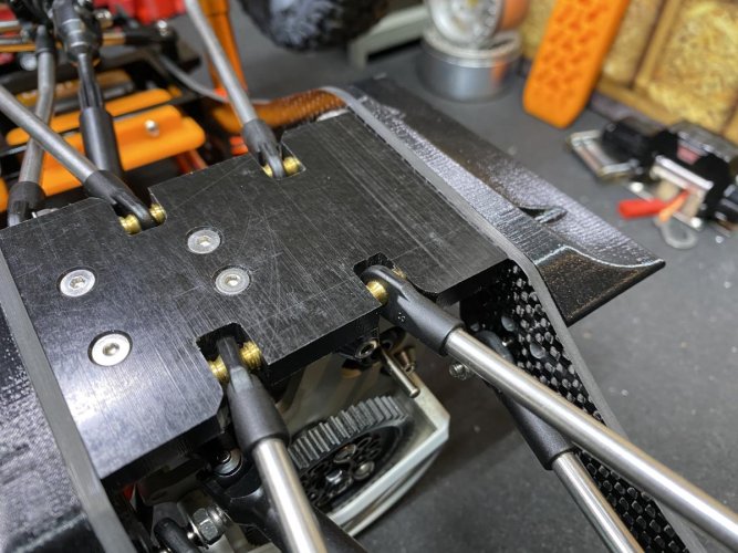

I didn't like how sloppy the stock steel link balls were in the rod ends on the skid plate, so lucky for me I had a bag of VP brass link balls in my spare parts bin. These brass balls are a touch wider than the stock balls, so I had to widen the slot with a file. The brass balls fit nice and tight and have zero slop now.
Hoping to get the electronics installed tonight. Also need to add a battery tray. I found one on Thingiverse that should work out quite nicely. More on that later.

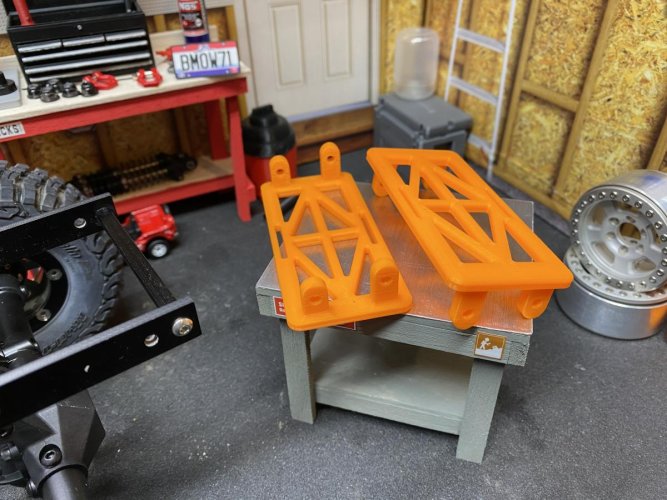

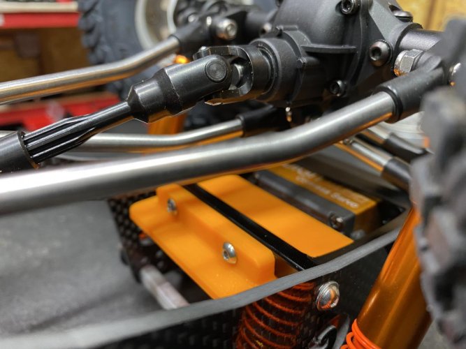

Spent some time in the garage working on the V3. Found a battery tray on Thingiverse designed by a fellow GSpeeder. It was an easy print and it looks like it will work out perfectly for this build.

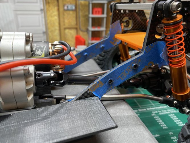

Marked the holes for the battery tray and drilled away. Man, these CF rails are tough to drill. I pre-drilled slow and steady with a tiny bit and then re-drilled with a 7/64 drill bit. Ended up burning up 4 drill bits to get to get the job done! I should have taken the rails back apart and drilled them in my drill press, but wasn't in the mood to dismantle everything again!

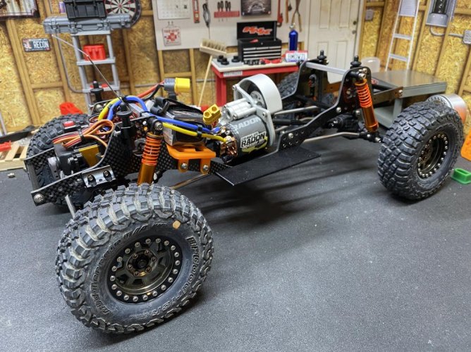

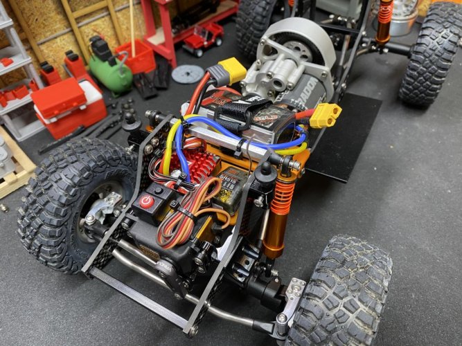

And now a look with the electronics installed. Using the Hobbywing 1080 and a Spectrum SR515 5-channel receiver paired up with my DX5C. Still need to work on better wire management and get the antenna secured.
I like that most of the weight of the electronics is up front over the axle, but it also puts the weight higher up in the rig. I guess I'll see how it performs and see if the electronics will need to be moved down to the sliders.

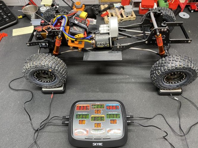

Here is a look at how the V3 sits for weight. Not bad, but need to get to at least a 60/40 front to rear. I still need to add a front bumper, so that should help out getting more weight up front.

The battery does fit good, but I had to use about a 2mm spacer on each of the front mounting tabs since the rails get narrower toward the front of the chassis. You should have better luck drilling the G10. The carbon fiber is tough stuff!

Side note: I designed this around the Savox servo that is currently in the rig. It is smaller in size than a normal size servo, so not sure how the tray will work with other servos. I didn't think about that when I drew it up!:oops:
