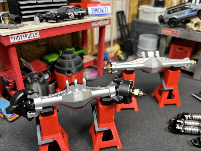

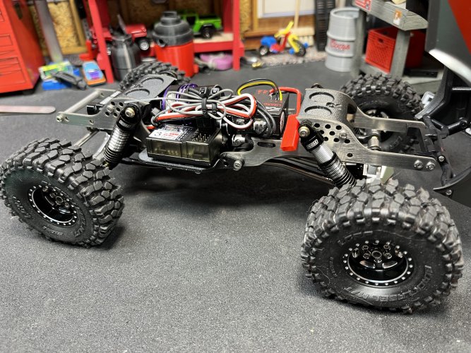

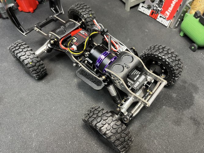

First mini build is using the TRX4m platform. The is using the new Desert RC Stinger Jr. titanium chassis kit. I saw this chassis on YouTube and really liked how it looked and performed.

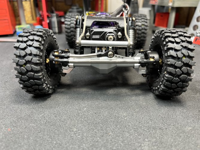

It has the MEUS Isokinetic 52 degree TRX4m aluminum front and rear axles. Super nice axles with a great steering angle. Very well made and are very smooth. The shocks are the Injora 59mm with 20wt fluid. These little shocks are very nice and smooth. Injora steel driveshafts attached to an Injora CNC aluminum transmission.
Furitek Lizard Pro ESC and an Injora Fat Viper 2000kv motor. Injora aluminum case coreless micro servo with aluminum servo horn. Radiolink 6-channel receiver bound to a RC4GS transmitter.

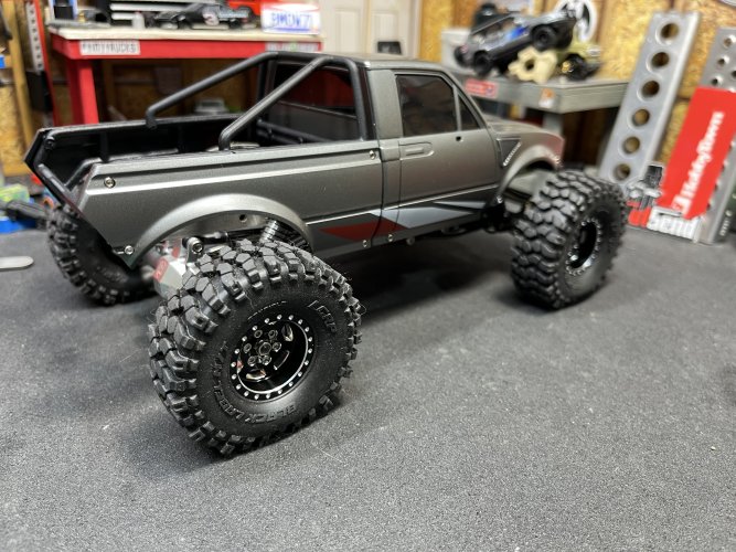

LGRP Black Label 63mm tires wrapped around a set of Injora yellow silicone inserts mounted on a set of Injora aluminum wheels.

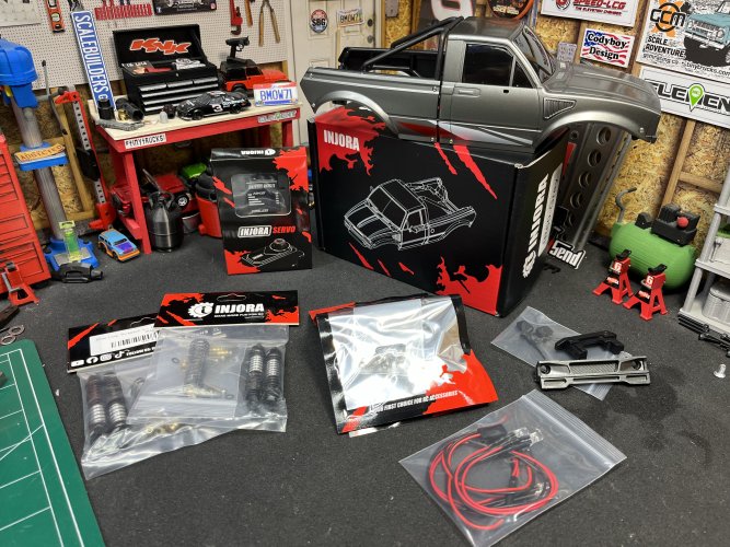

Body is the Injora IR60 hard body “Toyota” with rear bed cage. I’m still undecided on a paint color.

Agreed, it’s a sweet little rig. I picked up a x4m bronco a little while back. Put the same Yota body on it, the fit and finish on them is so nice. Love those axles, Meus has produced some incredible stuff for the minis. It’s so nice it’s been drawing me into that world.
Thanks smog! Glad to hear you're headed in the direction of the mini's. Now that the aftermarket has gone full on into the mini's, it makes building these fun. MEUS, Injora and others have stepped up their game and are making some incredibly small and great products. It is the perfect time to get into these little guys.
Very nice! I've had excellent results with both Meus and Injora on my minis. Love the body, it looks mean on there!
Thanks OSRC! The body has some great detail for being smaller. Injora has come a long way quickly with their products and quality. MEUS products are top notch too.
Nice build love that body. I find some of the injora hit or miss. Those injora shocks look nice though similar to the proline big bores which I love .
Thanks! These Injora shocks are nice. And for there size they sure are built nice and are very smooth.
Yep that's a bad ass little build!
Thanks!👍🏻
