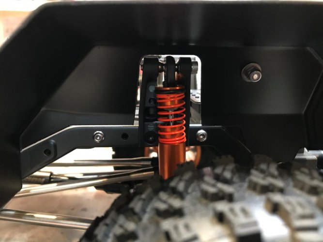

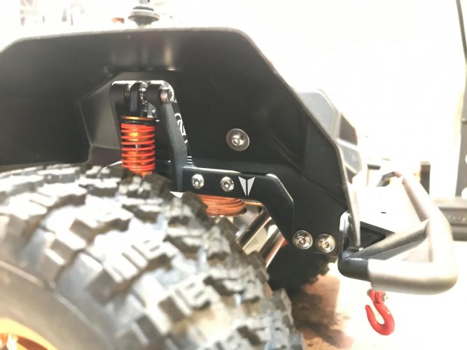

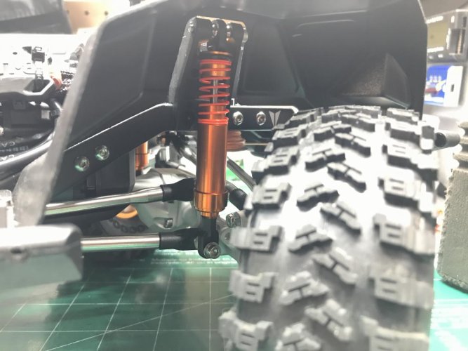

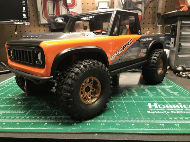

I spent some time tonight working on the PRO. Earlier in the build I had installed the Dravtech shocks, but did not like how soft the springs were. The springs that I was using were way to weak and would not hold the weight of the PRO.
I placed an order for a set of LOSI Mini-T front shocks springs. They come with three different spring rates: soft, medium and firm.
After comparing the springs, I determined that the black spring I was using compared to the pink soft springs. So I decided to go for the stiffest springs and used the orange firm springs. I also added one o-ring to the spring to give it a little more tension.
I first mounted them up to the front axle since most of the weight is up front. Looks and feels much better. The firm springs are just strong enough to hold the chassis up and still give me a little droop.
Installed the rears with the same firm spring and o-ring.
I had to mount them upside down because the spring cup was in the way to mount the bottom shock mount to the link mounts. Since the top shock mount uses a rod end, it give plenty of room to mount them to the link mounts. And if these decide they want to leak (I really don't see these ever leaking), the oil should stay in the shock!
With the body on and battery in place, the ride height looks pretty good. There is about an 1/4" up travel left and keeps the COG down as low as I can get it.
Once I get the PRO out on the rocks, I will decide if these firm springs are going to work or if I need to come up with another plan.
That’s a real nice rig right there. How do you feel about the beef hooves?
Thanks TB!"thumbsup"
These new Beef Hooves are extremely nice. The quality is top notch and are a breeze to mount up tires. The tire bead fits into the exposed inner ring very easily. Since there is no "real" inner ring, it makes it a lot easier to align the foams and tire on the ring and bolt up. After they are bolted, the bead is extremely tight and I have not seen any slipping of the bead. Also completely water tight. I do not vent my tires, so I like that they are completely sealed.

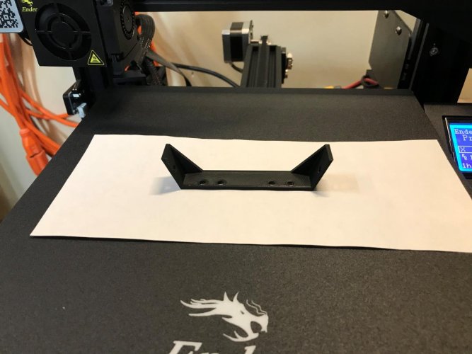

Big thanks to @GA Dawg for sharing the 3D printer inner fender braces files!"thumbsup"
Me, the 3D printer noob, was able to print these out on my new Ender 3 Pro printer without any problems. The prints look great and they fit like a glove!

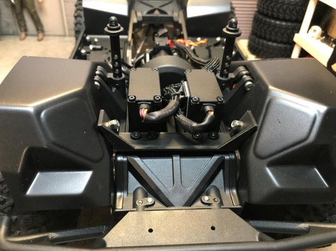

The front brace bolts in using the front screws of the servos.
Attached with a screw and washer inside the inner fender and a nut and washer on the brace.

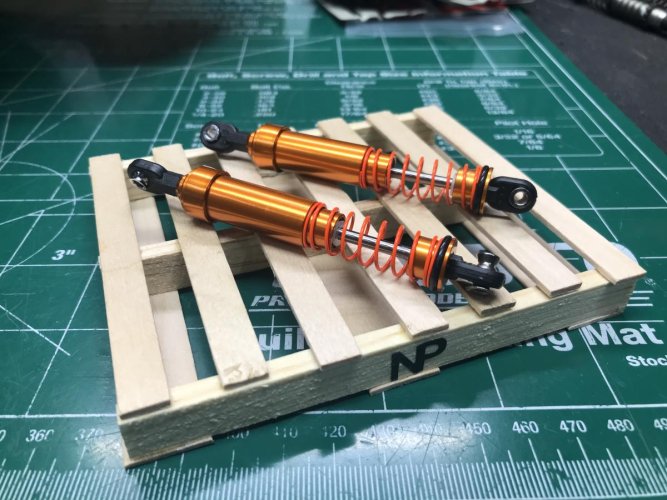

Those gold shocks look great and they match the rig! "thumbsup"

Thanks! I really like the way the Dravtech shocks look and feel. They are really smooth!
