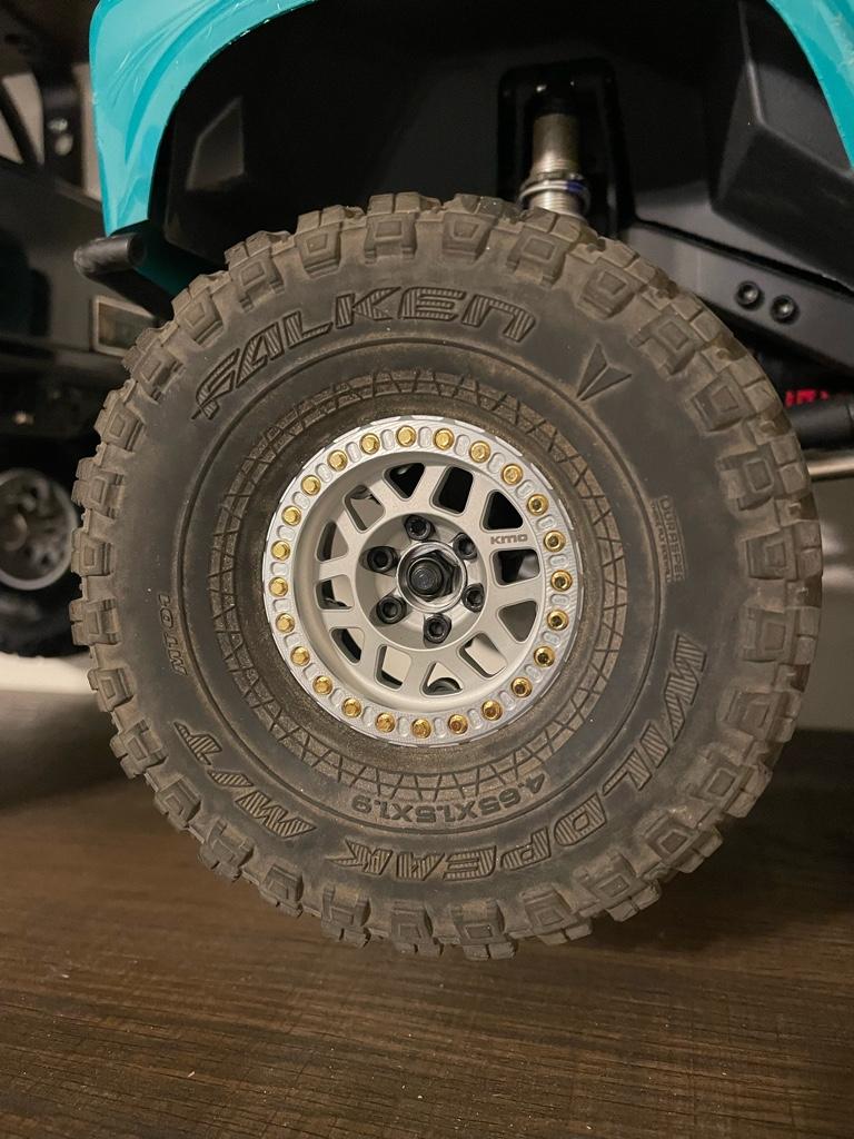

Small update, working on a beadlock ring and hardware change.
New wheel ring and hardware looks great! Nice outdoor pics in your previous post. Looks so good out on the rocks!"thumbsup"
