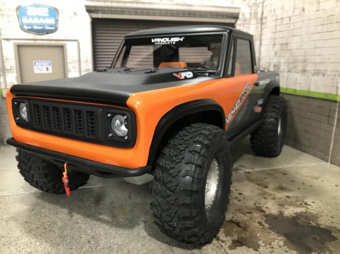

Here is a few sneak peek pics! Seems like that is the trend now with all the manufacturers, so figured I would try it![emoji23]
Really though, I was able to get a tiny bit done tonight on the Pro. I’m hoping to wrap the body up tomorrow night.
Looks super!! The paint lines are clean!!!! That's something I have problems with!:oops: And I like your color , paint scheme!! Classy!! Yep I agree we'll have to run some trails at the frosty run for sure!!! Great job brian!!!
brian
Very clean paint work! Love it BMow.

Thanks guys!"thumbsup"

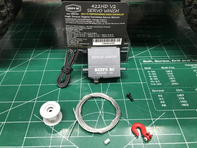

So I will start out with pics of the servo and servo winch I chose. I went with a 3Brothers G13 steering servo. I have one in my TRX-4 and have had good luck with it so far. It is extremely fast and powerful. I'm using the VP 20mm servo horn because that is what VP recommends and it has worked out well on my Origin. (Nevermind the Dravtech shocks. This pic was taken before I replaced them with the stock Incision shocks.)

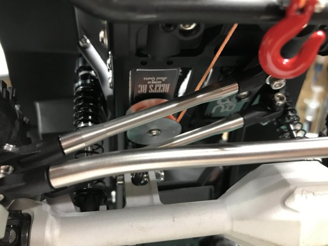

I chose the Reefs servo winch. This purchase happened out-of-the-blue when RPP posted that these were now in stock and available. It comes in a complete package that includes the CNC machined spool, silicone coated steel braided winch line & hook. I've been curious to see how well these winches work, so I will soon find out! I also decided not to use the steel line and went with the ScalerFab 300lbs. winch line.
I like that the winches have the winch controller built in and do not require and extra ESC to run them. Saves space on the chassis and relieves the headache of installing an ESC and programming it.
The CNC spool was too tall and hit the panhard bar, so I had to use a LockUp RC spool. I also had to shim up the winch servo a tad with a washer so the spool would clear. I get full compression with just a slight rub from the upper link on the axle only when the RH tire is fully compressed. It is slight and should not cause any problems.

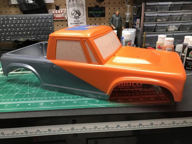

Taped off the windows, sunroof (Need to give credit to Matt from Scale Builders Guild for this idea!) and back half of body. I used Tamiya PS-62 Pure Orange for the front half and backed it with a coat of Tamiya PS-1 White.
Back half was sprayed with Tamiya PS-63 Bright Gun Metal backed with white.
The film on the outside was lightly and carefully cut to expose the hood, top, rear section and fender flares. It was sprayed with Tamiya PS-5 Black and backed with multiple coats of Tamiya PS-55 Flat clear to dull the black and help protect it from scratches.
Removed outer film and window tape and this is how it came out. I'm happy with the results! I'm glad bodies these days come with the outer film. It works out really well for painting on the outside of the body without using any tape. The film seals nicely and does not allow for any paint bleed.

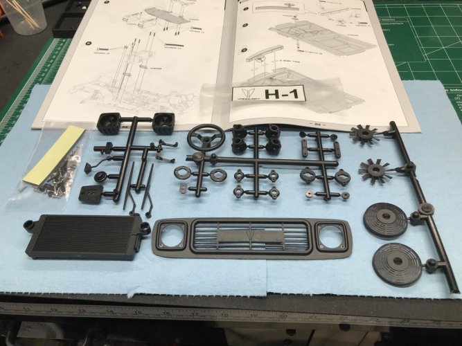

Now it's time to open bag H-1 that has the body parts such as the grill/radiator, light buckets and more.

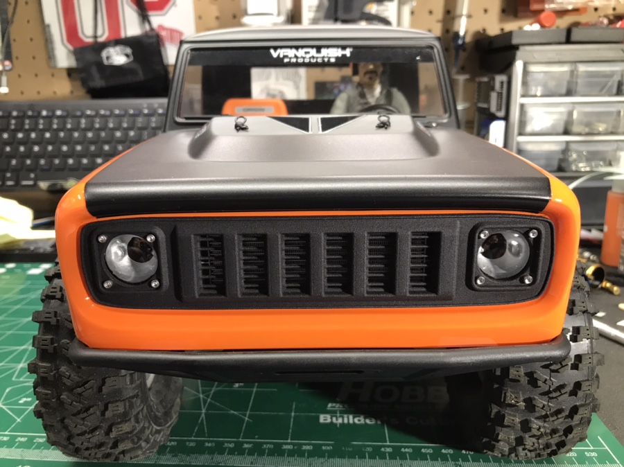

I decided to go with the grill made by Scale Built that I bought on Shapeways. I wanted more of a "Scout" look on the PRO. It is made out of a black nylon plastic with a matte finish and has a fairly nice smooth finish to it.
Since this grill has nice big slots in it, I thought the radiator would look good painted silver. I used a silver Sharpie to coat it the best I could.
Here is a shot of the front end with the grill and radiator attached. I like how the silver rad looks behind the grill. It adds a little extra something! Oh and I also used the silver Sharpie to paint the front and rear light buckets. I don't have a light kit for it yet. If I don't make my own set of lights, I will probably either get the Powershift RC light kit or the LIT LED kit.
Side shot without decals!
Don't pay attention to the wheels. They are temporary and will be replaced with an awesome looking set of wheels that are in the mail and should be here this week.

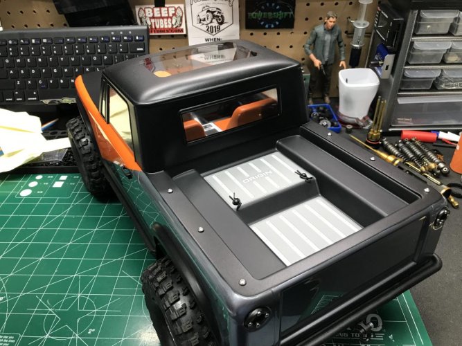

Here is a shot of the rear bed area. I cut the overspray film on the body around the top edge and sprayed it black to match the interior. I wanted the black to flow from the front of the hood all the way back to the rear of the bed.

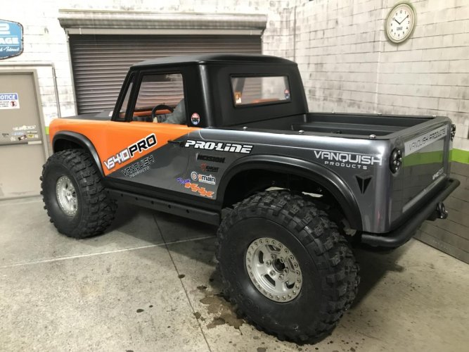

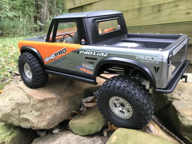

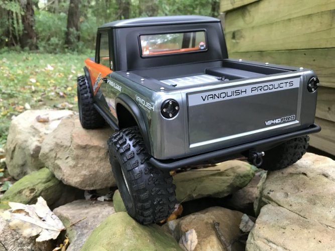

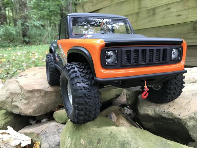

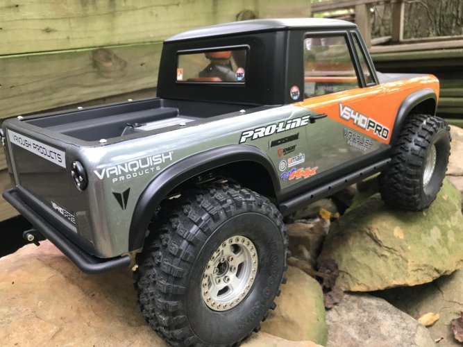

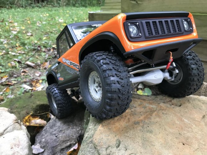

The long wait is over and I can finally reveal the pics of the PRO at it's first photo session! I didn't have time take it out for it's first run, but I was able to do some "poser pics" on a pile of rocks in my yard.
Enjoy!:)

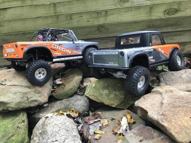

Here is a couple pics with my Origin.
And a few more after I parked it in the garage!
This was a blast to put together. These kits are by far the most enjoyable to assemble. The quality and craftsmanship that VP puts into these kits is outstanding!
Looking forward to getting the PRO out on the rocks and really seeing what it is made of. Having driven the Origin for a year now, I'm pretty sure what I am about to experience! The Origin has been a dream to drive and I'm sure the PRO will be even better!

I’m really happy with how they look and perform. I’m hoping to get the PRO all finished by next weekend. I will be attending a SORRCA comp next Sunday and plan on taking the PRO along to get it first run in and see how well it performs on the rocks.
Man is that ever a clean looking truck!! Stunning. This is why I don’t know if I’d buy a vanquish truck. They’re so damn nice I don’t think I could run it and scratch it all up. Especially those axles! Nice work man
Thanks hibbs! I appreciate it!"thumbsup"
Yeah, it took me awhile to get my Origin out on the rocks. Those were my very first VP Currie axles and I hated to scratch them. I'm really glad I got passed that because these rigs perform very well. And actually the scratches don't look to bad. They are pretty much just surface scratches and add character to them.:)
