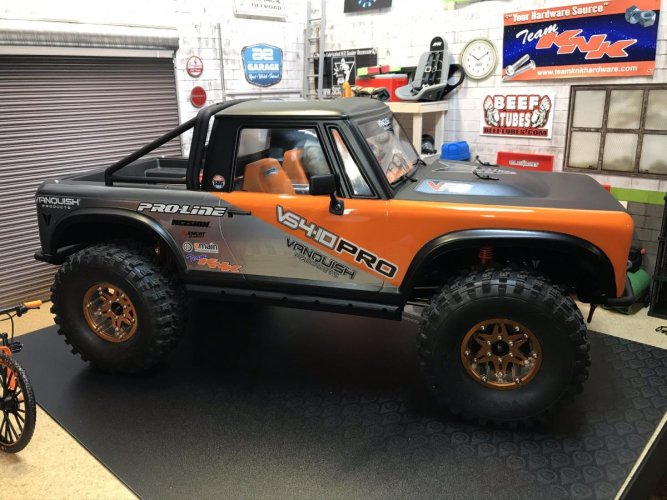

B-MOW goes PRO with the VS4-10
Everything looks just incredible B-mow. 1st rate on everything. The kicker for me is the keg of Coors Latte the little dude is holding! AWESOME. Need one to put in the back of my Ultra!

Thanks! I appreciate that!"thumbsup"
Ha Ha! I see you spotted my brew! No garage is complete without a keg of ice cold beer! In my case, Coors Light!

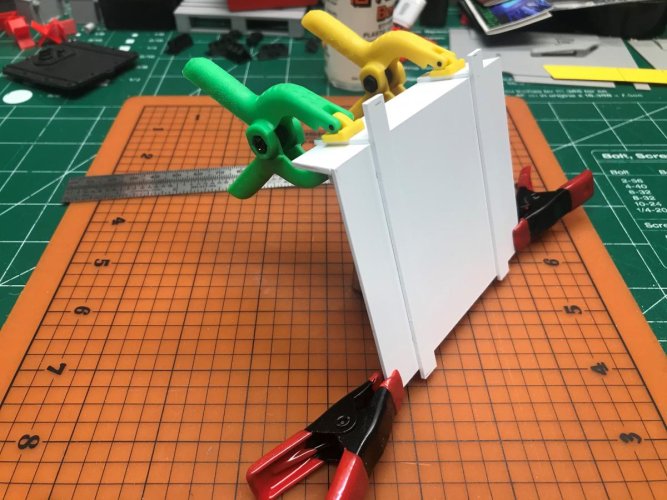

And now for the last item that I installed. I decided to fabricate a fuel cell out of styrene. All credit for the design of the fuel cell goes to RCC member @J55TTC (RC Adventure UK). I want to give a big thanks to him for posting this awesome idea in his build thread. Here is a link to his thread:http://www.rccrawler.com/forum/1-9-scale-rigs/610987-410-pro-build.html

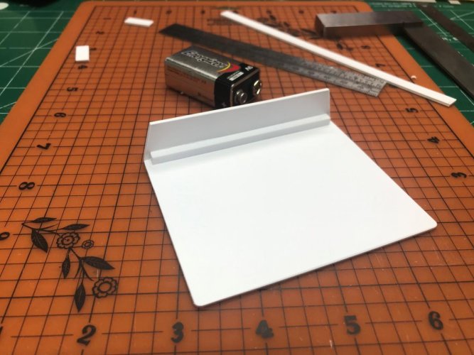

This is my very first attempt at working with styrene, so please be kind!:) Just kidding, all criticism is accepted! This really is a very simple styrene project and I'm hoping this will kick me in the butt to start working with styrene more in the future.
The fuel cell filler piece I 3D printed. I found it on Thingiverse, but at the moment I cannot remember who shared the file. Big thanks to whoever designed it and when I figure out who did I will add the user here.
Here are the pics of the steps I took to make this piece:

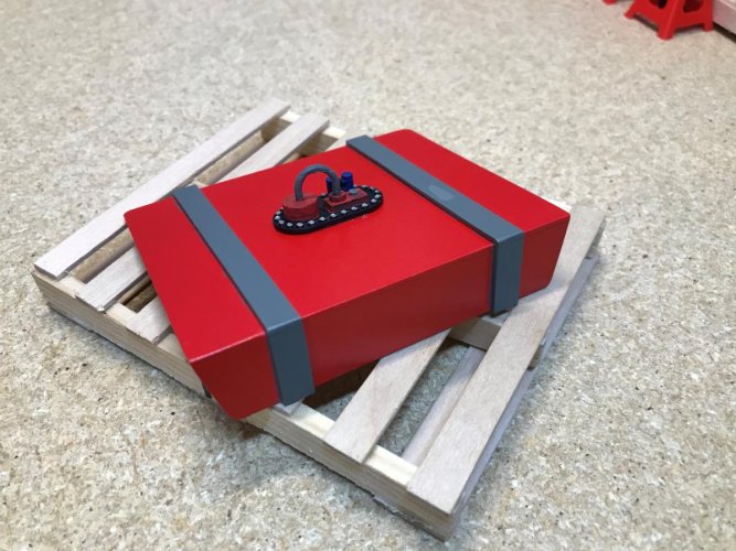

And here is the finished fuel cell. I used Rust-oleum 2X Ultra Cover Satin Apple Red and hand painted the gray straps and fuel cell filler with cheap Walmart craft paint. I then added a couple coats of Tamiya PS55 Flat Clear to seal everything.
I used rare earth magnets glued down with E6000 to hold the fuel cell in place.

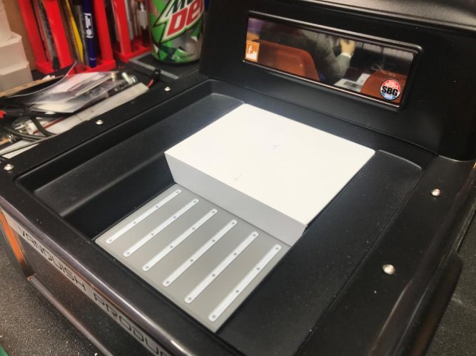

Here is the fuel cell installed. The purpose of this is to hide the body clips and also serve as a fuel cell scale point. The piping on the fuel cell filler will be used as a handle to remove the fuel cell from the bed of the PRO.
All in all I think it turned out ok. I'm looking forward to doing some other more sophisticated styrene work in the future.

That fuel cell is spot on! I haven’t used styrene in, oh 44 yrs? Yeah, it was 6th grade and I built several WWII dioramas. That was fun!
I see so many great builders doing absolutely fabulous work with styrene. I’m going to try my hand a tube fabrication on my SCX-10 II build.
Anywho, terrific work!
Cheers

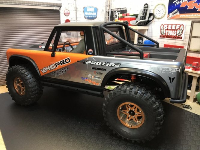

A tiny update on the PRO. I've been wanting to make a roll bar for the PRO out of some brake line and try my hand at brazing, but I never had the time to sit down and figure out how to make one.
So I recently ordered the Knight Customs roll bar designed for the VS4-10 PRO on Shapeways. After about a 2 week wait, it arrived.
I really like the way it looks bolted on. I've always thought that the rear end needed something so that it didn't look so plain.
It will work for now until I can get myself motivated enough into designing, bending and brazing a real metal roll bar!:)
