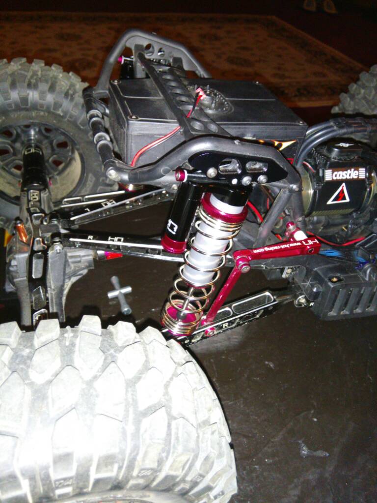

RPM lower A arms installed.

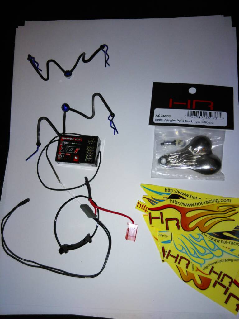

Today's upgrades
Traxxas stability system receiver
Traxxas telemetry
Hot racing danglers
Hot racing body leash for body and battery trays
Hot racing stickers
Last not in the pic lead tape for balancing the tires

Today's upgrade HR piggyback shocks. Have to wait till next week for the other 2 shocks. Wife's getting mad all the money I keep putting in this truck. Only $250 more and I'll have everything Hot racing makes for the yeti. Minus front arms I'm keeping them RPM.

Does the hr upper links have a lip to hold body up like stock ones do? Is there any slop in the pivot balls on the hr upper/lowers?
I was going to order some vp titanium links for uppers but not sure if revo or rpm rod ends would hold up to 4s/6s. Plus I dont think those links would hold the body up in rear either.
I cant stand the slop with plastic and plastic pivot balls.
There is no lip to hold the body up. That's why I have that orange aluminum spacer sticking out of the truss it holds the body perfect. And yes HR links take slot of slop out. The truck is very solid with all the HR Aluminum

Your Yeti looks great. I haven't considered the slop in the rear being an issue, I've been so focused on the front. As much as the rear end slams around while getting on the throttle it seems like reducing that slop could potentially prolong the ring and pinion life. I have no idea if it would, I'm not a mechanical engineer.

Today's upgrades
Traxxas telemetry
Hot racing danglers
Hot racing stickers

There's not much slop in the front anymore. I replaced the bell crank, steering link, and turnbuckles. I added shims to the front axels and removed TON of slop there.

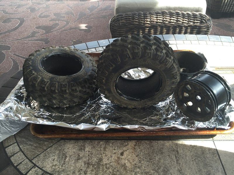

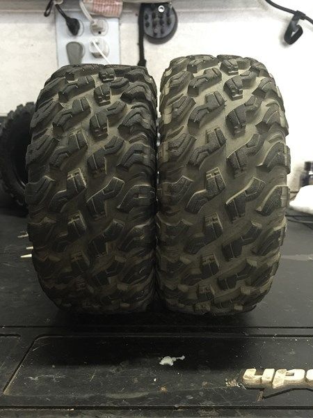

Post up what you think of those CI foams. Will the tires still need taping inside to help with balloning or will the foams pretty much take care of that?
What are you guys doing to balance your tires? Sticking weights on the outside inner rim?
I have not run them yet as I want to give the glue a day to dry. But I can tell a huge difference between them. With the CI foam, the tire is Flat across the tread, vers a peak in the middle with the stock foams and the sides of the tire is now very well supported. The tire has little give compared to the stock foam. I'm only running 4S so I do not have much ballooning.
