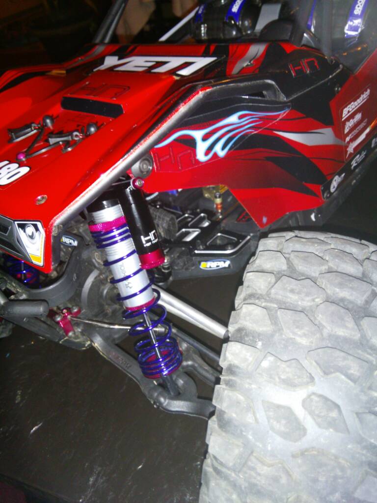

Today's upgrades hot racing front piggybacks

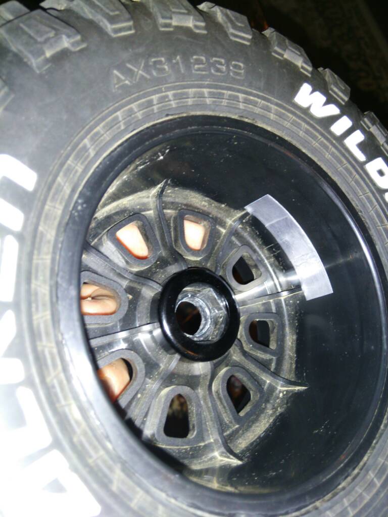

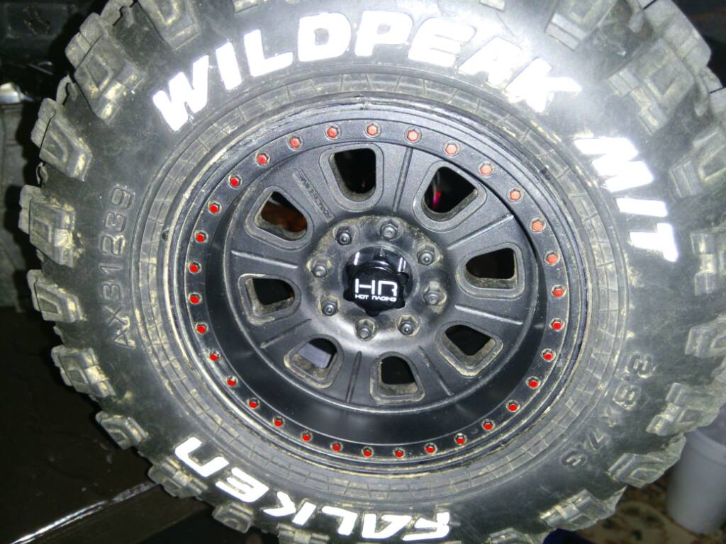

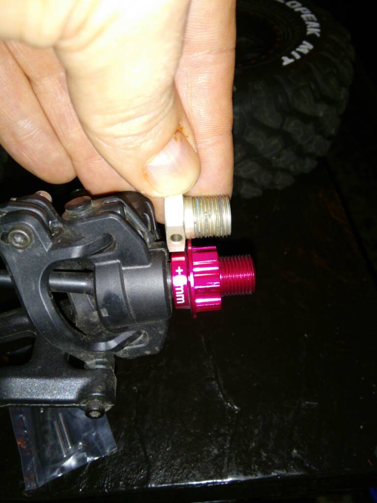

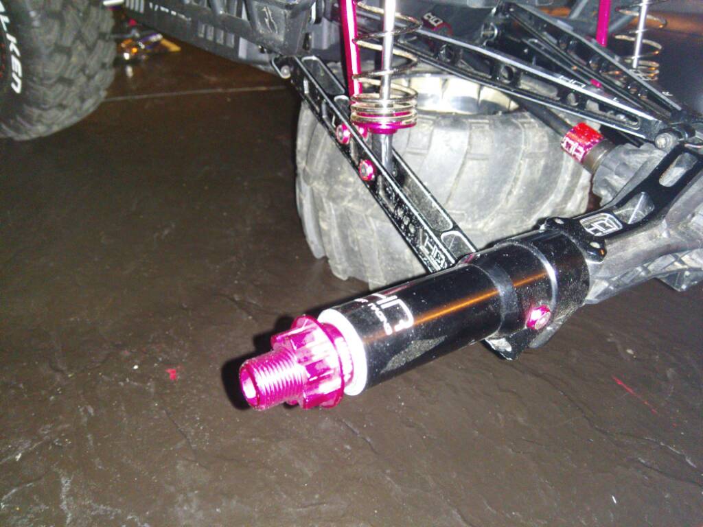

Tonight's upgrades Hot racing +8mm hub for the kit not rtr
Sent from a galaxy far far away

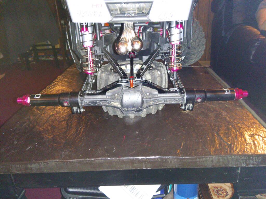

Installed

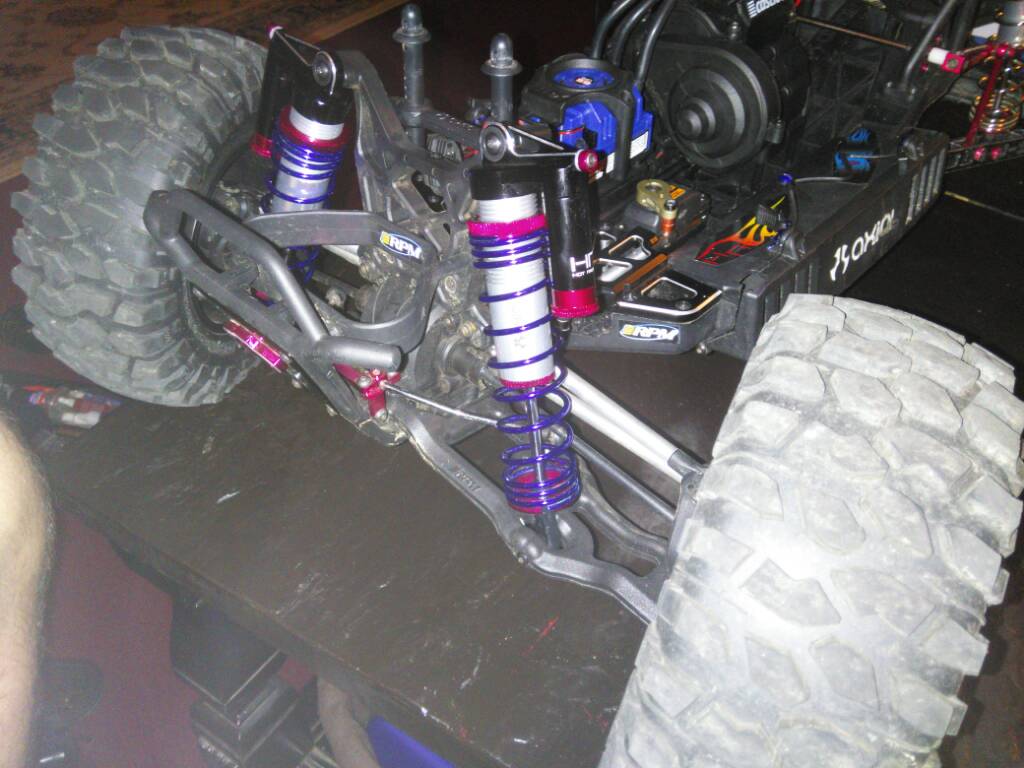

Greg - are you running stock hinge pins in the rpm a-arms? And doesn't the shock bolt need to be longer or something? Mine should be here tomorrow.
I am running stock hinge pins mine fit perfectly. RPM gives you a longer screw for the shocks in the bag.
Just installed rpm a-arms and they are awesome and beefy. Stock hinge pins fit good and a-arms fit tight as well. RPM doesn't supply bolts for shocks, so you will need M3x25mm button head for it.
In the second pic the ring support around the wheel hex will greatly reduce the chance of stripping the wheel. That ring fits really snug. Also after I installed it you really can notice a wider stance. That will help with roll overs and handling.

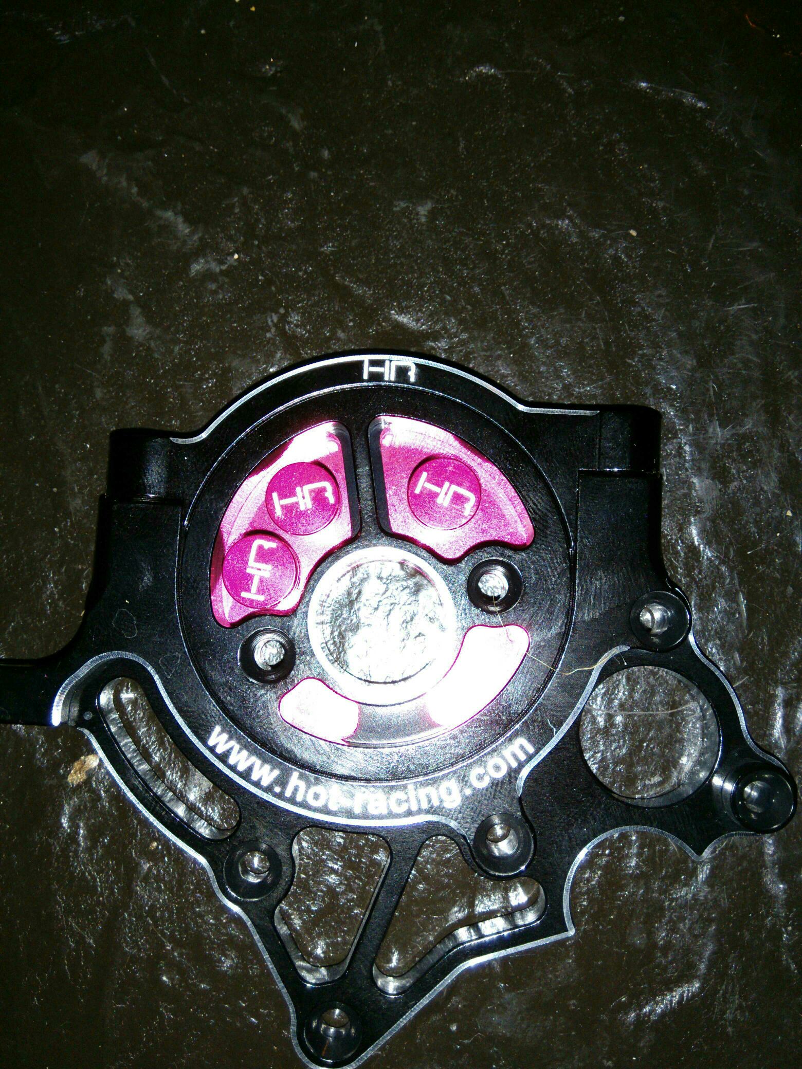

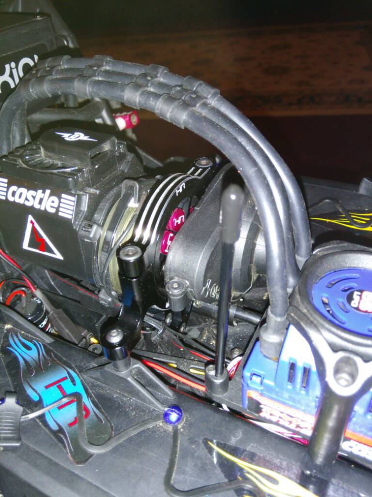

Put the motor plate in the motor mount then put the top clamp on and see if yours has a tiny gap on both sides between the motor mount and top clamp where the 2 bolts go. Wondering if yours has this gap as well and if it's just how there made.

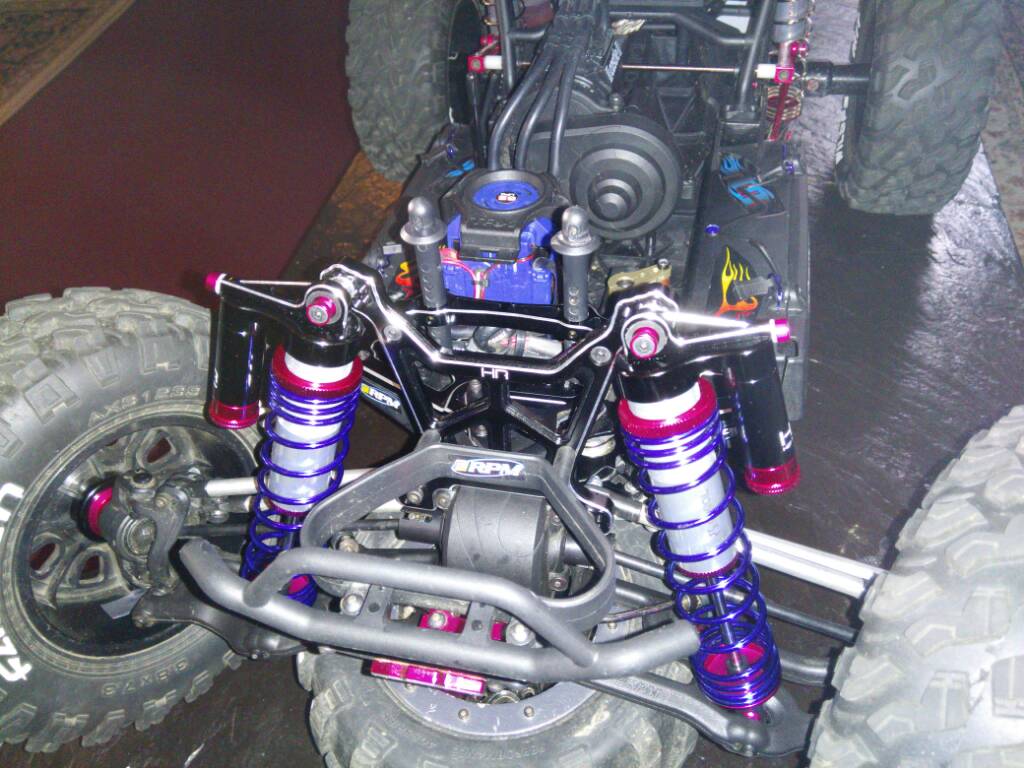

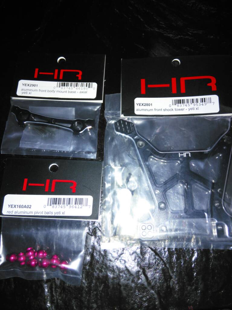

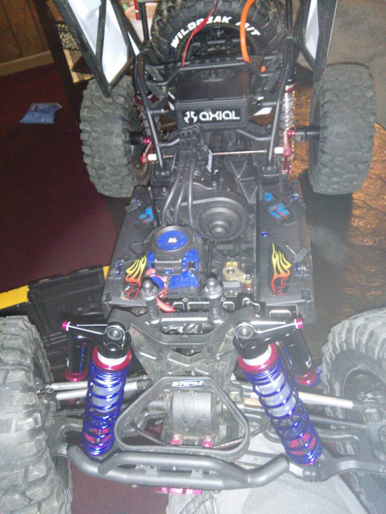

Today upgrades hot racing front shock tower hot racing body mount and aluminum pivot balls
Installed

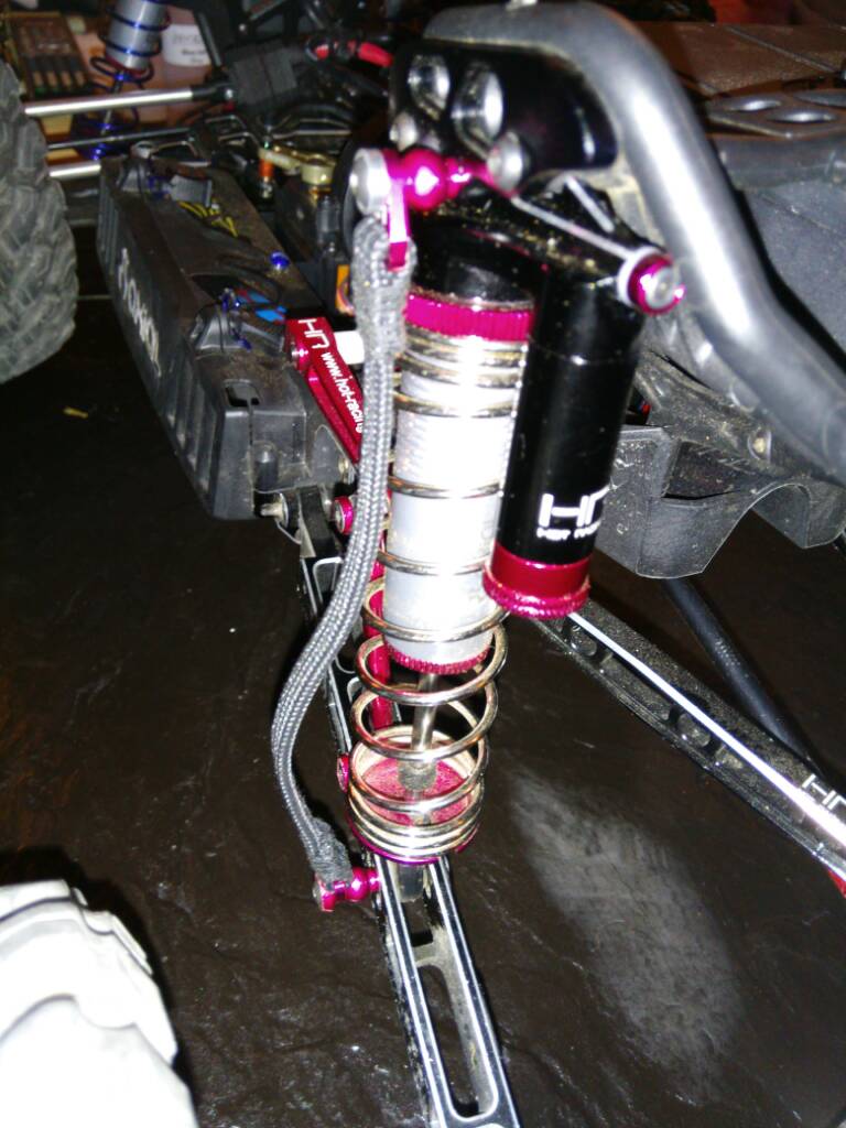

Tonight's upgrades. HR motor mount and motor mount plate. HR suspension limit straps 140mm for the rear. Castle link to adjust punch to 80% and bec voltage to 6.2. And some HR super black lube
There is a small gap. Looks if I tighten the screws it might get smaller like it should

Yup that's the gap. I haven't installed mine yet to see if tightening will close the gap but doubt it. Maybe its there to keep tension so the bolts won't back out?
I'm sure it is there to keep tension. Haven't installed it to tired. Still have to take tranny out install the mount and run the telemetry fan and on off switch threw the new mount. Maybe tomorrow after work

Greg, did you still put locktite on the 2 bolts for the clamp on the motor mount or is the tension enough to hold the bolts? Wondering if locktite is over kill on that.
How do you like the HR shock limiters? How close does the 140mm keep the rear shocks from fully extending? Are you picking up limiters for the front? Im thinking about picking some up too but wanted to hear some feedback.
