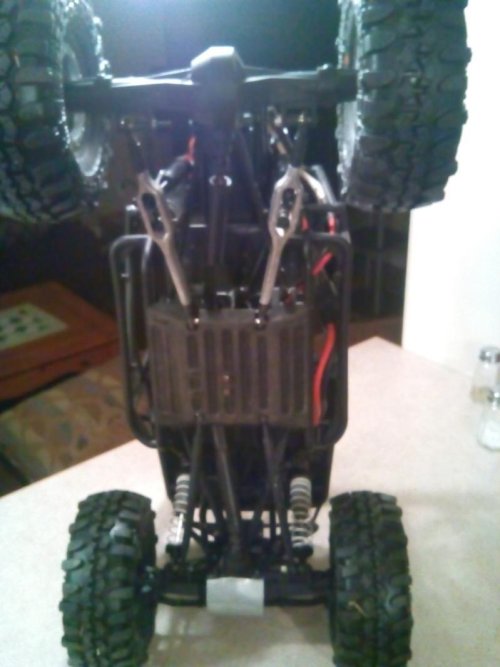

I used steel for my rear axle. It would break every time I backed out of a climb into dirt or rock. The front does fine.
Sent from my Desire HD using Tapatalk 2

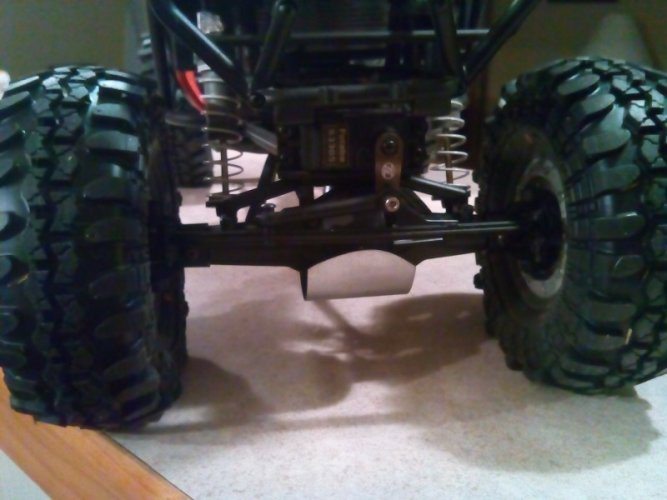

i made one out of steel as well, worked great and no issues with catching on anything..but took it off as I am gonna switch to aluminum axle housings soon

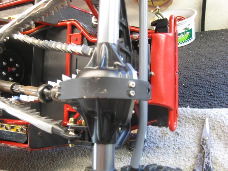

heres how i did mine !
16G steel plate,
if there enough call for them i may put them up in the vendor section
"thumbsup"
Rear
Front

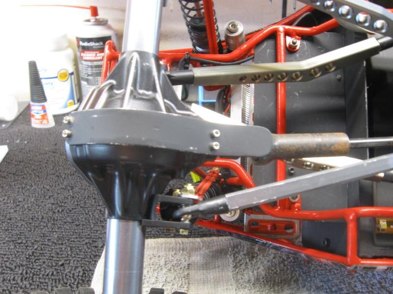

The Cure for me !!!!!
Take a heat gun or a hair dryer and set it to high
Bend & Hold the Delrin around a golf ball or something similar
Take the heat gun/Hair dryer and heat up the Delrin skid to desired shape
(Delrin will hold it's shape when cooled down)
All Done.............
Skid now has the shape of the Housing
and is easy to mount and stays in place with out spliting ;-)
The whole porpose of using Delrin is to be able
to slide over the rocks with ease
Using aluminum or steel will hang your axles up on the rocks ;-)
Hope this helps
Best Regards Rick
