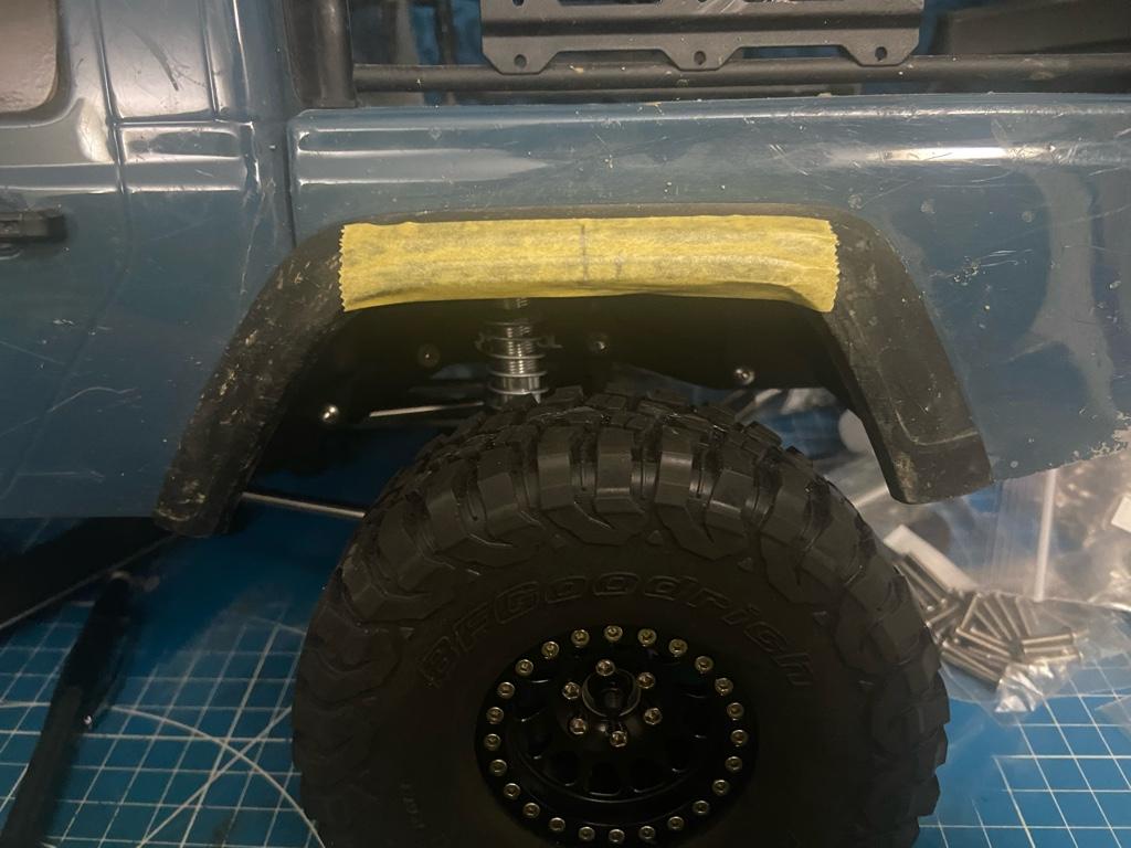

Now with the body sitting on the mounts I marked the center of the wheel wells, which is the line on the left. Then using a straight edge from the table I marked the center of the wheels. The result is I need 5mm shorter links.
Onto the front after the same process I discovered I need 10 mm longer links for the front….. I really thought I would be closer.
