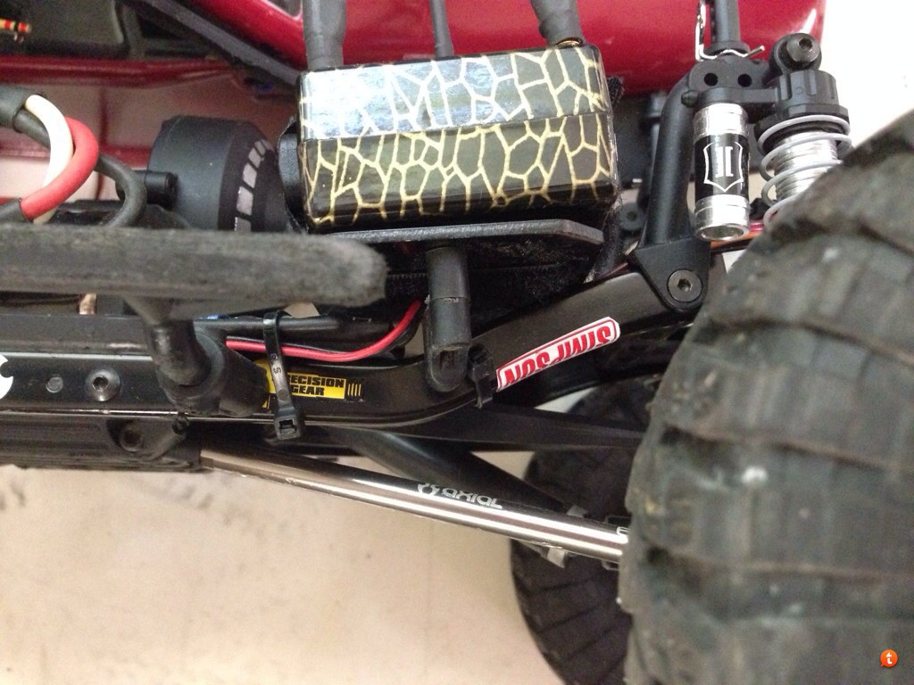

***LAY DOWN BATTERY TRAY***
Quick mod using the stock parts from the kit: it's the lay down battery tray... All you need are two servo mounts , two counter sunk screws and two spacers. Use the stock holes for the receiver box move the box to the rear and flip the skid plate around to run your motor to the rear. This is the result.
