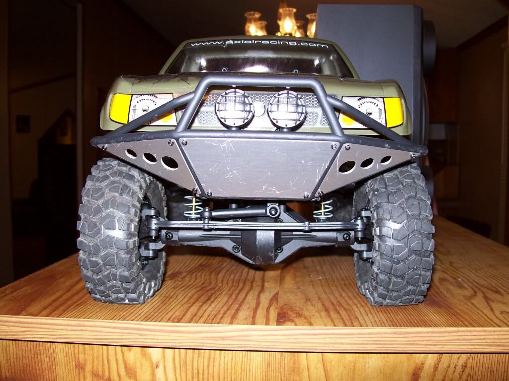

ok here goes my first write up!!!Well on my honcho the bumper stuck out and was to low for my liking..the goal here was to get it alittle higher and back some for better approach angles..so on to the pics
ok once you have the bumper removed you will see the crossmember that holds the bumper.remove the crossmember and then set it on top of the frame,as shown in the pic.now is the time to take your measurments or like me make a pattern with the holes in it for quick tranfer over to your bracket material.
you will notice that the frame has holes already in it for the factory crossmember location.you will use these to screw your bracket into.the top back holes i drilled out once both sides were screwed together.just make sure you cut the small (nipples) lol off of the factory crossmember to make it smooth for your bracket.
this little bit of moving changes the approach angle enough to have fun not worring about hitting the rocks with the bumper way before the tires get close
with the bumper mounted you can see the bumper ends are way above the tires
a get campbell soup can worth of clearance with this mod..
this is the finished project..it pulls the bumper in and up and for crawling this will help...
well guys this is my tip hope it helps someone else.i realized i needed to take more pics but next time i will improve..thanks and enjoy
