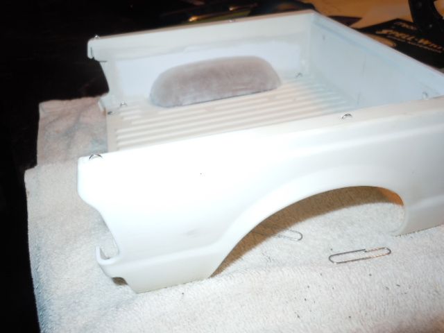

Here is a little idea to have retractable tie down hooks on your truck bed. Start with #1 paper clips. Cut off the desired end to make what ever size hook you would like. I choose the smaller end. Cut the paper clip and next drill holes in your bedside slightly larger then the wire size of the paperclip. Use the paperclip to get your holes drilled. Insert cut clip. Set to the desired height you would like to have it when in use and bend the ends under the truck. Now you have hooks the retract when not in use and can be extended when you need them.
Extended
