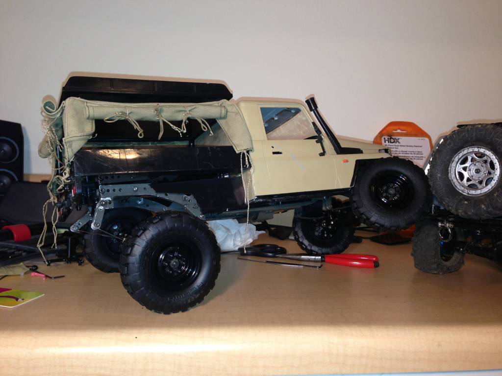

I was surfing the classified one day and came accross a 70 Series Land Cruiser on a Trail Finder chassis. I instantly fell in love and bought it.
A few specs on it:
Body: Steve Irwin, The Crocodile Hunter's Pick-up. This Was Produced by Discovery Comunications in 2001. The Truck is 18" Long and 7-1/2" Tall. They are no longer being made, so incredibly rare hard body.
Chassis: Is a custom TF1 chassis extended about 1.5" at the center skid
Transmission: 16:1 RC4WD red planetary
Transfer case: I think is a GCM. not positive on the brand, but it's a 1:1
Axles: T60 ARB Edition F/R
Leafs: soft reds with helpers leafs in the rear, and highlift leafs in the front
Wheels: 1.9 G-made VR01 black (brand new)
Tires: 1.9 Military tires

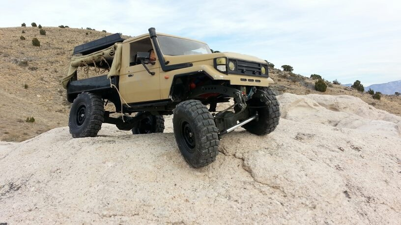

Something similar to this: (although not as aggressive)

Those pictures of the rear cage look awfully familiar. "thumbsup"
It's funny. That truck is part of the reason why I bought the three 70 series bodies I have. Glad to see it is still loved.
If you need a replacement "tray" you can have mine for the cost of shipping. It's not cut up at all. I took it off at the beginning of the build and won't be using it again.

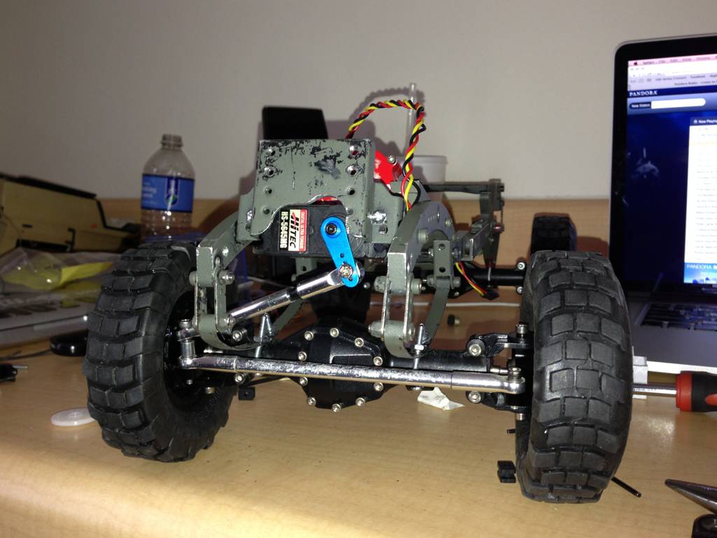

Servo mounted, electronics plate mocks up (plastic now, aluminum later). I just have to find a motor with a smaller collar, the stock axial 27T won't fit inside the trans mount, I may have to bore it out with a press, I can't seem to find a brushed motor that will fit.

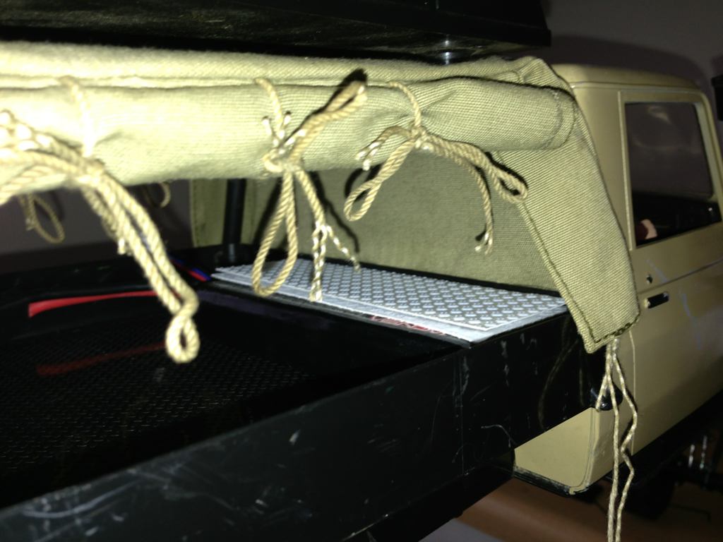

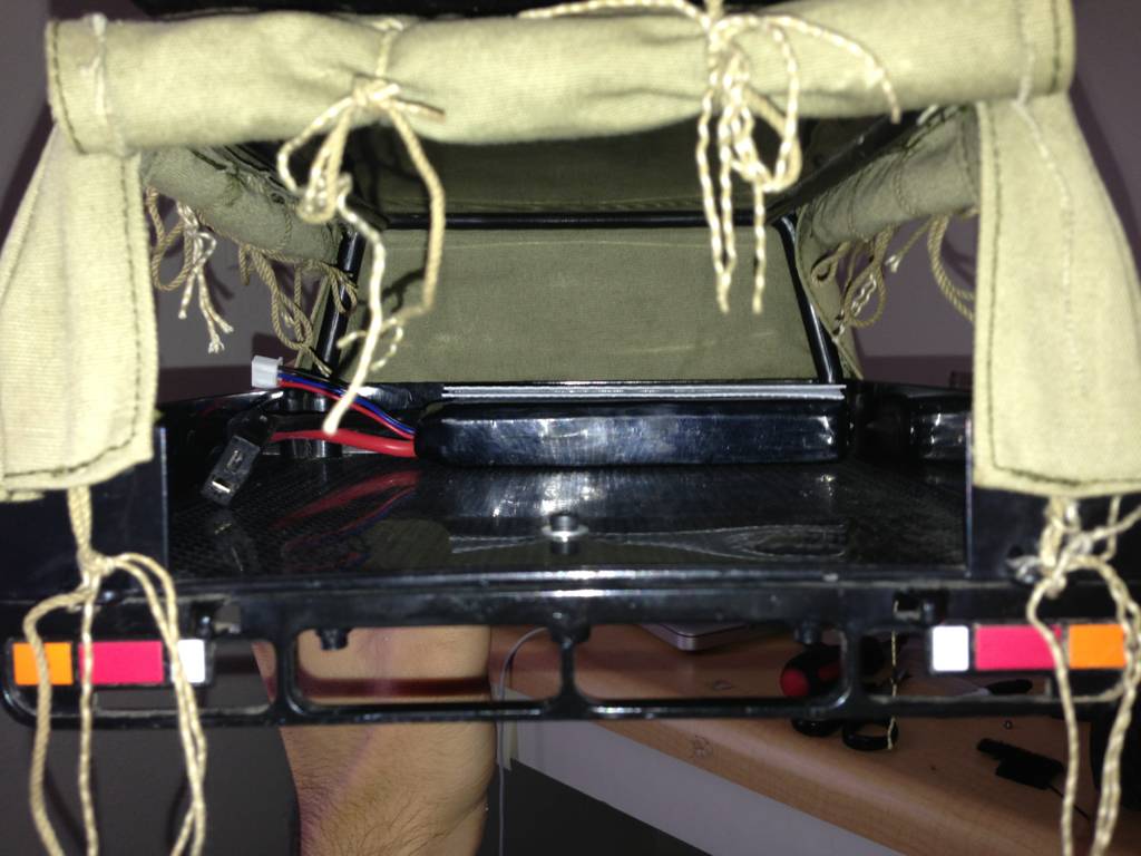

Now for the battery, I have two 5400MaH 2S that I used in the SCX-10 when I was running the AE-2. I had plenty of room for the batteries under the body. This however barely has enough for the ESC/RX. So the battery is going in the bed, with a "utility box" as a housing. I like it mounted on the side of the bed, but it throws the balance off. So this is what I'm thinking:
I used my home brew sand ladder as a top plate to see how it will look.

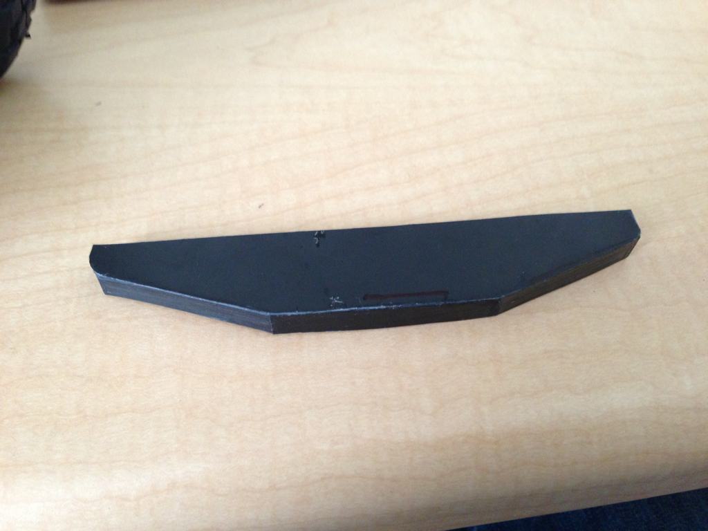

I then started a template of the front bumper. It hangs out a bit much, so I think I'll chop 1/2" off and see.
