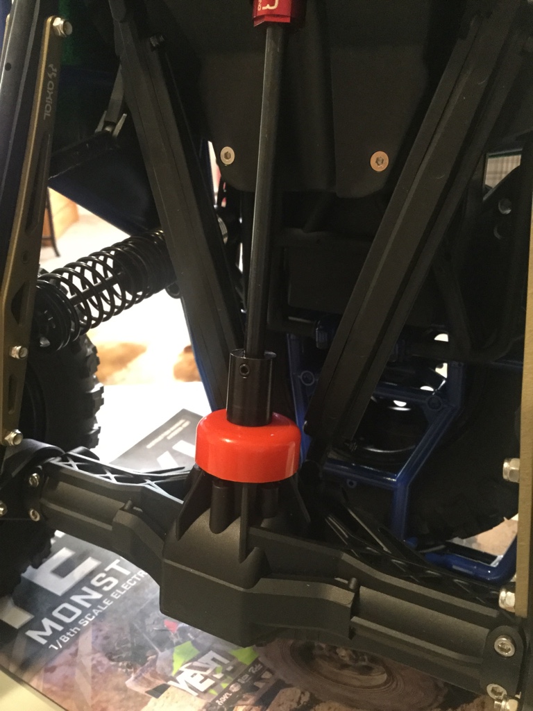

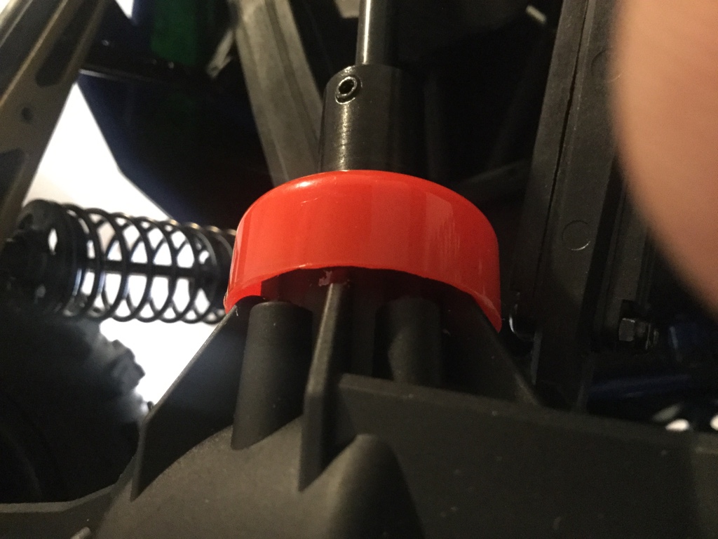

Nice job Brinkman BUT keep in mind this is NOT a fix all. I pull the rear pinion after every bash session or 4 packs (only have 8 3S now) and the pinion bearings are still dirty but not failing. Since the mod and pulling pinion every 4 packs all is good.
Does that orange cap just ride tightly on the HD DS without glue etc.? How is it secured? Any reason why you didn't try the HPI rubber boot?
