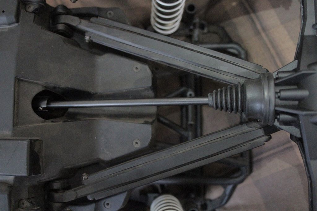

Both CMT and RTR used to have HR DS but only the CMT have the clear boots on since its heavier, I was gonna install one for the RTR as soon as I was done testing it out to see if its a plausible solution, 2 weeks later I destroyed the RTR's rear axle housing. Blessing in disguise actually I've been wanting to see if the front center DS would fit there, it did, if this works out I might/will be replacing the HR DS on the CMT too..
If you look at the pic below that's the RTR with the YXL front center DS installed with the 22 mm HPI boot covering it.

Just so I'm clear.... your rear drive shaft on your RTR is the center shaft from an RTR. I thought about doing that but I figured the length would be off and it would bind or just fall out. I was too lazy to actually check (taking the front apart is a beating).
Just so I'm clear.... your rear drive shaft on your RTR is the center shaft from an RTR. I thought about doing that but I figured the length would be off and it would bind or just fall out. .
I thought so too, when I put it on I was sure it was a little short but, unless you put longer shocks then it will definitely fall off, no issues so far on jumps, mud and water but its only been used for 10 hours. YXL DS has fewer parts/joints to break, cheaper to replace and if either one break you'll have to buy the whole part anyways, no one sells replacement parts for the one you broke, my only concern is the 5.5 mm shaft 1 mm thinner than the HR.
You could try fitting a bearing on the driveshaft and zip tie a boot to it and the other end to the housing it ought to work until that bearing needs replacing. This will allow the boot to stay stationary while the axle spins.
That HPI boot would work on a stock axle if you trimmed the thinner parts off. Could also look into some shock boots or even a balloon for that matter.
