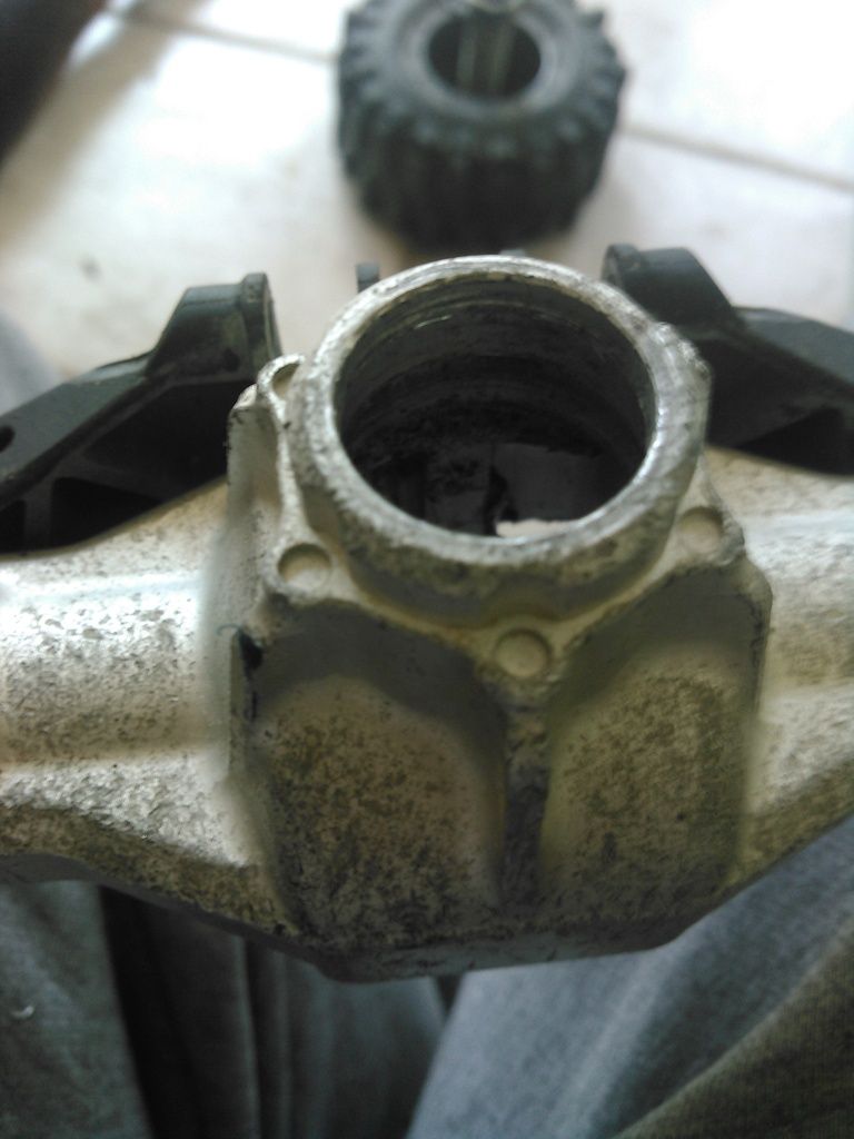

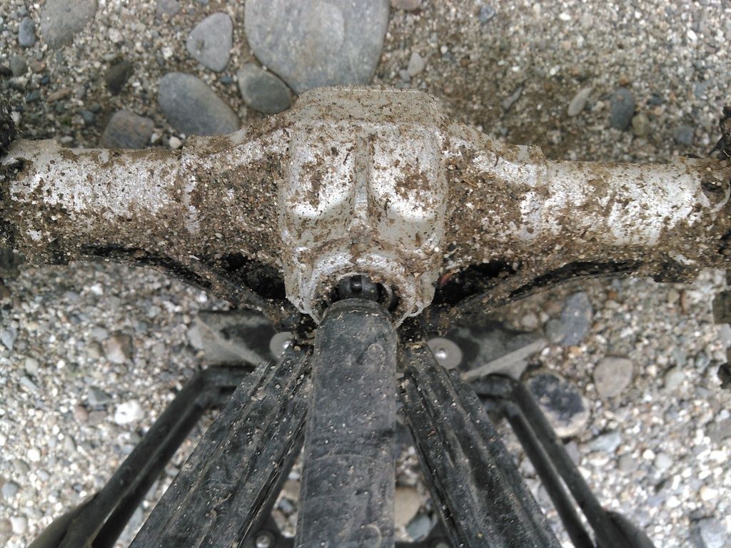

This is the issue that we are facing with the outer housing bearing .. The housing scoops dirt into the pinion cement mixer..
This is after on 4s pit run..
This is why I DON'T use grease.. Look how clean and dry it is ..
adding grease turns the dirt into a bearing killing compound..
I also think rock binding is causing the WB failures..
And knowing that my outer bearing is inevitable to failure I run the Third bearing as well for backup "thumbsup"
YES THE XL NEEDS A BOOT
