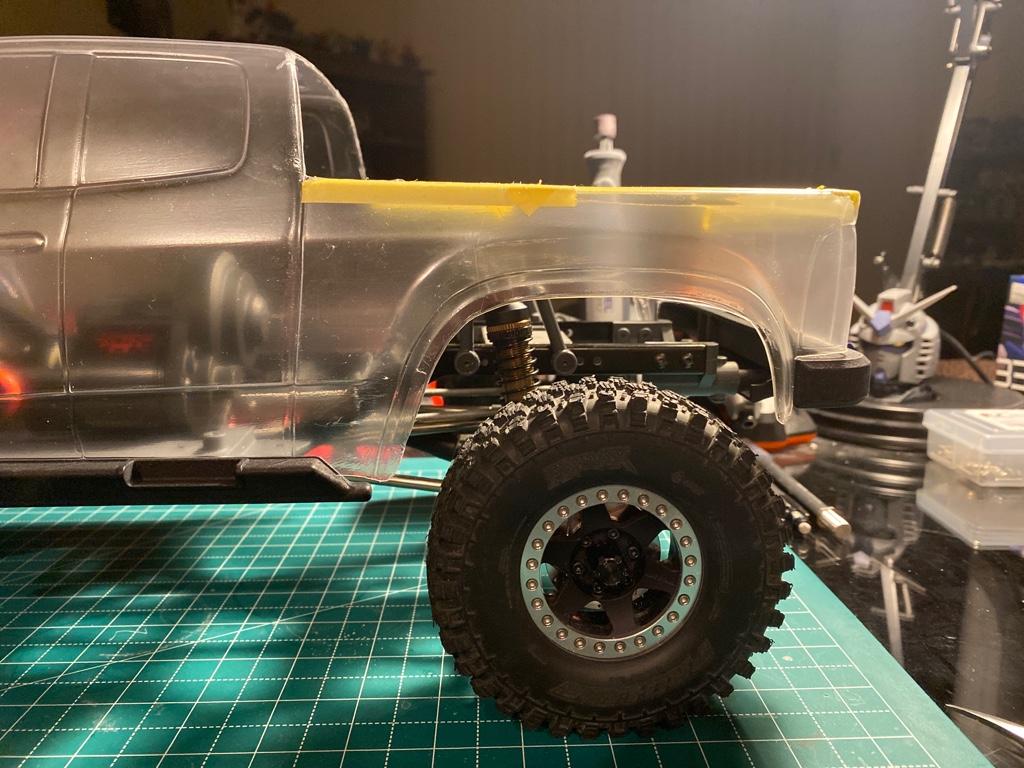

I got started on the prototype today. I am building the walls out of .04”(1mm) polystyrene and some bones out of .188”(5mm) square bar. Here is what the bottom of the bed looks like after a few hours of work:
Bottom Side
Top Side
I haven’t started to detail it out yet though. The lower bones are slightly wider than the frame to make room for the frame rails. Here is what it looks like in the truck right now:
Depth of the bed is now at 2” roughly.
The upper angle looks a bit strange, but it should be off the cab by .4” to make a nice rail.
I’ll be working on the firewall tomorrow, and the sidewalls during the week.

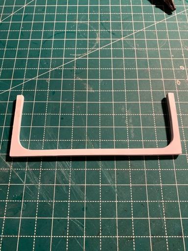

I started off the day by getting design done via pencil and paper. I came up with a “skeleton” structure for the bed. It actually changed a bit through our the day.
Here is one of the “bones” and the general shape of the bed:
Colorado’s have the U-Shape bed, so normal box is out of the picture. I am planning on going to boat building route for the basic shape.
Here is a preview:
I am going to be making 3 more U-Shape “bones” and some connecting braces tomorrow. Then I’ll add the floor and braces.
