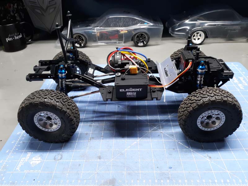

Ha! Totally missed those plates... they would make all the difference. They are not mentioned or shown in Step 11, they are there in Step 12 though. I didn't even see them. I saw them when I was done the build and wondered what they were.
Oh well, I got there with the longer rod ends. :)
Yeah, you can easily miss the shock tower extensions, also in the manual it specifies putting the rear shock at the same level as the lower link, includs longer screws and spacers with the kit.
Made myself a new battery tray... one specific for my 2200 packs. Ground down the mount until everything was flush and drilled a new hole. I'll eventually paint it black once the temps warm up.
It's as low on the chassis as I could get it - about 2mm above the front driveshaft.

So I really pooched up this build by not looking at the last step too closely, and spent a ton of time I probably didn't need to spend.... but then I had a fit of genius and made up for it. Upgraded hard battery tray mount up front left me with the stock part in the parts pile...realized the holes in back matched perfectly so I installed it out back. Boom! seriously stiffer chassis... It was kind of open and airy back there. Much better!
Got all the electronics mounted...and sorted out. WP1080, Holmes Crawlmaster 16t and a 25kg servo. Plus a lot of ugly wiring... :) Just zip tied it and called it good for now.
