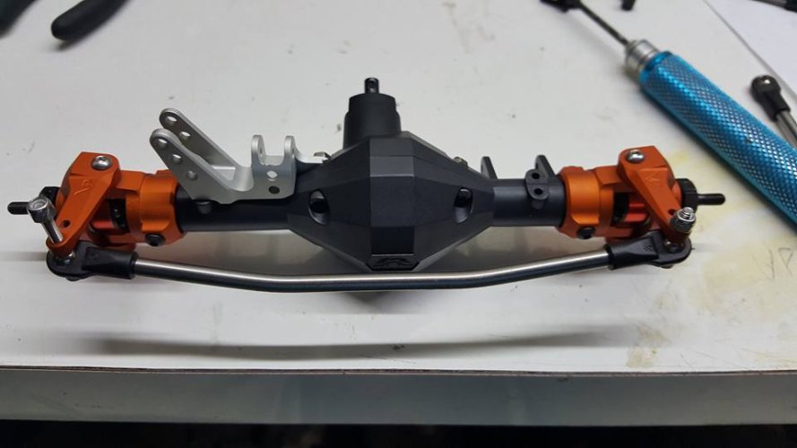

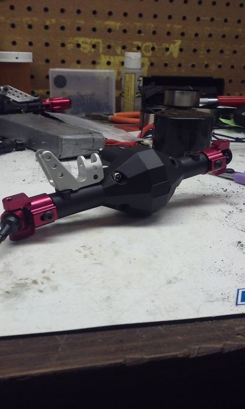

Is there a possible 3 link truss in the works? I like my chassis mounted steering. :mrgreen:
Could probably use a rear truss on the front and just use one side of it. Have to figure out a panhard mount though.
Could mount it on top where the steering knuckle screw goes.Could probably use a rear truss on the front and just use one side of it. Have to figure out a panhard mount though.
Looks like the Locked-Up panhard bracket could work but by all accounts the 3 link mount won't, those through housing screws are apparently located different on these housings.
SCX10 Pro CMS Zero Ackermann
Not sure that would sit right. Two holes are being used by the truss so you'd have to have a spacer to make it sit level. Could be done, but not a direct bolt on.
I'm thinking something that uses the two holes for truss and and one of the holes on the truss brace to keep is stable.

From the pics appearing on FB it seems at least the VP panhard/3 link bracket works with a little trimming to clear the diamond of the pumpkin.
