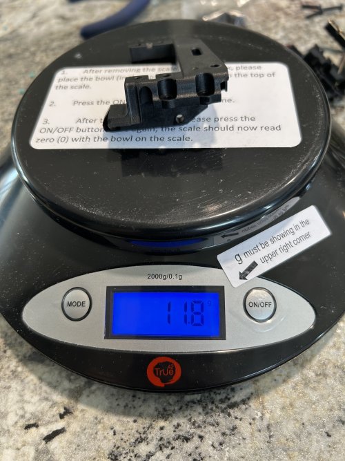

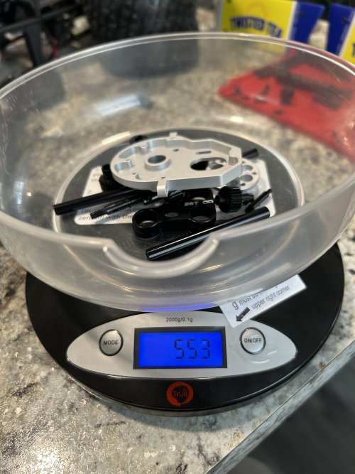

First up, weight of stock mount 11.8G
Meus brass servo mount 57.5G

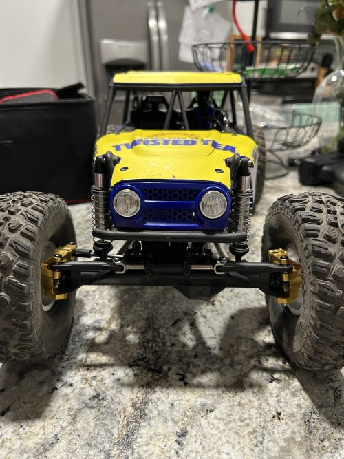

Fit was perfect, one of the threaded holes for the passenger upper link was a little tight, so I just went slow in and out. Didn’t feel necessary to pull out the tap kit to clean the threads.
And I found my scale hardware tool to add some scale to the knuckles.
Got the same mount, just no brand.
Helped add a touch of weight to the front but overall the truck is pretty even on weight front and back. I think I’m gonna get the meus knuckles just to add more weight to the front. Keep the front end planted better.

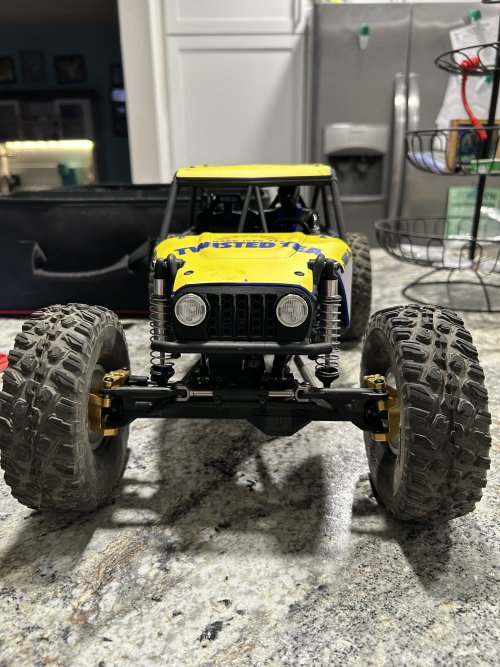

For anyone who is thinking about grabbing the meus brass knuckles, they are HEAVY. So heavy they are being returned tomorrow. I wanted some weight, don’t get me wrong, but they are ALOT of weight. Not wanting to snap the ears off the axle c hubs every other run.

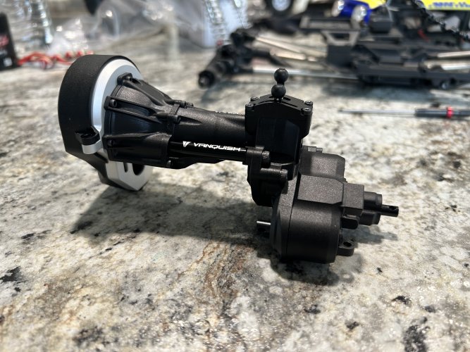

Decided to return those and the gold axle. I’m gonna keep the axle housings plastic, but use treal 3rd members and bearing holders to add the little bit of weight I wanted f&r. Since I also missed the vanquish knuckle drop, I just grabbed the treal aluminum ones.

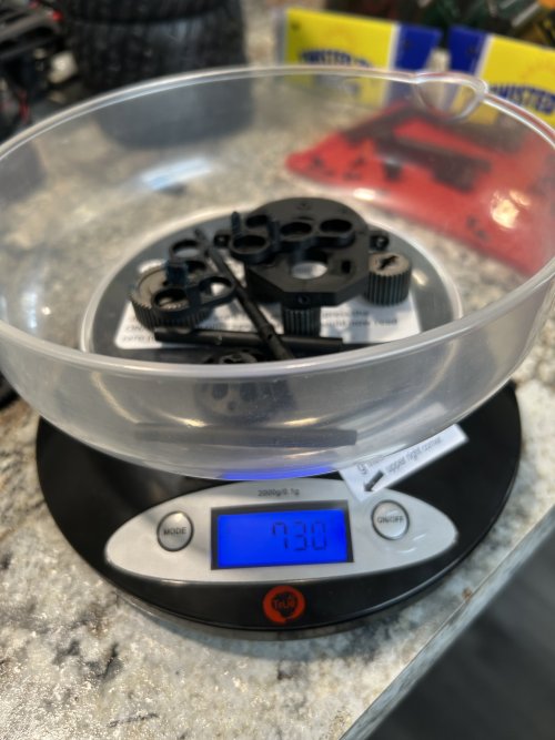

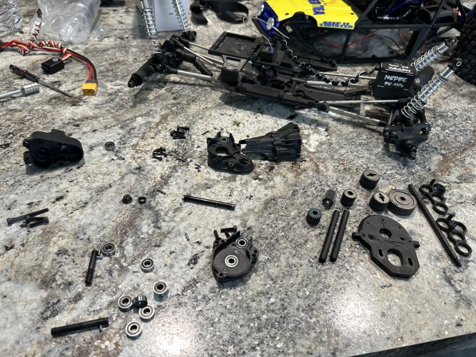

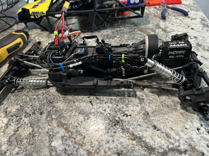

New system for the rig and a new grille. I’d love to put the stuff on now, but that’s counterproductive. I have to break down the transmission again once the gears show up, hopefully tomorrow.

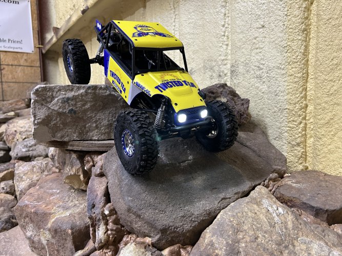

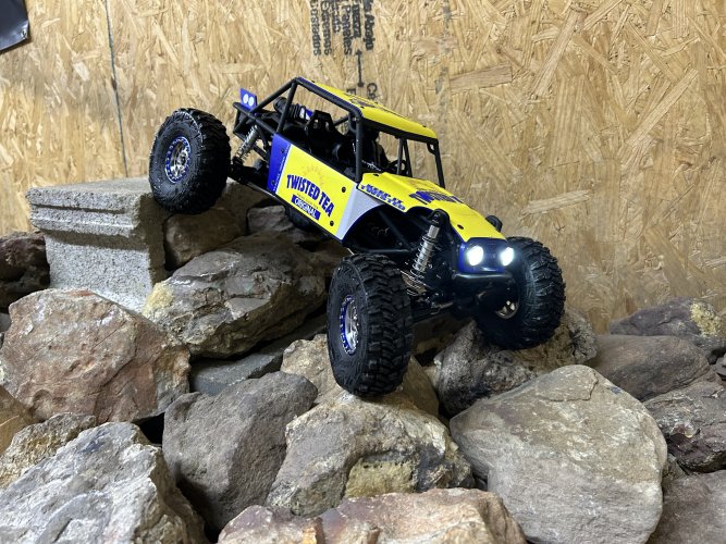

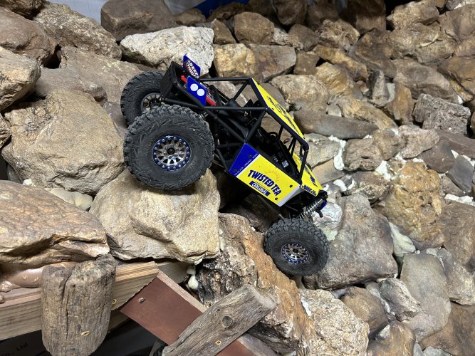

Finally got it out on the rocks. Performed way better than I expected. After seeing the new changes to the course, there were some new technical lines and the optic just ate them up. Have to adjust my personal driving style with a portal rig vs the optic but all in all it’s a good crawler.
Definitely drags belly a lot, but it does glide over rocks without hesitation.
I do think a slightly taller tire would help clear more rocks. So I’ll probably look and see what I can get. These tires are also brand new never ran so they were slick. They did grab when it was needed and hearing the lugs chirp and grab is very satisfying.
Spent quite a while just running it around on the rocks to get a feel of it. Off camber, steep climbs it really shines. It takes a very steep uphill climb or a protruding rock to make it want to flip backwards, which is a pleasant surprise. Thought it would spend a lot of time turtled.

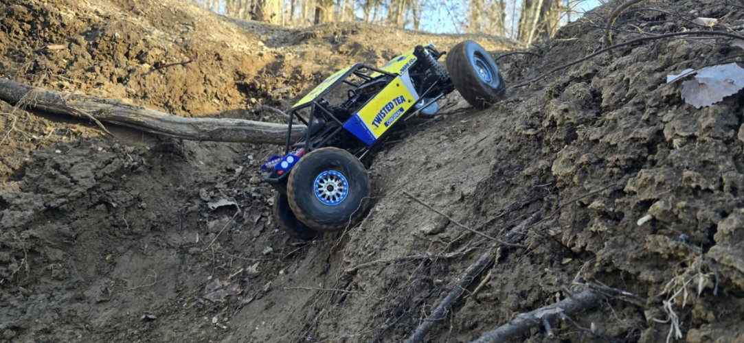

Favorite pic of the day, it really is as steep as the pic looks and it went right down it without issue. The weight front and rear on this is pretty good.

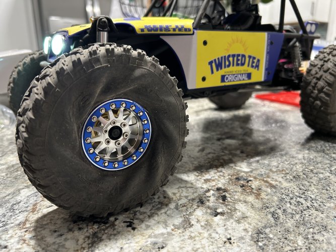

Swapped the blue ring treal beadlocks to the vanquish vxt2 tires. These tires actually measure 5” tall while the other Goodyear mtrs measured right at 4 3/4”. Had these tires on the other optic and was already surprised how sticky they were right out of the package. Now, we’ll see how they do!
