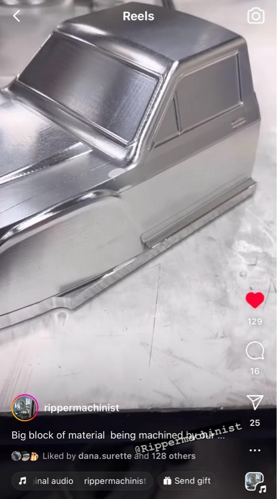

Not sure if this is what I think it is, but rippermachinist (VP James) just posted a new vid on the Gram.
I wonder if it is a sneak peak of the new Stance body that is listed in the VRD Carbon manual as an option part!?!?!;-)
Well, damn! I was going to post a screenshot of it, but now RCC is telling me that my picture upload "quota" is full. And I see that I have lost my GOLD STAR! What the hell!!!!!!!!!!!
I'll try to use Tapatalk to see if I can post the pics.
Here are the screenshot pics. Looks like I’ll have to use Tapatalk to post pics from now on![emoji2959]
It looks very similar to the Blue Body on the new redcat to me.
It also look very similar to the Cliffhanger.
Well, the Tuesday Live DID reveal the new Stance body. It does look good IMO! Much more pinched in the front than the big block of aluminum paper weight that rippermachinist carved out!

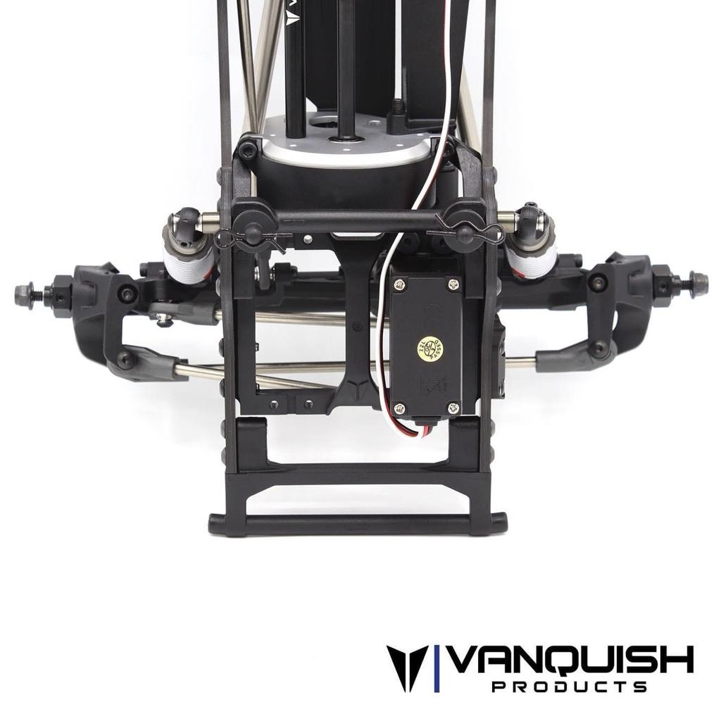

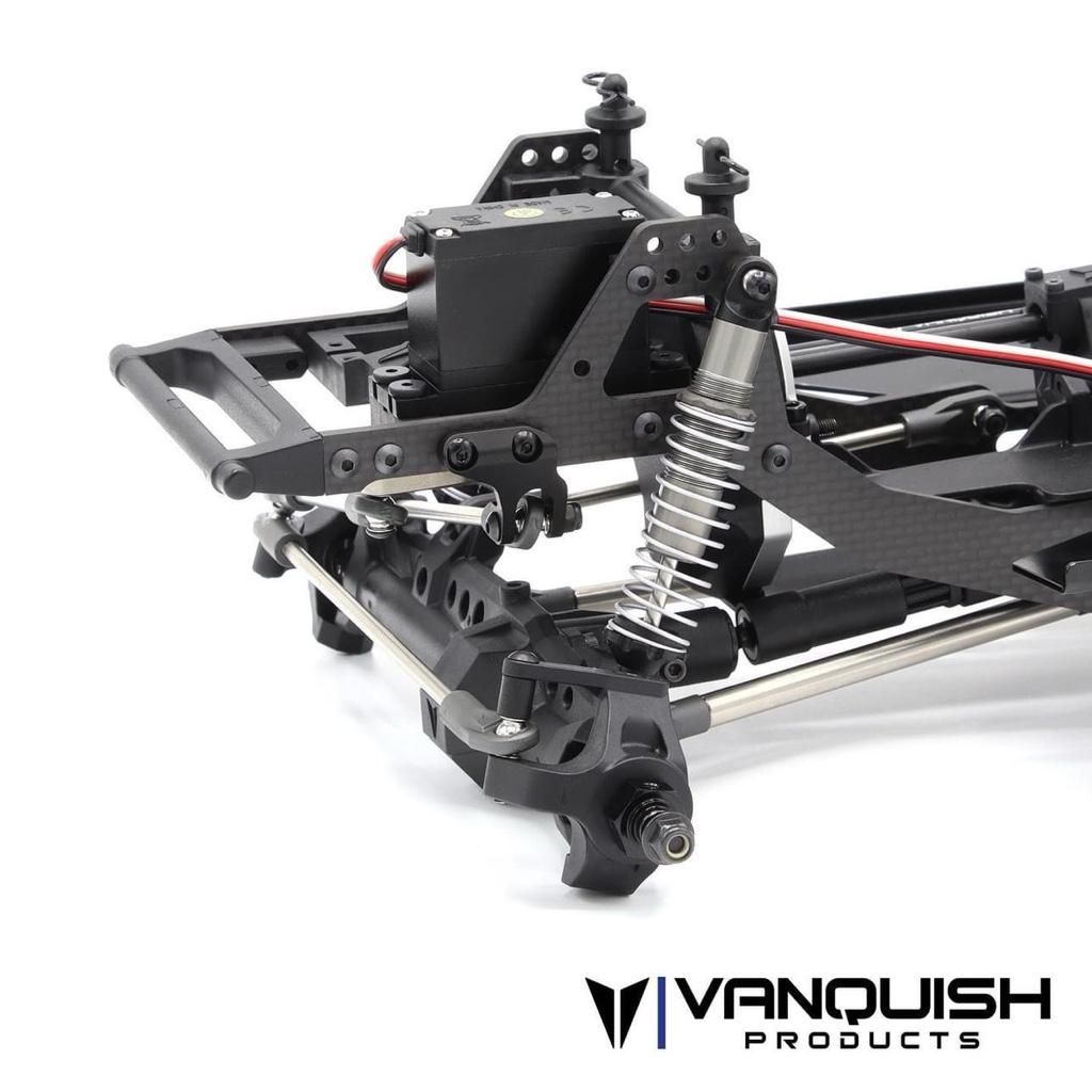

Here’s few pics of the new items for the VRD.
VPs new body looks great and with nice clearances, slammed should look great on the VRD you got. The bedsides detail look great, a bit too pinched in the front but it should allow for the most steering angle. I have a couple out-runners and while they have very good creep and low end they need to be paired with the right esc or else you will be reaching for some intergalactic comunication. :ror:
